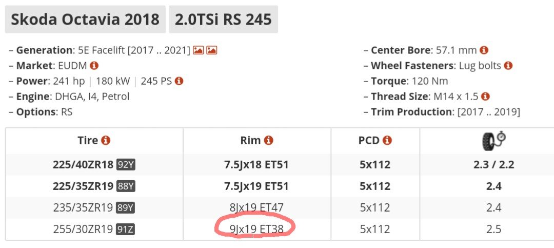

The funny thing is that Wheel-size.com describes 9x19 ET 38 to fit 255/30R19 tyres. So how that works with respect to tucking the rubber under the wheel arches, well that is a mystery to me....

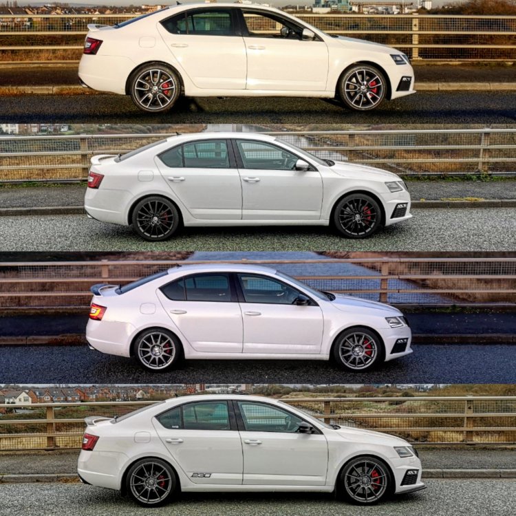

Cheers I went and bought them (18 x 8j et 42 speedline 2120 turini) and they were perfect.
I sold them on though as 18s just looked too small! Now on 19 x 8j et48 Autec Wizards.

A bit surprizing that you sold the perfect wheels, but I didn't see them on.... Pictures?
I am not a fan of big diameter rims and tiny rubber heights, in my mind 225/40-18 is a better choice than 225/35-19. I know it's a little old fashion, but this is a personal preference from my driving style, comfort and road condition. Now I am on a different car, having 19", but the rubber is 225/45, so the rubber height is in the "tiny range", but acceptable. Winter wheels are 215/55-17 on 8" rims.
I wanted 18s for comfort, cheaper tyres etc. They just looked too small on the mk3. Best 18s are the oem gemini or turini.

I've now gone 19 x 8.5j et 45 and I'd say that's as much poke as you can get on a FL with the rear being a wider track as standard than the PFL
