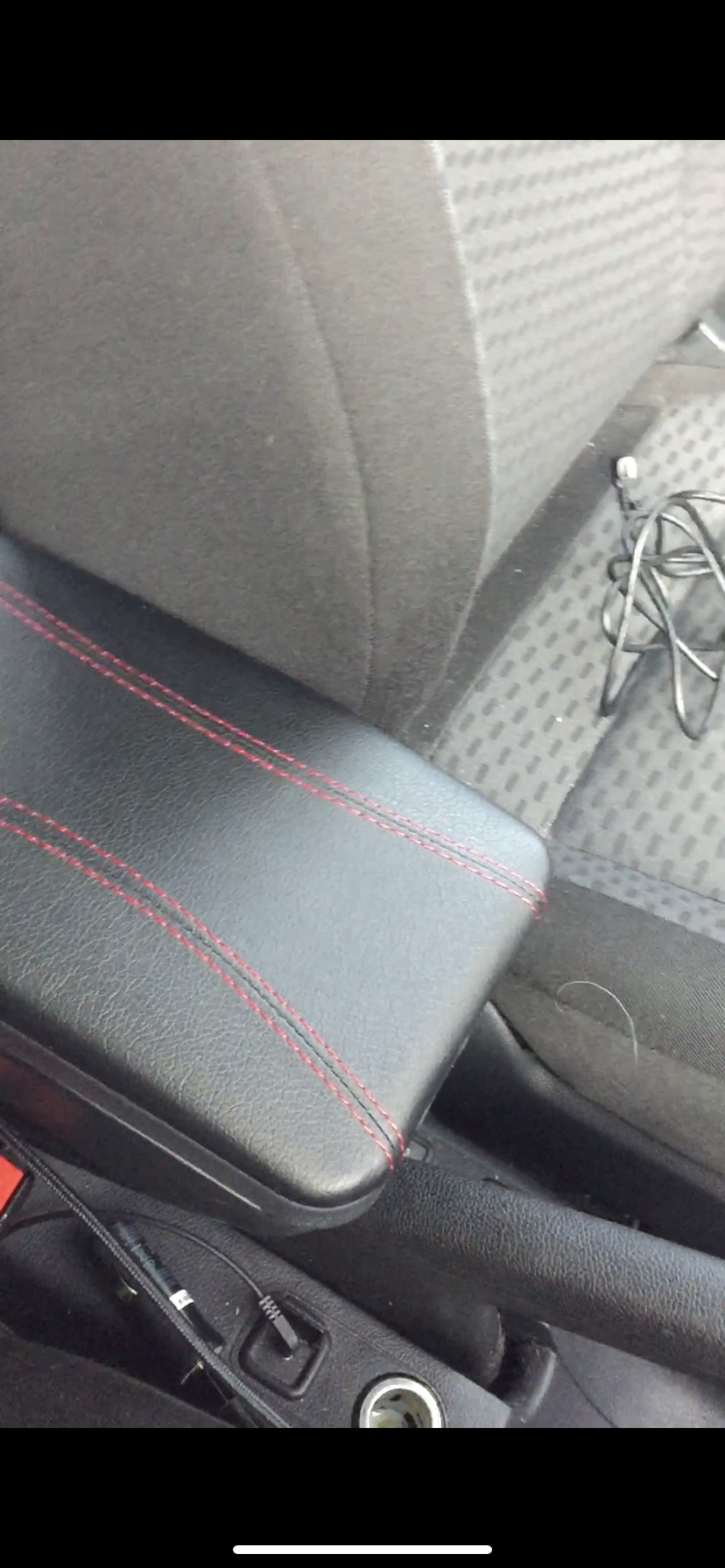

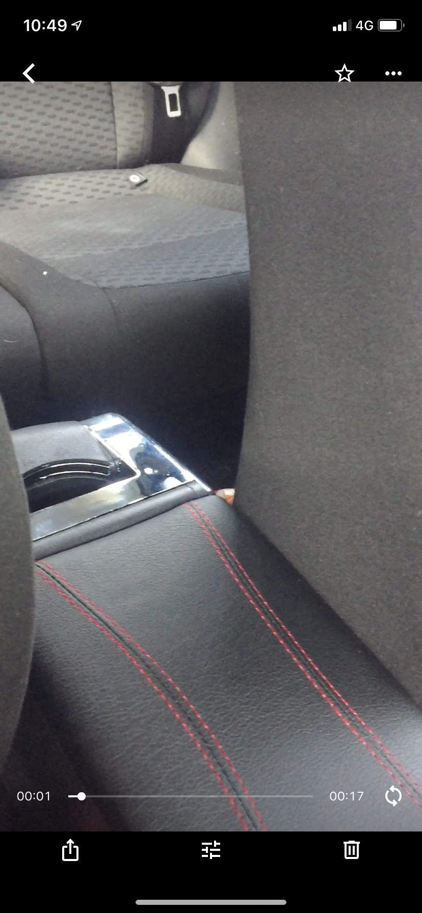

I think some of the most satisfying mods are the smallest ones, and the little things can really change the feeling of your car. One of the things on higher spec cars was the armrest, and while I was considering retrofitting the factory one, I found lots of people on the forum saying that they were getting rid of theirs because of the inconvenience.
I found this one for £40 on amazon, and I have been very happy with it, despite the fact that the instructions weren’t great.
Its got a leatherette lid which is padded, and under the lid there is a large felt lined storage pocket. Behind the lid there is a ash tray thing, and the ash tray can be pulled out and extended to make a cup holder. Also, the lid can slide forwards for reach ability, and then rotated towards the driver. The whole unit has rails so it can be moved forwards, but then it can get in the way of the handbrake. It was pretty easy to fit, as essentially you slot the base into the plastic tray and cup holder, and screw it all together. One thing I didn’t like is that the bit that wedges into the cupholder was too small, so it would dislodge with acceleration, but I put a strip of really thick double sided gorilla tape around it which wedged it. Also, the seatbelt buckles would rattle against it, so I stuck double sided gorilla tape on those but didn’t take off the protective covering on the outwards facing side so that the seatbelts didn’t stick to it.Rotatable Armrest For Fabia 2... https://www.amazon.co.uk/dp/B07GQZXGMR?ref=ppx_pop_mob_ap_share
