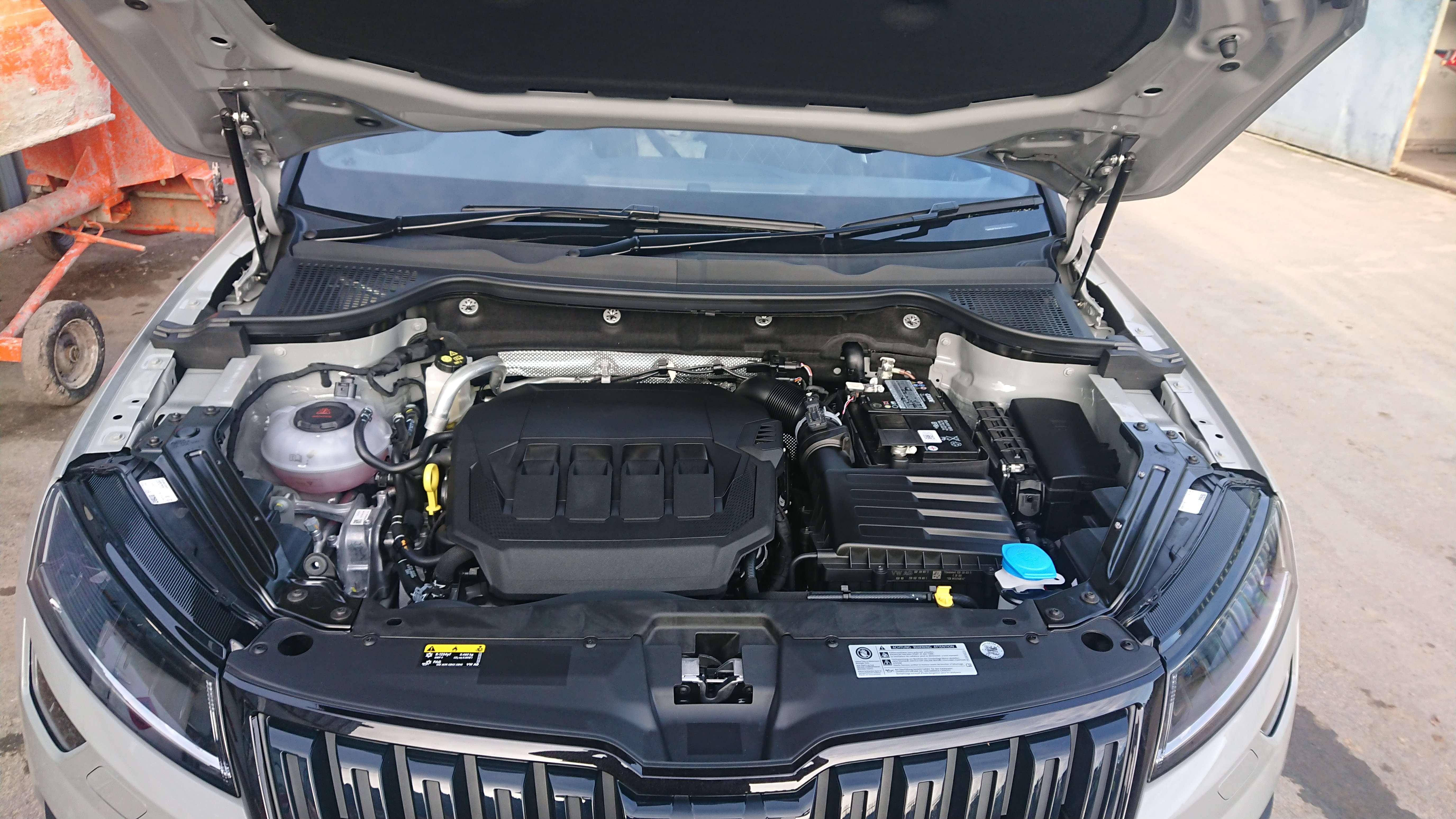

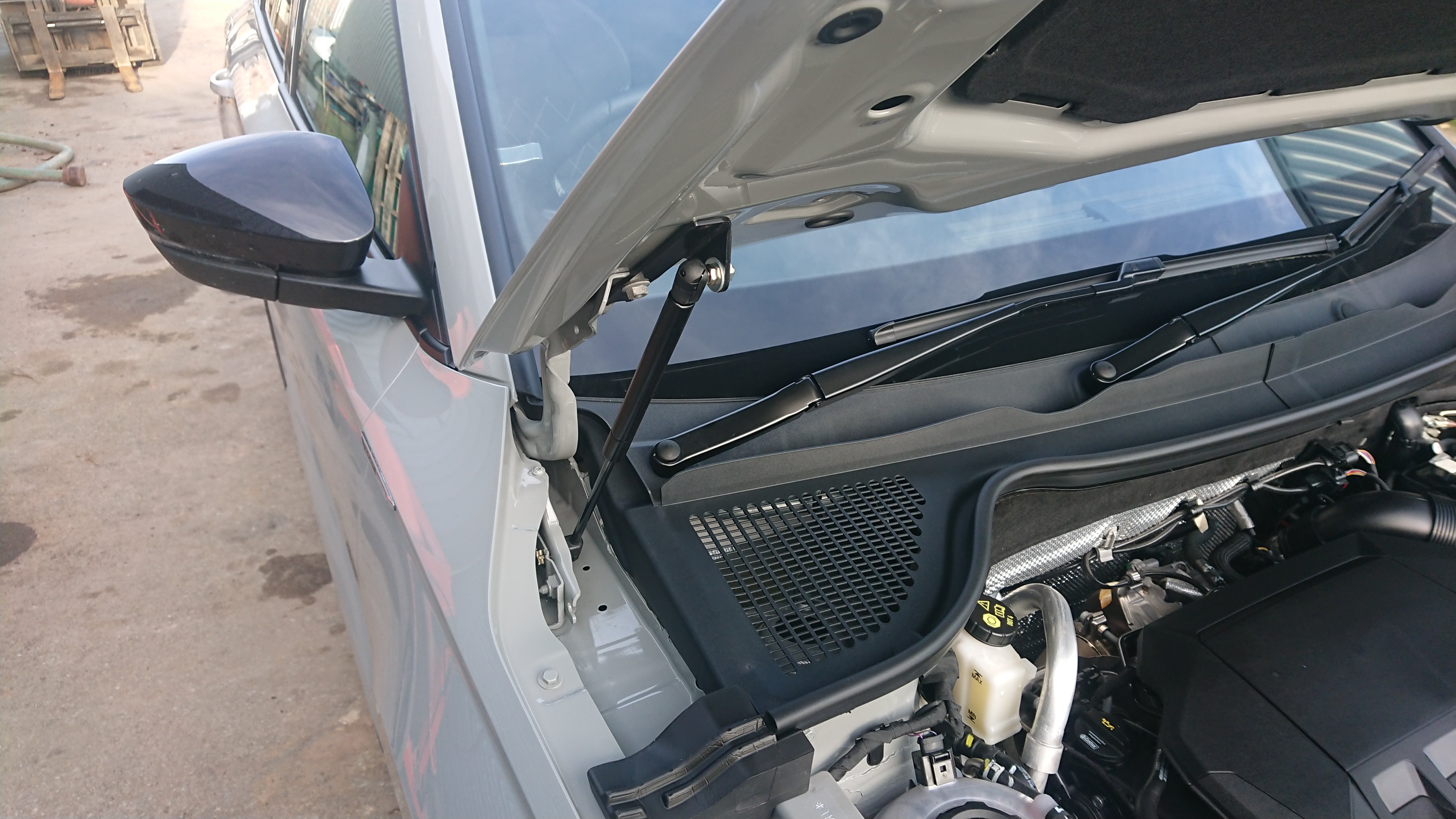

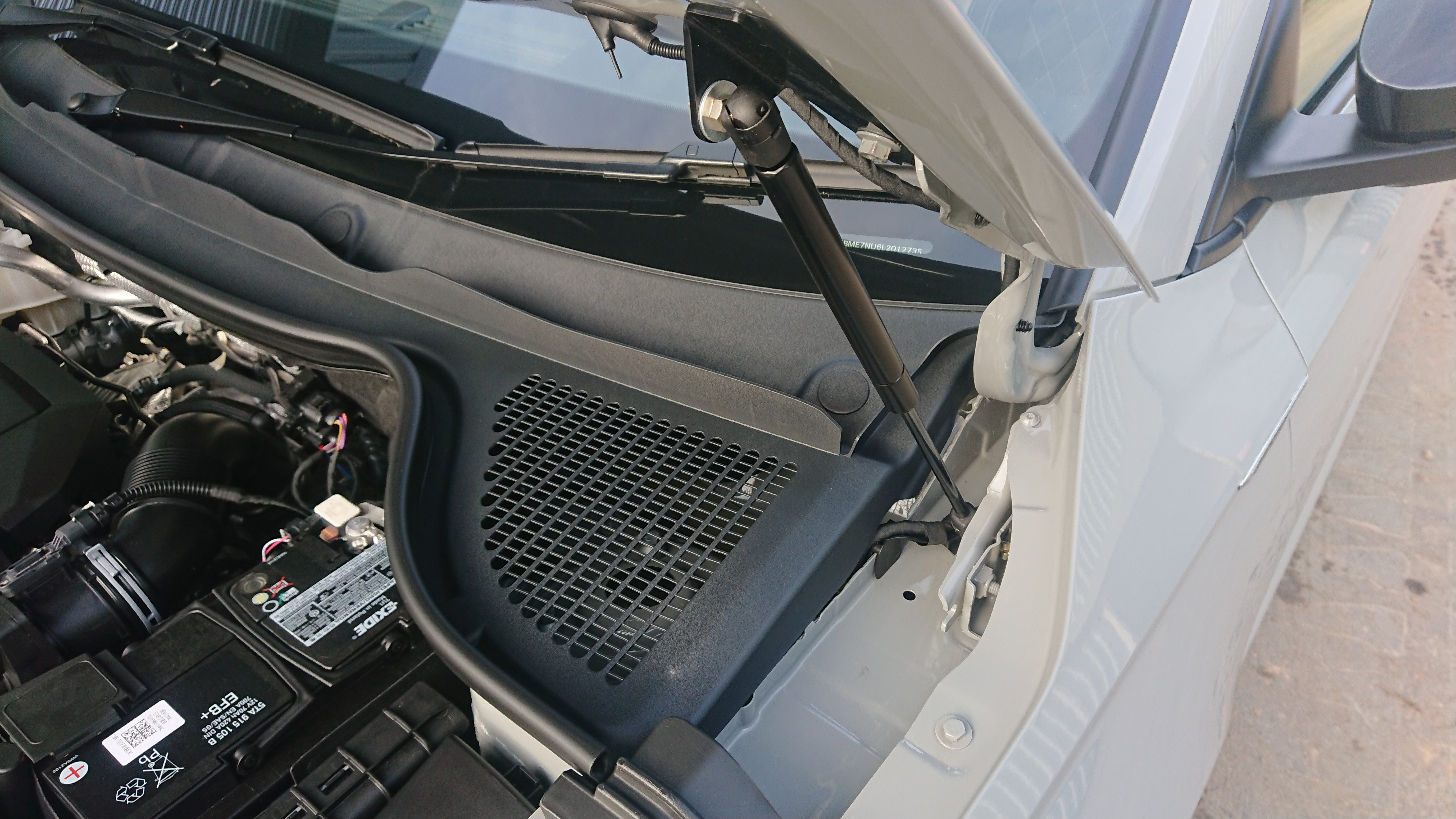

i've fitted some to my sportline you may need to mod the brackets to get them to fit nicely
@Rsrob, have you drilled the wing or bonet?
No the hole are there or ready
