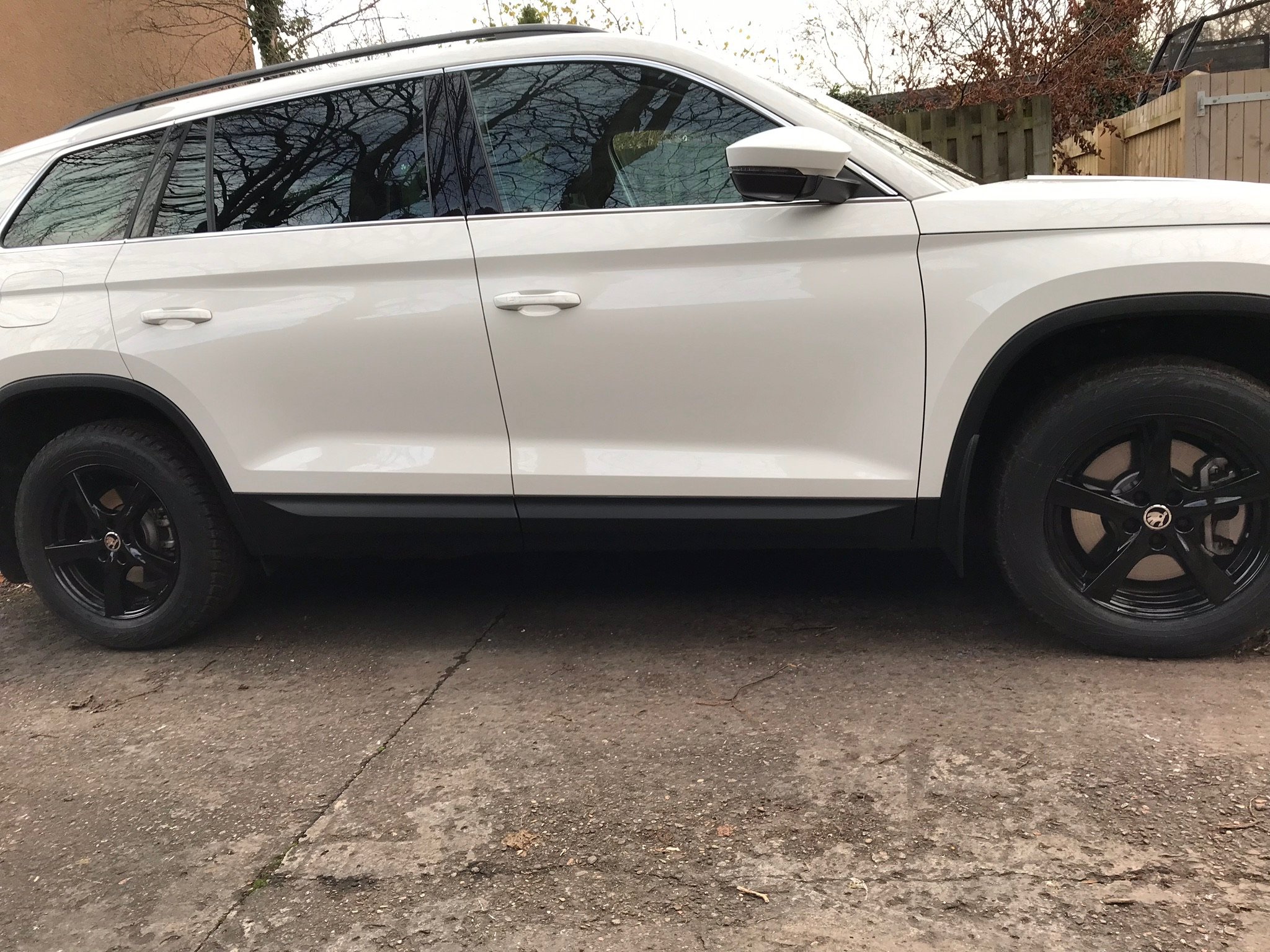

Any Kodiaq driver with 18" Black alloys fitted I would appreciate any photos.

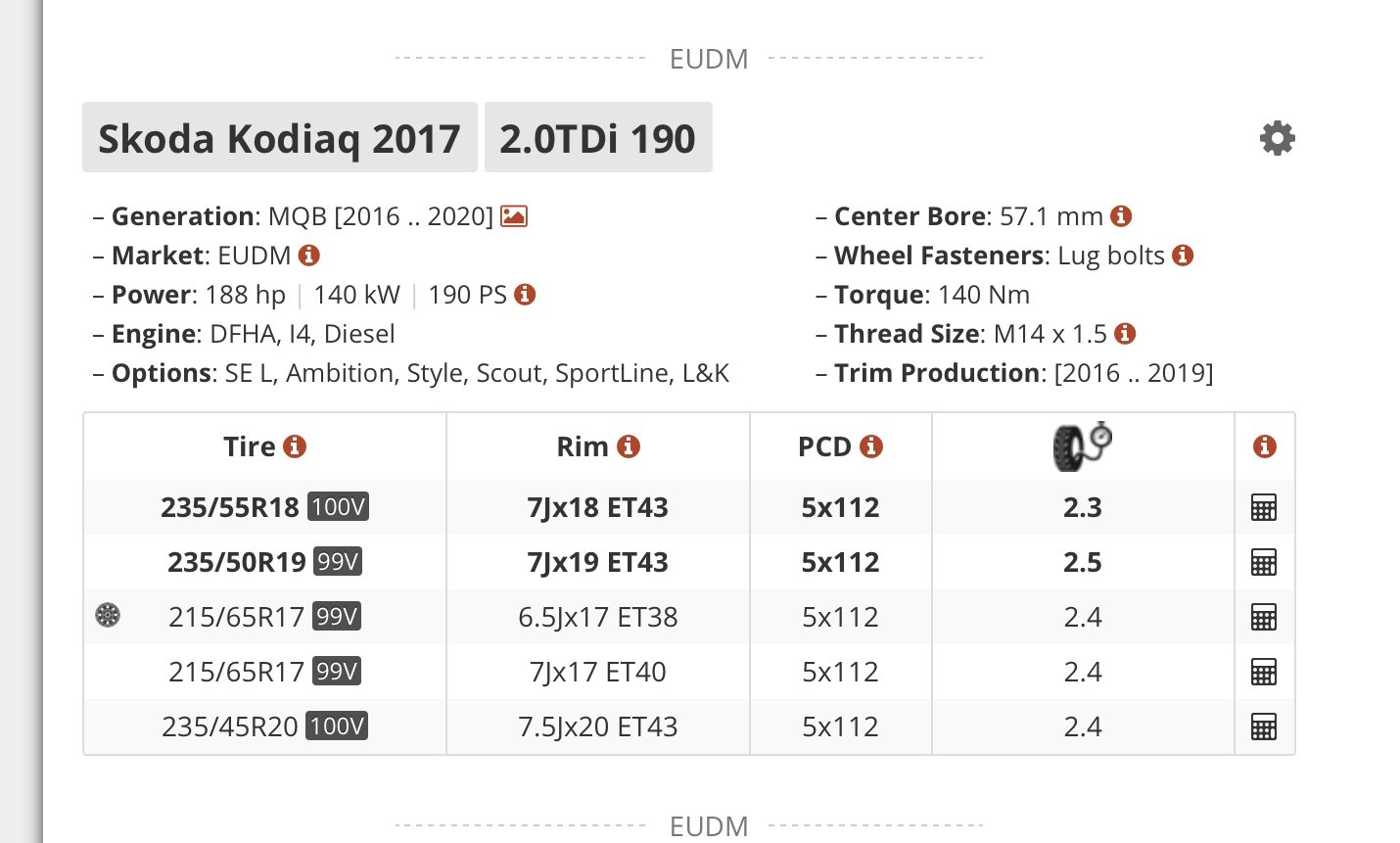

I believe 235x55 is the only Skoda recommend tyre size for 18” wheels.

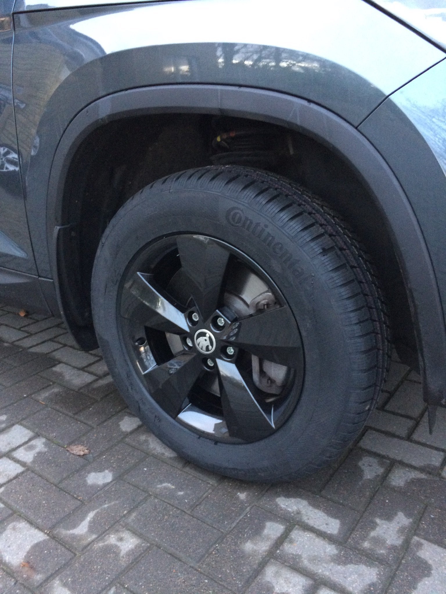

I’ve got 215x65x17 which is a recommended size as my winter wheels.
Edited by Kenny R
Ditto. 17” winter wheels for me with the OEM 19” for summer.
OptionS seem to be . . .
willtheyfit.com
was useful for my research
