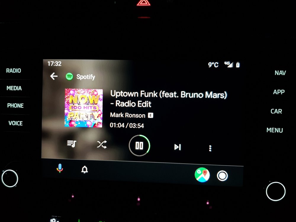

I've had a similar problem like this occasionally.
Last week, this (my daughters song choice played previously) was displayed after I'd dropped her off and asked Google Assitant to play Sabotage by the Beastie Boys from Spotify:
Talk about chalk and cheese, emphasis on the latter.
On the few occasions this have happened I've either rebooted my phone, or the head unit (by holding down the power button until it restarts). I can't recall which one worked, but it did solve the problem.
