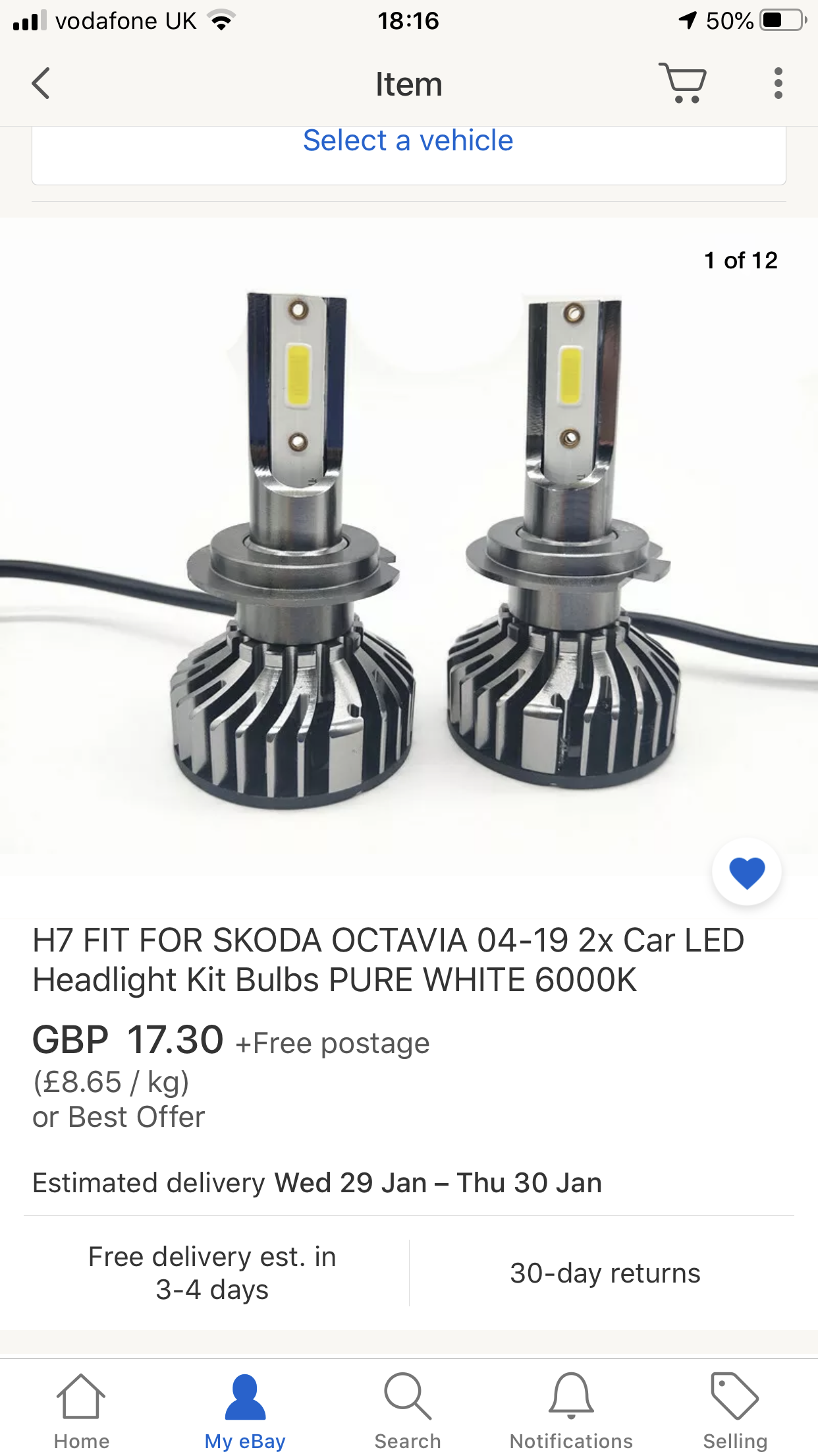

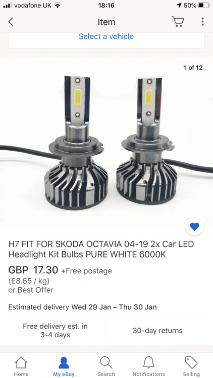

I was thinking of putting these into my 2006 diesel Octavia vrs as normal bulbs seem rubbish lol! Has anyone used these ? And are they worth having?

I've used them in the past and they are pure ****e. The light is lovely and white, and there is loads on the road right in front of the car, but the total reach isn't anywhere near as good as even a **** halogen bulb. The only ones of these retrofit "H7 LED" bulbs that are actually any good are the Philips or Osram ones, and they are substantially more expensive that the ones you have pictured.
The problem is that headlamp optics are precision manufactured for a specific type of bulb, in the case of the Octavia it is H7, where the bulb is mounted in a certain way and the actual characteristics of the light source are a standardised thing. They are designed to produce a specific beam pattern based on those characteristics, which is why the headlights are great with they have a halogen H7 bulb in. But these LED retrofits, while they fit in a H7 lamp holder, do not have the same light characteristics as a halogen bulb and therefore the beam pattern produced by the optic is incorrect and usually will end up blinding other drivers because the cutoff is way too high, or will be completely useless because the beam cutoff is too low.

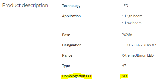

The Philips/Osram ones differ because they are made by reputable companies who are absolute experts in lighting design, and their LED bulbs DO have the same lighting characteristics as a halogen bulb.
The cheap LED ones I used were "Nighteye" ones from eBay, the beam pattern in the Octavia projector lens was good, with an extremely sharp cutoff in the correct place, but the hot spot was much lower than it should have been, so there was a massive bright spot about 5 metres in front of the car, and about zero light further than about 15 metres in front of the car.

I don't think any LED retrofit bulbs are road legal here
