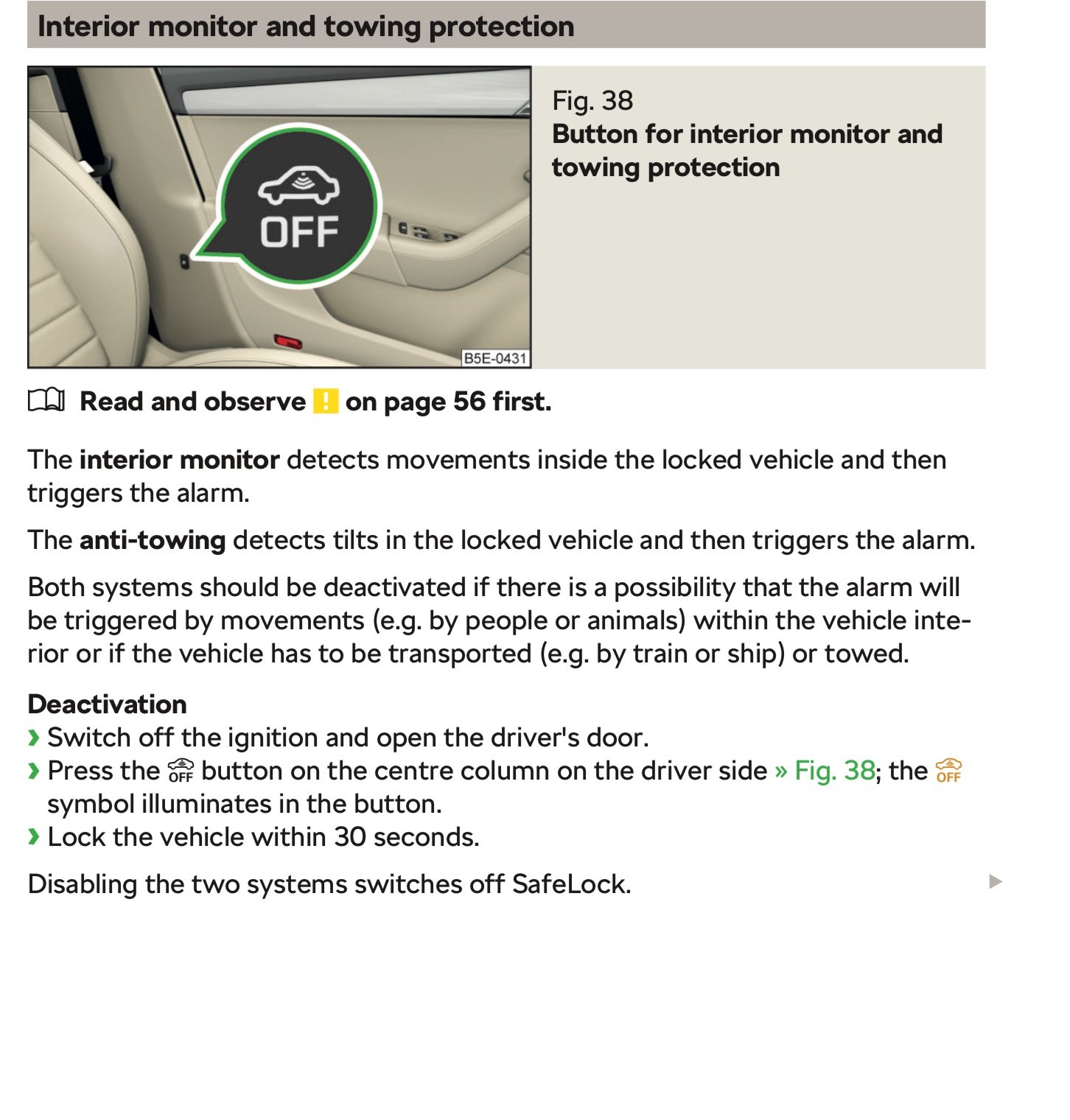

From the owners manual...
Ah ha, right, thanks, so that symbol relates to the alarm not to the courtesy light. It begins to make some sense now. I'll probably find it in my manual if I look in the bit about the alarm!

Say if you're on a car ferry and all you can hear are bloody car alarms going off,it's because idiots have forgotten to turn off their interior alarms. This button is for that purpose.

Pressing the lock button on the remote does disable the interior alarm, but it also unlocks the deadlocks so reducing the security of your Pride and Joy.
It also allows you leave your windows slightly open in hot weather
