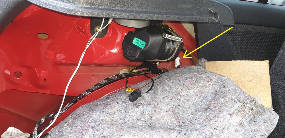

Well, that pipe is routed down the left side of the car, under the floor carpet, and through the LS rear wheel arch, where there's a joint which frequently comes apart...
The pipe that goes into the bulkhead is the one going to the rear. It also has a joint behind the nearside rear wheel arch trim as Ken says...

I have now found the pipe inside the front footwell that goes to the rear of the car. However, it looks like previous owners have cut it short  I shall join a new piece of pipe to the one from the pump and try to find the hole it goes through into foot well.  Having just spent £600  on a new clutch and flywheel a wheel bearing has now gone , This cheap car could be a money pit . Once again thanks for your advice

The pipe exits the bulkhead behind the ABS control unit pipes where it connects to the pipe from the pump.
