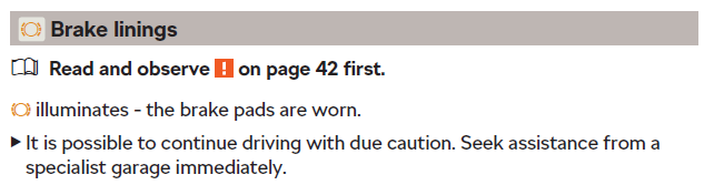

Hi,
Do all Kodiaqs come with a wear indicator for the front pads or is it just certain models?
Thanks
The manual makes no mention of it being model specific, although I appreciate is has been before on older Skoda models.
In the UK it is almost always on the nearside or passenger side inner front brake pad only. It is easy to spot if you're able to stick your head into the wheel aperture...
Oh great. Thanks for the reply. I'll have a look then see if I can spot it. I was only wondering as the pads look pretty thin but didn't see a light.
Thanksv
