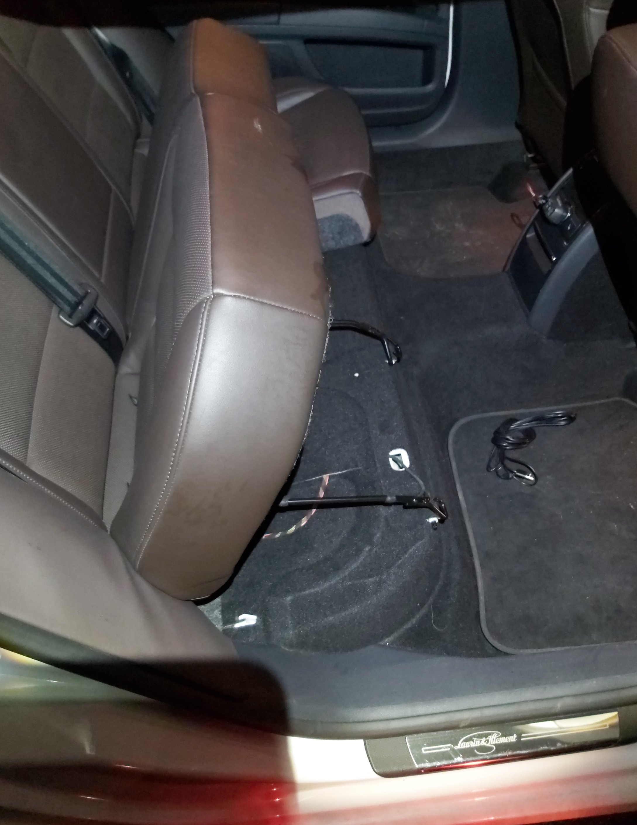

Surely there must be wires/connector under the rear seat base. Doesn't  this lift/flip up on the Estate/Wagon? - Hinged at the front?
On my Hatch the seat doesn't flip up - however it's possible to lift up with a sharp pull on each side. I did this a few times to increase the load space when moving my son to/from university.
I can't comment on heated seat wires position as mine is the poverty S spec - so doesn’t have such luxuries
Edited by bigjohn

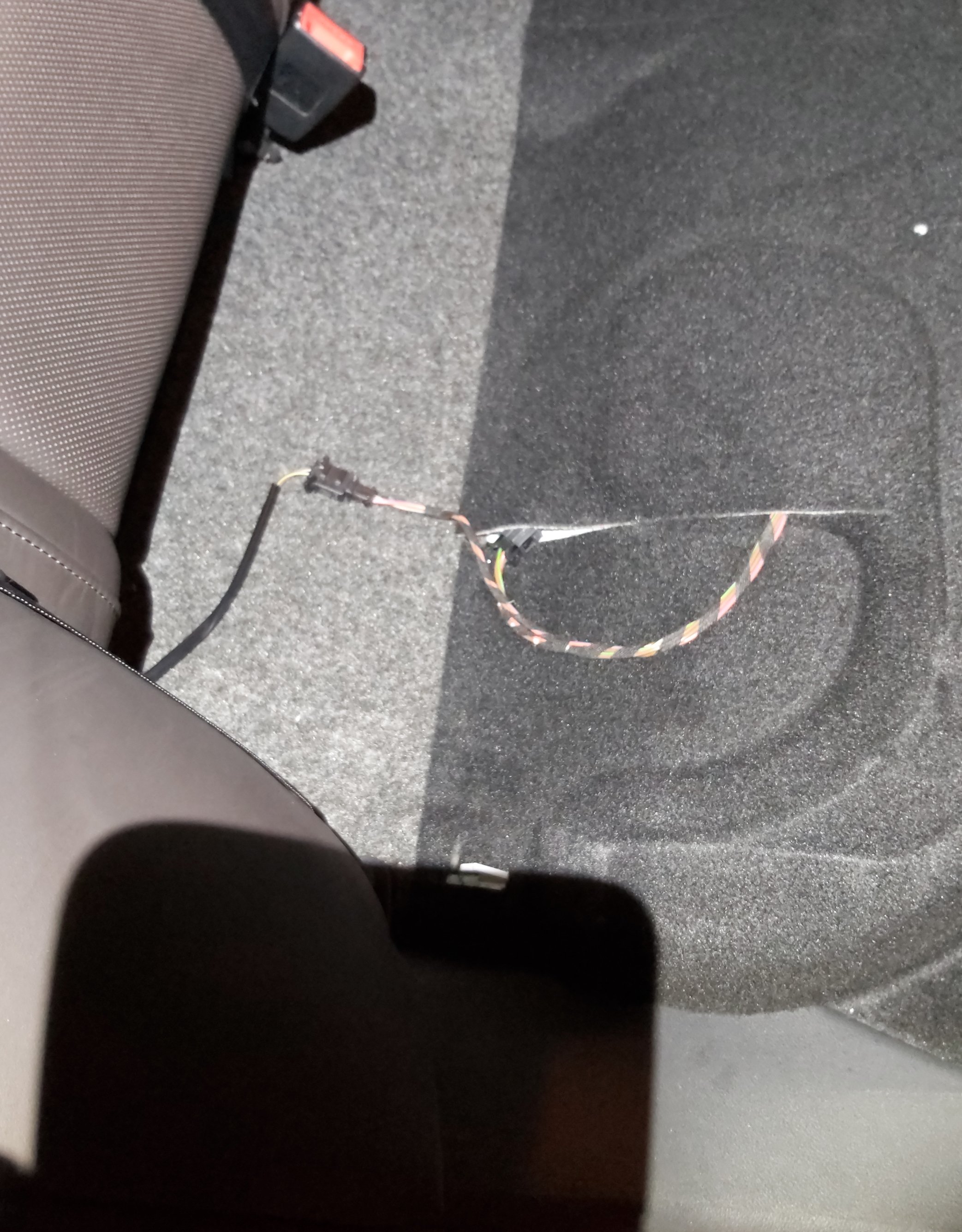

Your seats probably lift like this then flip forward, then disconnect the cable (I'm guessing one is for the heater, one is for the seat occupied sensor).
You may also be able to attack it from the switch side and remove the contacts from the inside.
