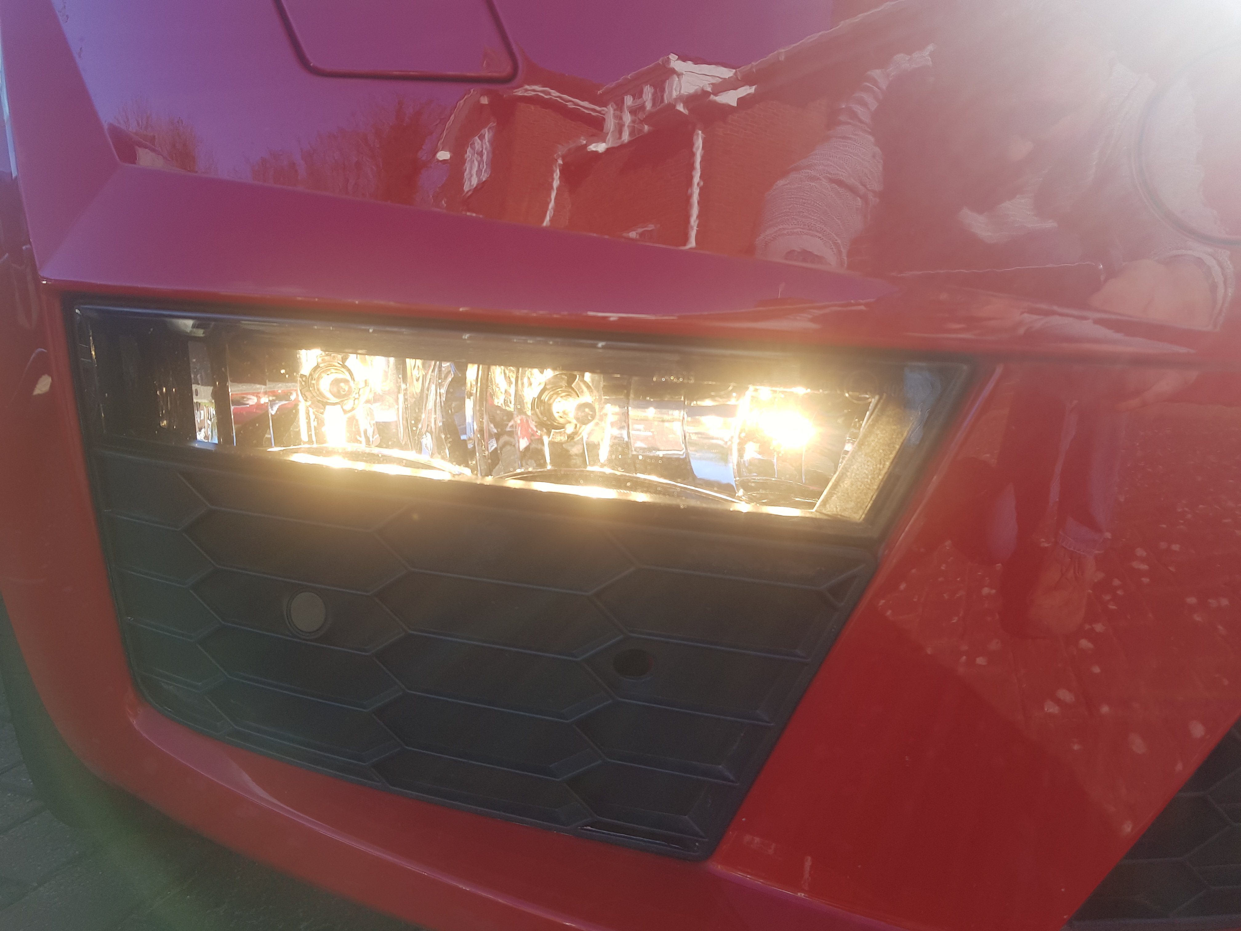

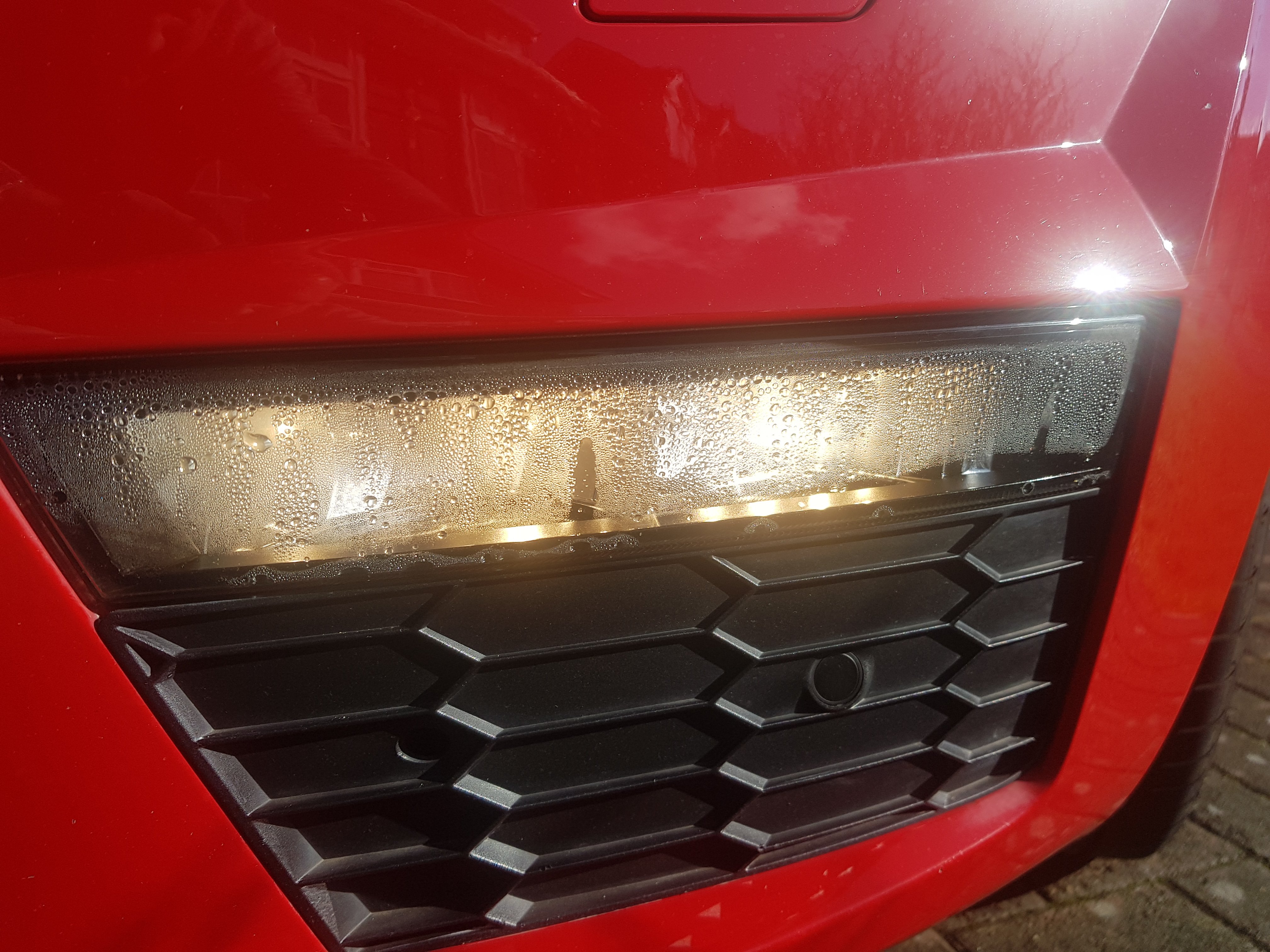

Ok, I've now calmed down a bit after having read this post first thing and realising it's about the same problem as I've got.  Two pics below illustrate the situation, with the first obviously being the one with the water problem.  You can clearly see the water has built up inside the lens to the point where it's running down the inside.  What's more difficult to see is there is also a thin layer of water sitting in the bottom of the unit - I've just pulled up and it's slopped forward to clear part of the bottom of the lens.

The latter is particularly illuminating.  Although my headlights are LED with the auto adjusting mechanism, I'm familiar with the occasion patches of condensation inside them.  However I hadn't seen this before with my fogs, which are the conventional bulb type rather than LED.  Having followed the Nissan trouble shooting guide, I've had my fogs on for upwards of half an hour and the vast majority of the water has now disappeared.  I've also noticed the fog lenses get considerably hotter that for the main headlight unit.  There's still slight traces of water droplets in the top two corners but it's now looking considerably better, and clearer, than it did before!
