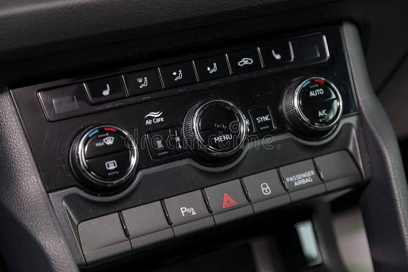

You should have the P button if it is factory fitted.
It was factory fitted but I dont have the button.

While thats invariably linked to the cameras not working, I defo dont have the dash button that it seems i should have!!!

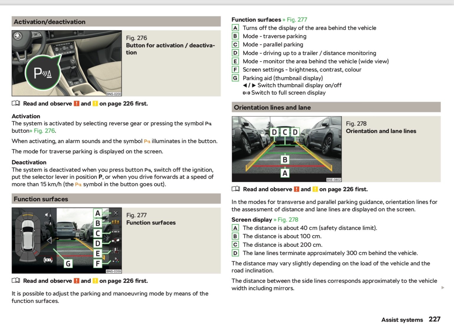

The owner's manual, in typical Skoda fashion is pretty useless. It does suggest that if the reverse camera is factory fitted you get the P button.
It would seem in fact that the P button is only fitted when front parking sensors are fitted.
If you have both the reverse camera and front parking sensors factory fitted then the P button turns both the front sensors and camera on or off.
Presumably, if you only have the reverse camera, without the front sensors you do without the button and therefore the ability to turn the camera on or off. It's operation is then tied to rear parking sensors and operates with the selection of reverse gear.

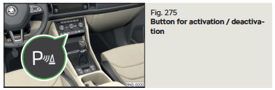

Here is an early 2018 Kodiaq Edition with the reverse camera, no front sensors and as a result no P button...
https://www.autotrader.co.uk/classified/advert/201909041839358?keywords=camera&postcode=yo325zs&advertising-location=at_cars&sort=relevance&radius=1500&make=SKODA&model=KODIAQ&onesearchad=Used&onesearchad=Nearly New&onesearchad=New&page=1
Note: There are three different iterations of the P Button. I am referring to this version...

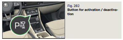

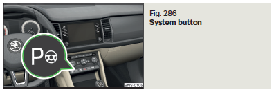

These are the others...
Area View:
Park Assist...

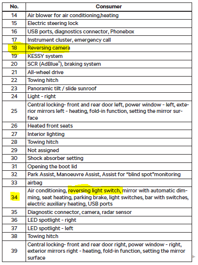

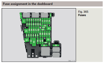

I was going to therefore suggest checking the fuse, but the reverse camera and reverse lights are operating off seperate fuses...

I didn’t know that, but I have got front sensors and the P button, so that makes sense.
My theory is of course scuppered, if it turns out the Kodiaq I used as an example has had its reverse camera retrofitted 😂
I dont have the front parking sensors fitted so maybe thats why no button on the dash
My car has a factory fitted reverse camera and no front sensors, and I have no P button.
Case settled then! 👍

And yes no P button as I dont have the front sensors
