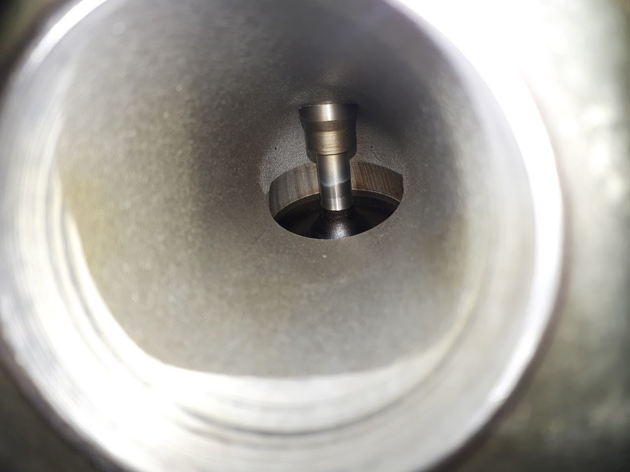

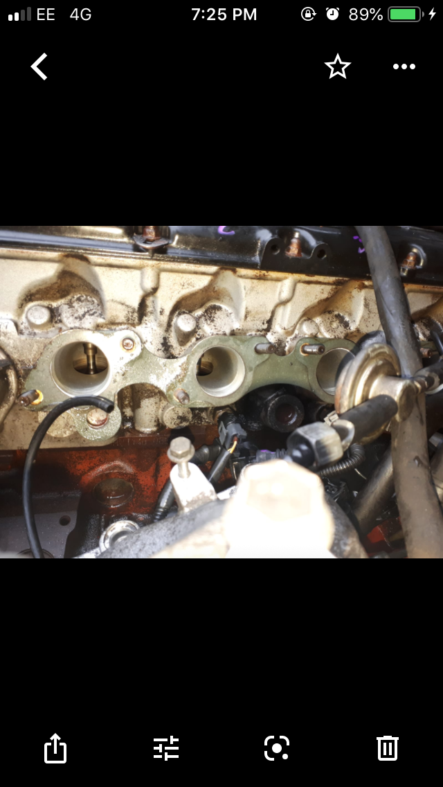

That’s one properly clean inlet port 😎 do you just run one nozzle on the kit?

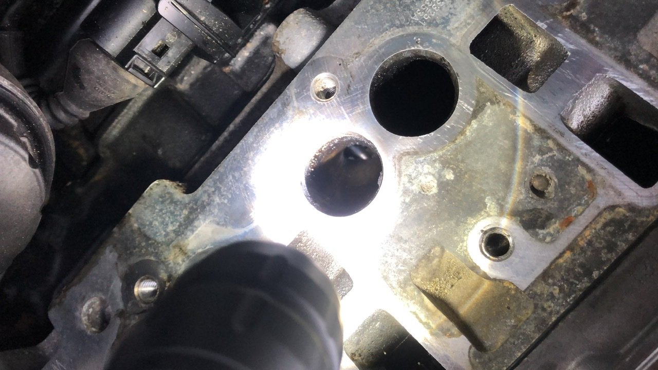

this is my 2.0tdi with a worn turbo seal injecting an oil mist 🤣 and also not hanging around when driving, it’s got 145k on it now 😬 bit of a crap photo but it’s fairly clean, not a scratch on yours though 🤣🤣

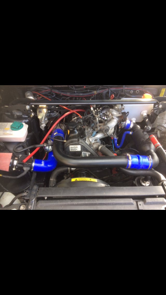

Looks good! That head picture is from a 97 Volvo 940 turbo. It’s single nozzle injection. It was straight water but now it’s wind screen wash as it has good amounts of meth/alcohol mixes . The cheap stuff £2 per 5l. Running a larger 19t turbo and charge cooler. Mapped etc.

Loving that engine bay, and you don’t see many charge coolers being fitted 😎
I still can’t believe how clean it is 🤣 I was under the impression they stopped using meth in screen wash but to be honest I never looked into it too much.

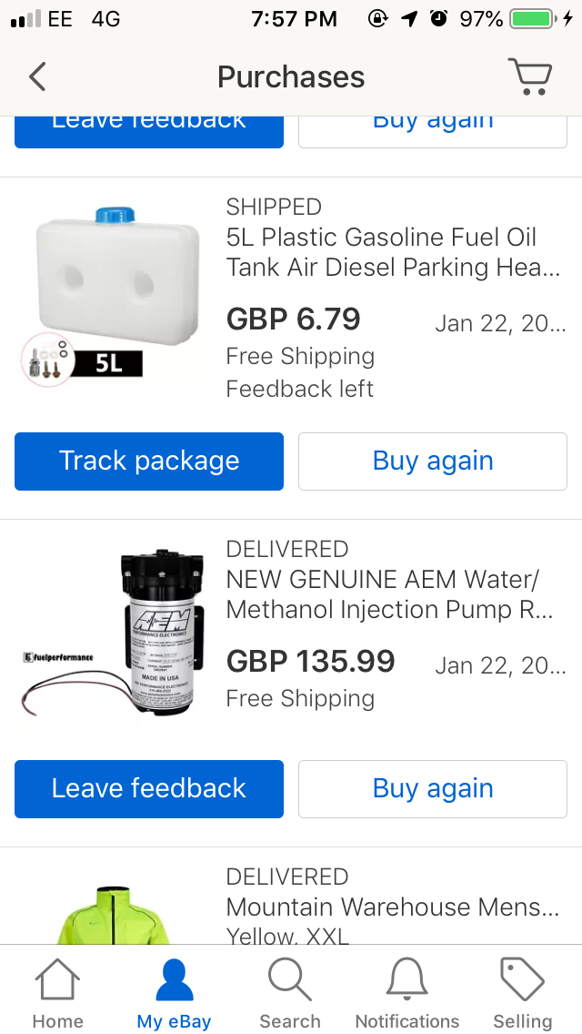

pump wise £135 aem 200psi from eBay.

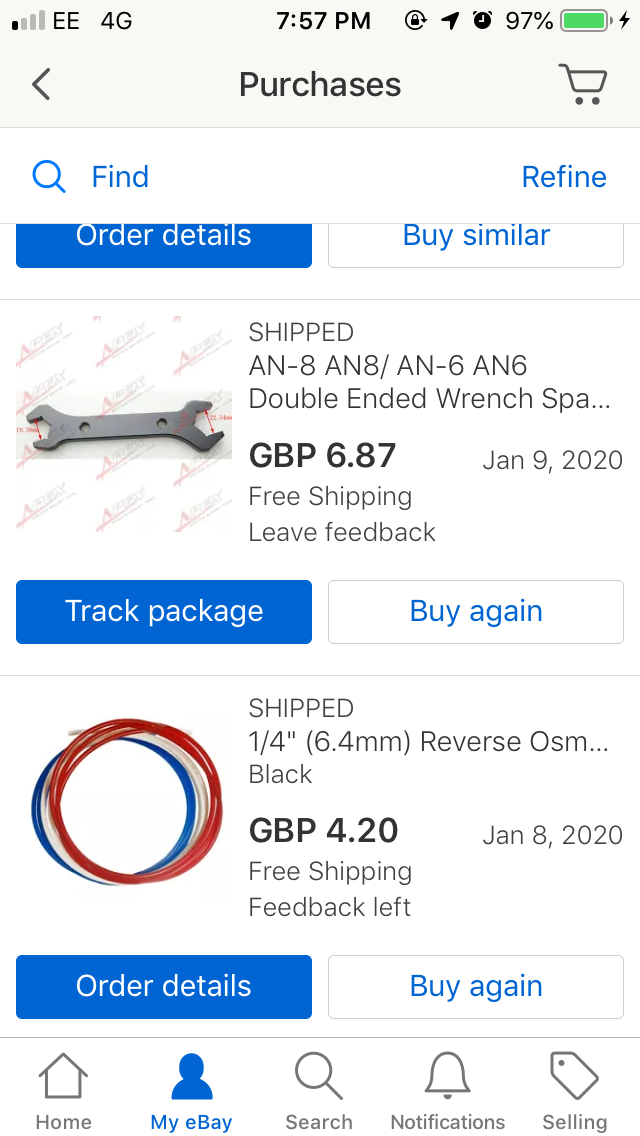

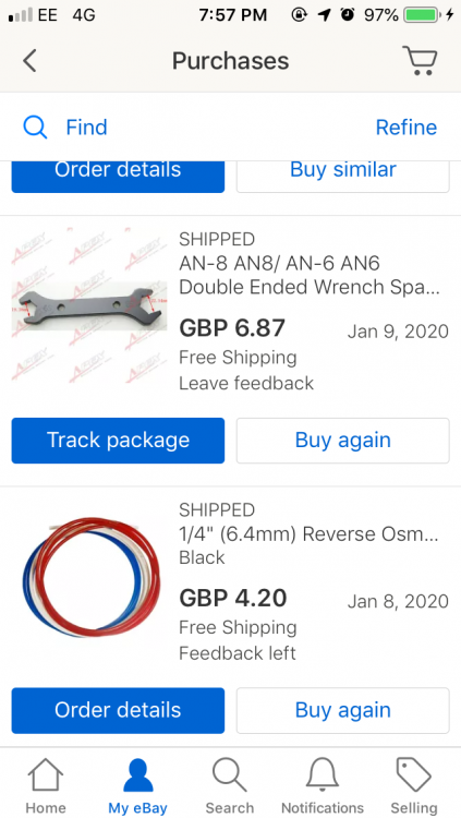

1/4 hose from eBay. Don’t bother paying loads it’s like 99p a meter. They market it as for water injection but it’s just fridge line

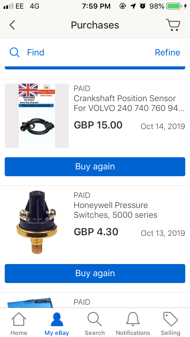

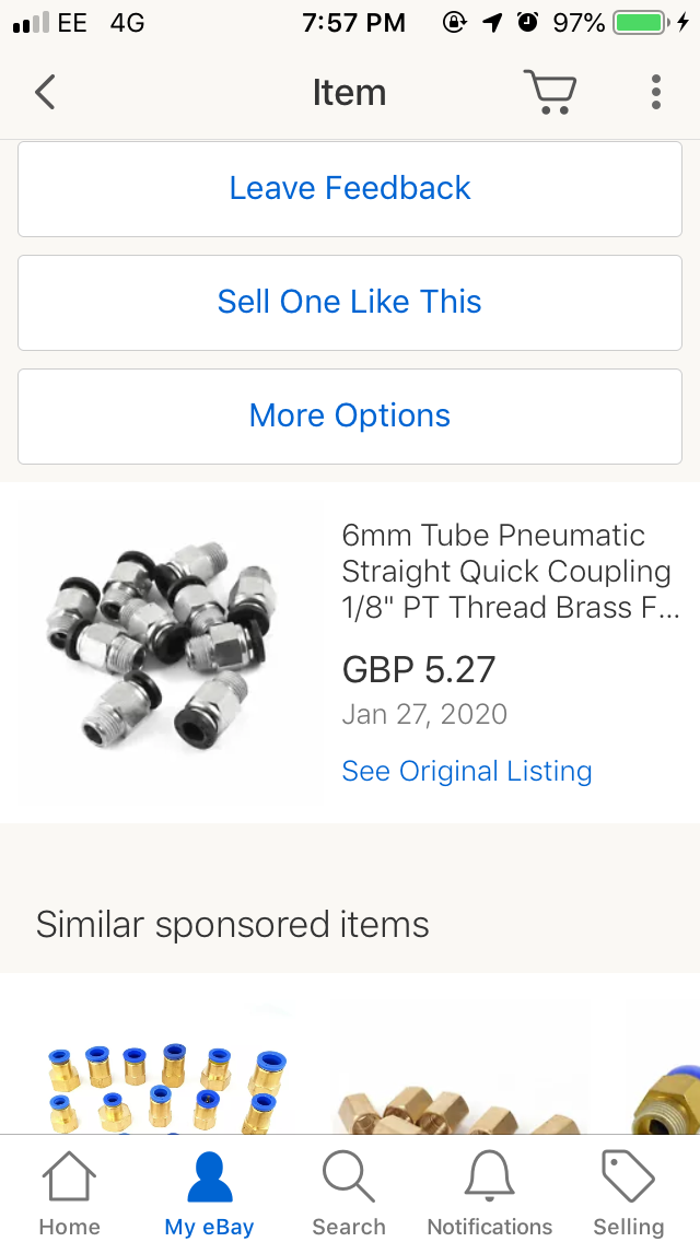

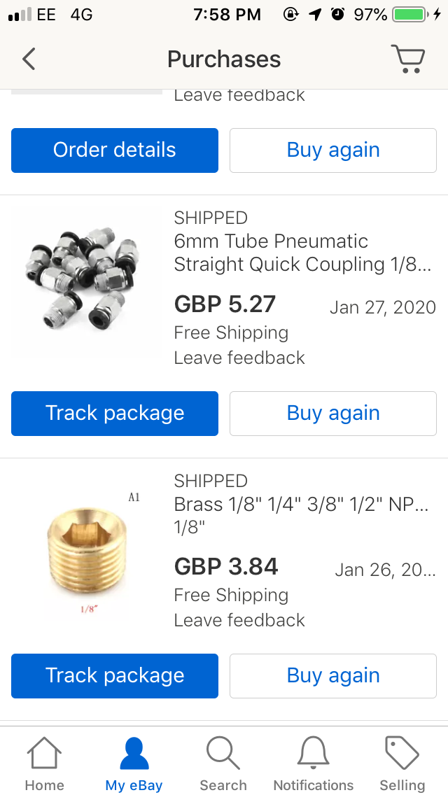

1/8 npt tap From eBay. Buy 1/8 npt fittings from eBay China. Cheap and work a treat. Even a female npt will save u cash instead of the expensive fitting.  Honeywell 5000 series pressure switch and relay and your off. I used anything from 3 to a 7psi switch.
Water tank from eBay. China £6. Used to run a kit on a Mercedes with om606 running veg oil to reduce ring gumming
