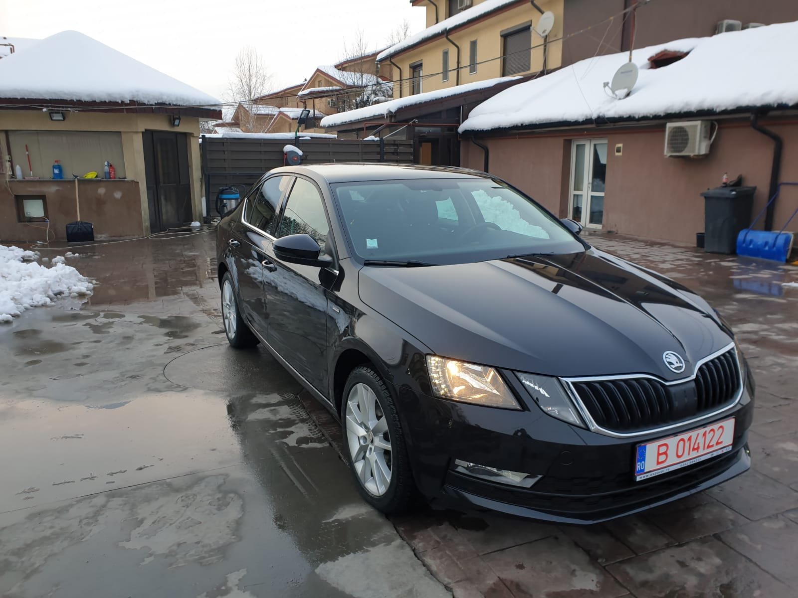

P.S Gonna leave a pic in the attachments, hope that someone could tell me what my headlights are (Halogen/LED).

You need to change the complete headlight, add the ignter, change the BCM coding/adaptation and add wiring back to the BCM (and maybe change the BCM since IIRC not all of them support Xenon headlights).
Re headlamp washers and automatic levelling - legally in the EU they are a requirement with the Xenon headlamps that are fitted to the Octavia.
Best to just fit brighter halogen bulbs - unless you like LOTS of work.

Thanks! Yeah, probably will just need to re-adjust my eyes I guess :)
Yup, looks like a LOT of work and money required to do such a thing... 😞
