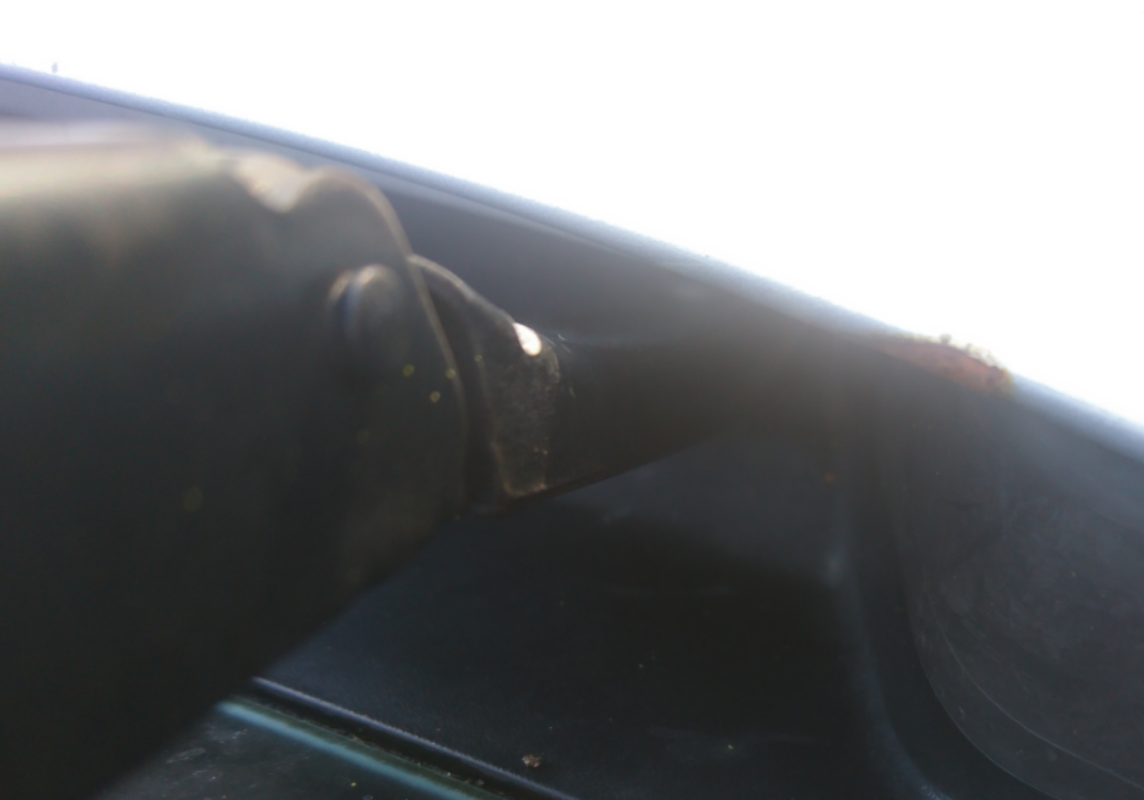

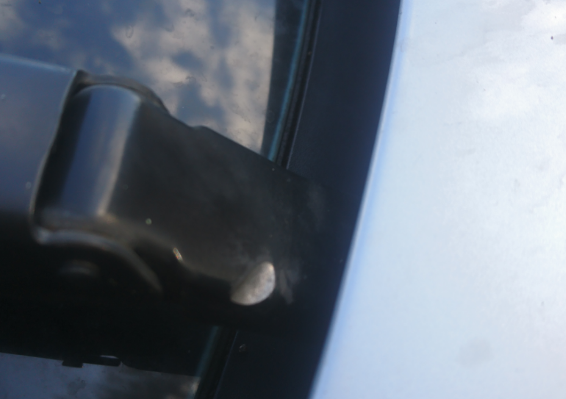

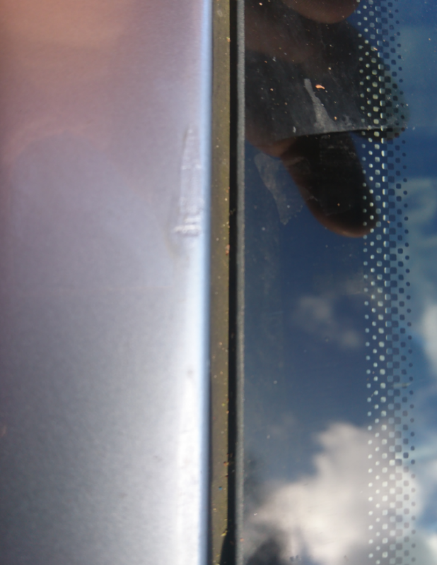

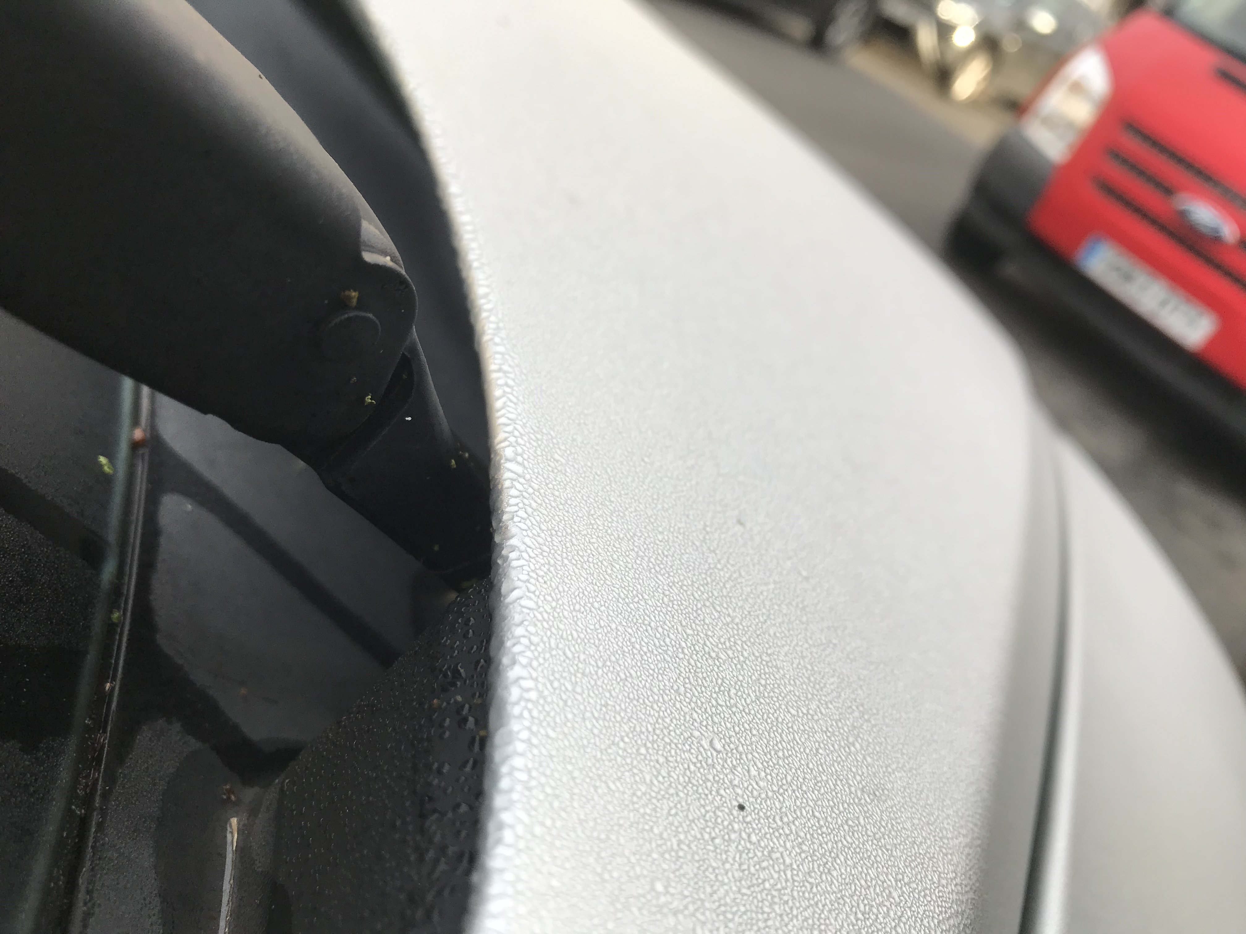

Took some pics, looks like it's been happening for a while, it's worn the paint off the pillar (been touched up), a hole in the arm, and a patch on the bonnet!
 I only just got this car, and finding it hard to believe somebody found their wipers rubbing right through the paint on the pillar, touched that up with paint but didn't address the issue that caused it?!?!

This shot is kind of tight; is it of the wiper spindle?
I took some better ones but they were too big to upload. I'll try to sort this and it'll be clearer

Fair enough; it's sort of vital to diagnosing your problem, knowing whether this is the blade or the spindle.

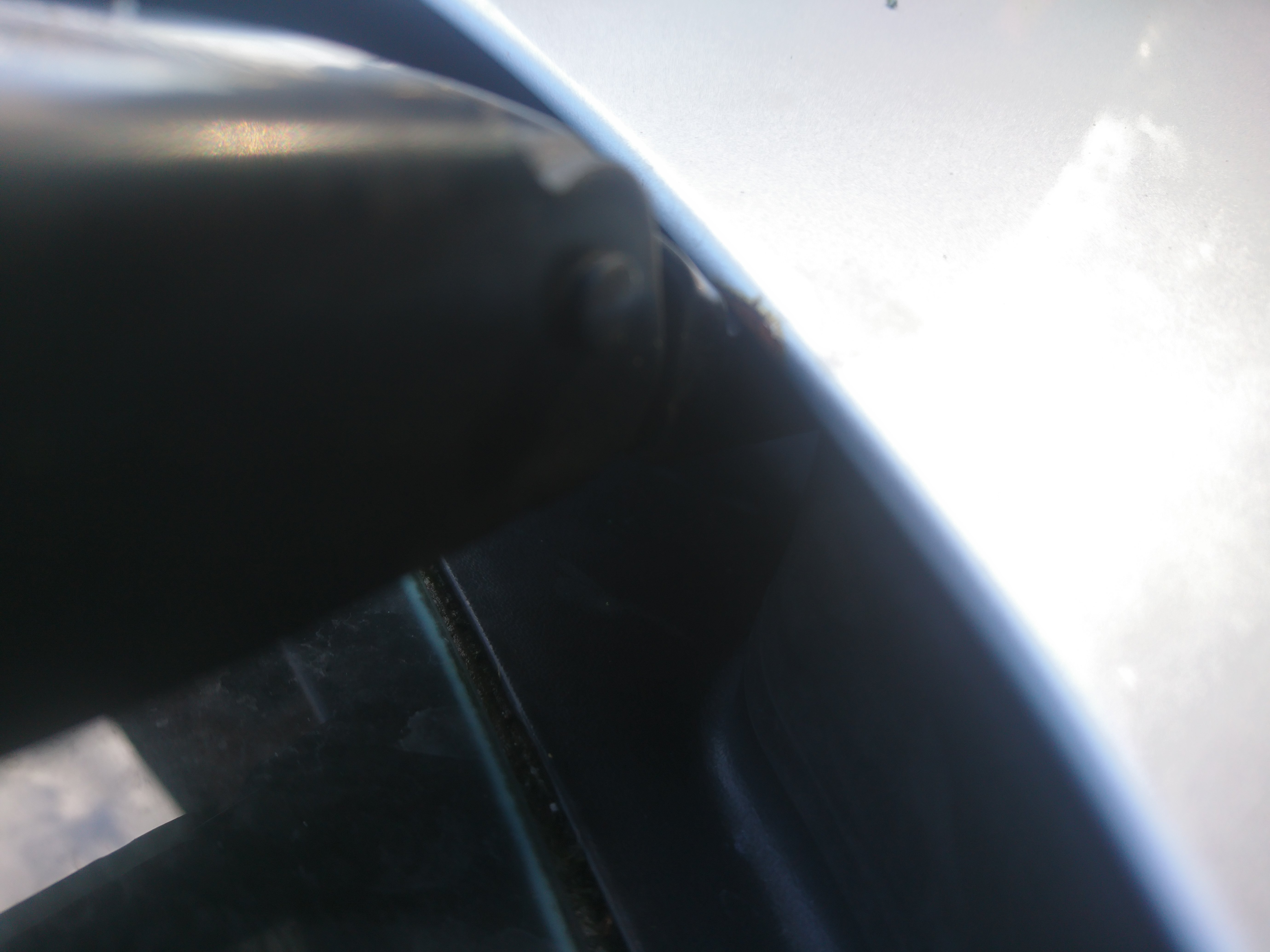

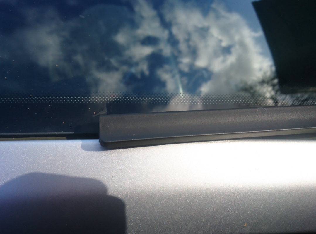

Does that make it clearer?
This is with the wiper arms a little bit backed off from their furthest vertical sweep.
That cannot be right. I can open my bonnet with the wipers in the "up change wiper blade position"
Provided that the bonnet fits correctly and level with the wings etc then the fault must be the spindles mounting position - i.e. something is bent. What though?

I don't think anything is bent.
Bonnet fits fine, wipers wipe well.
I reckon somebody had the arms off and put them back "one tooth out"

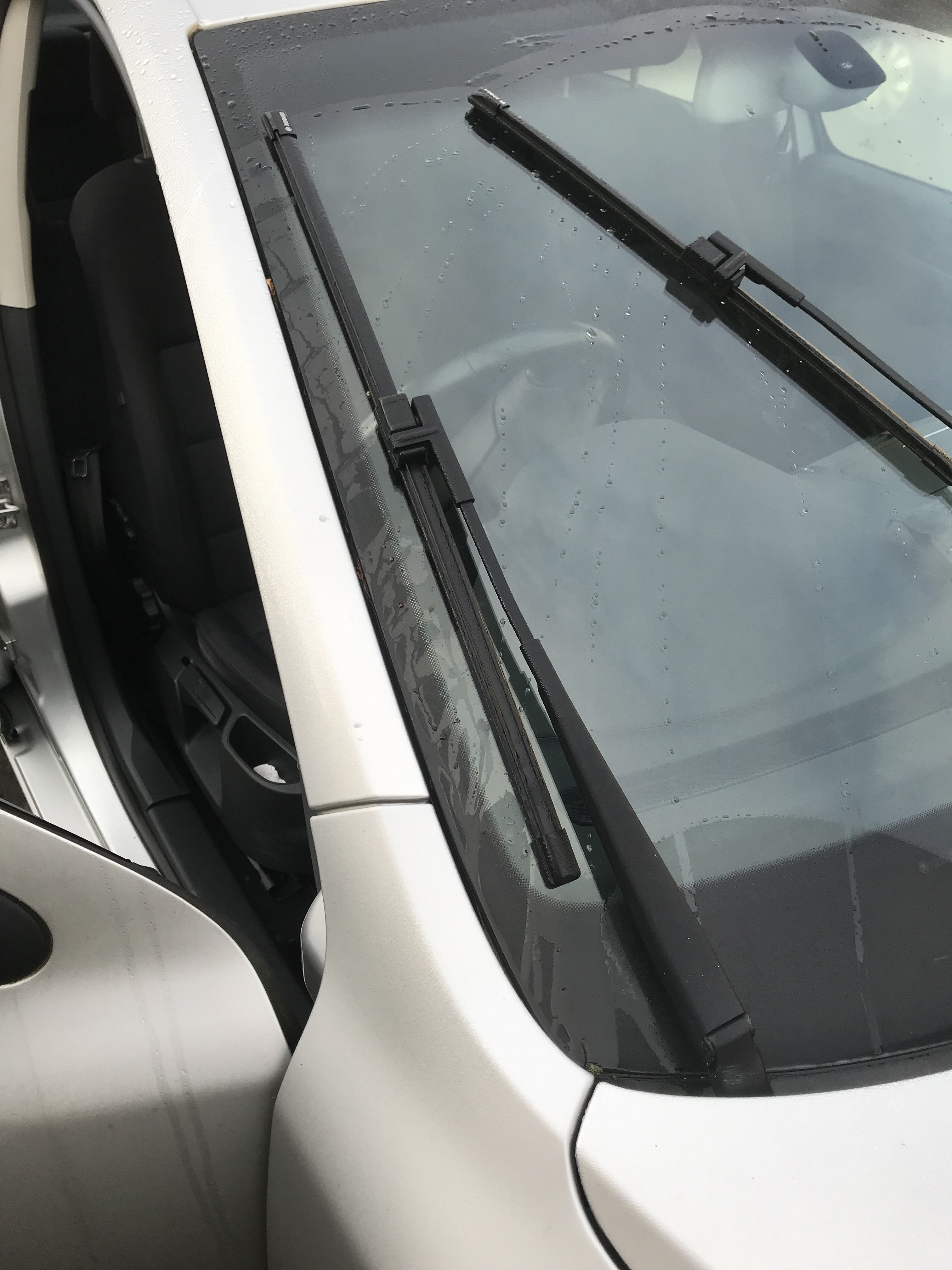

For reference from my car wiper position when fully up in blade change position

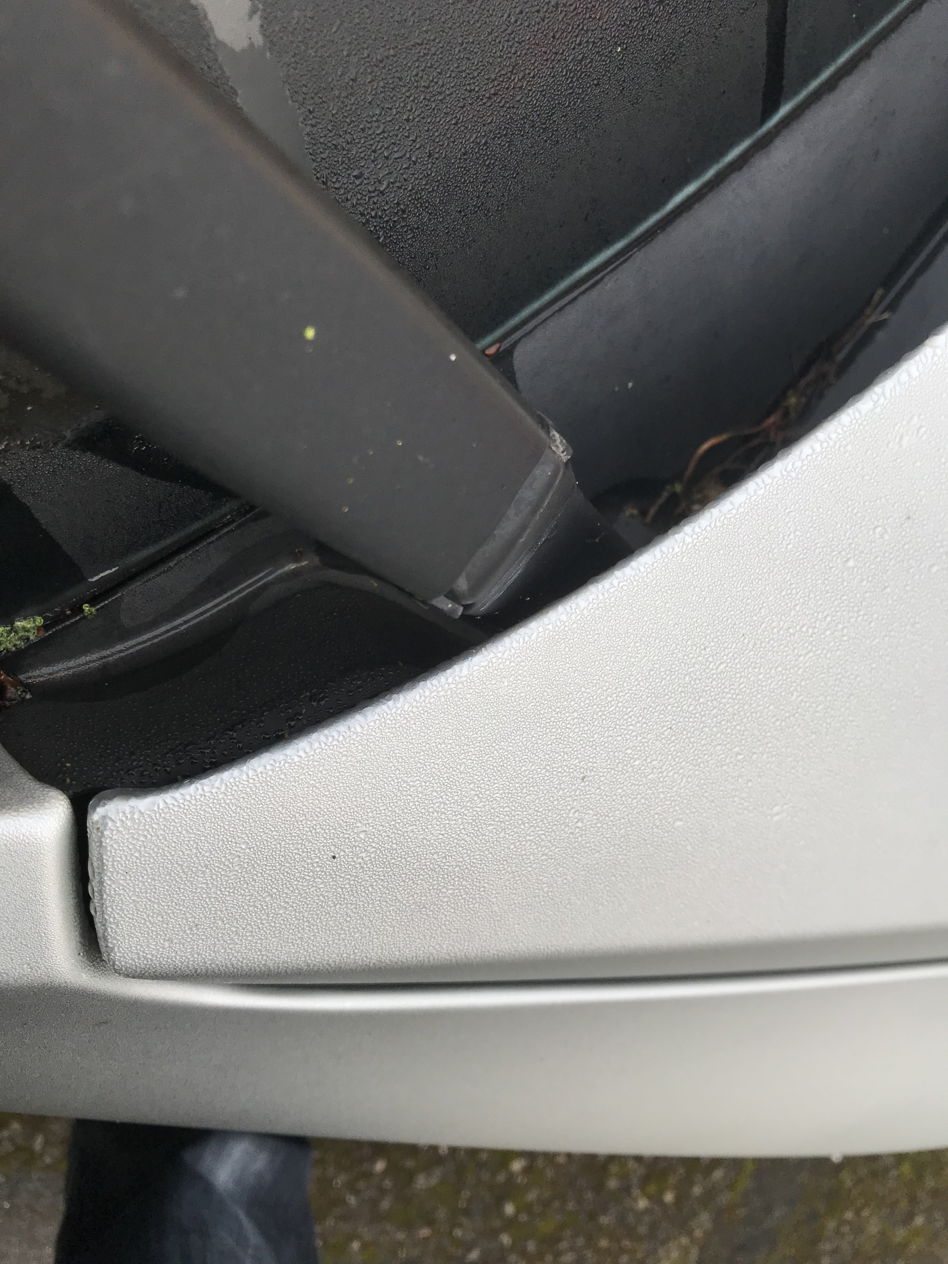

Sorry for the thread resurrection but just wondering if you ever sorted this? I've just bought a 66 plate vRS and it's doing the same. Only thing is that the previous owner has let it do it until it's ground down the wiper arm and left a decent sized mark on the underside of the bonnet.
