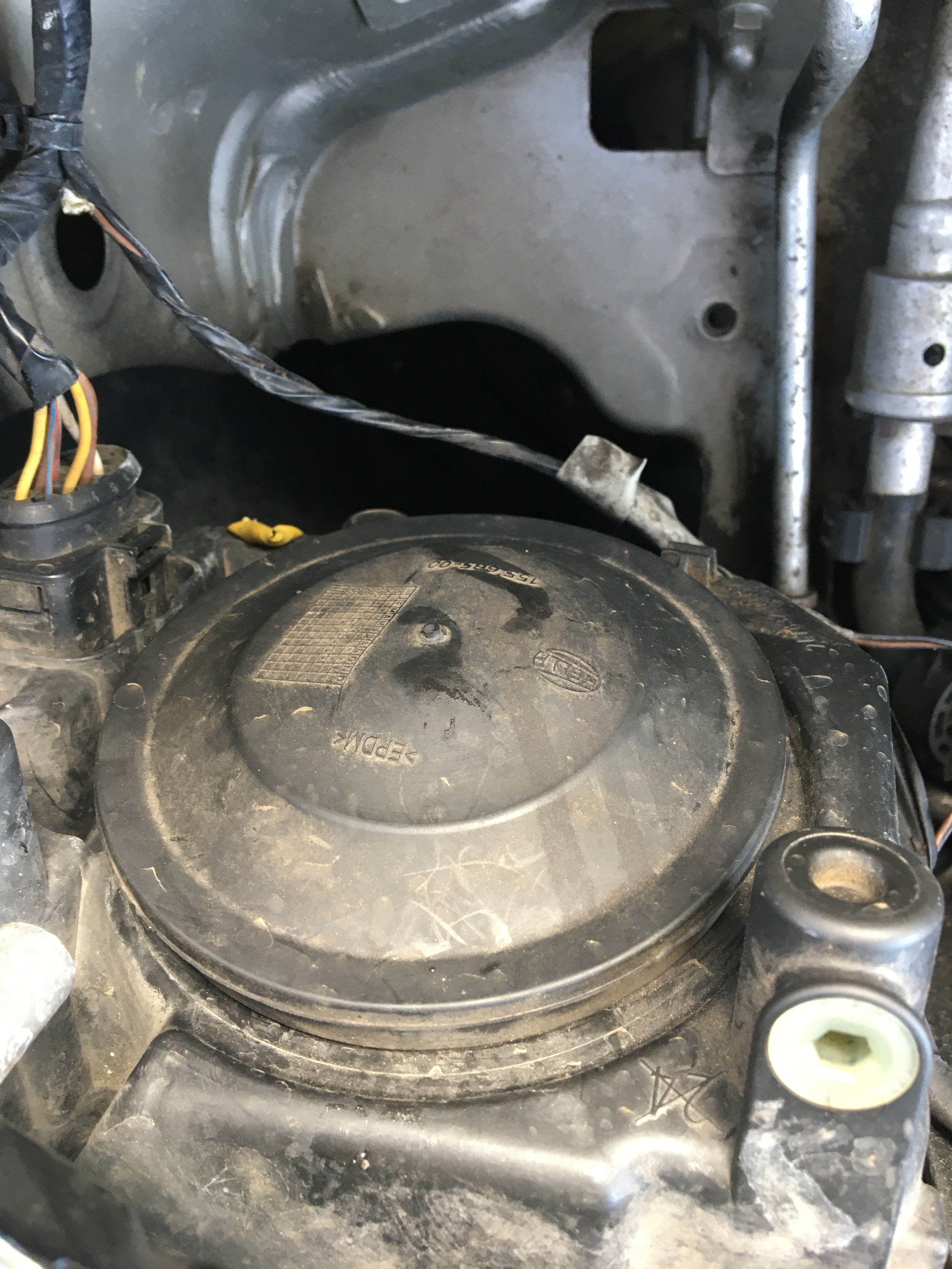

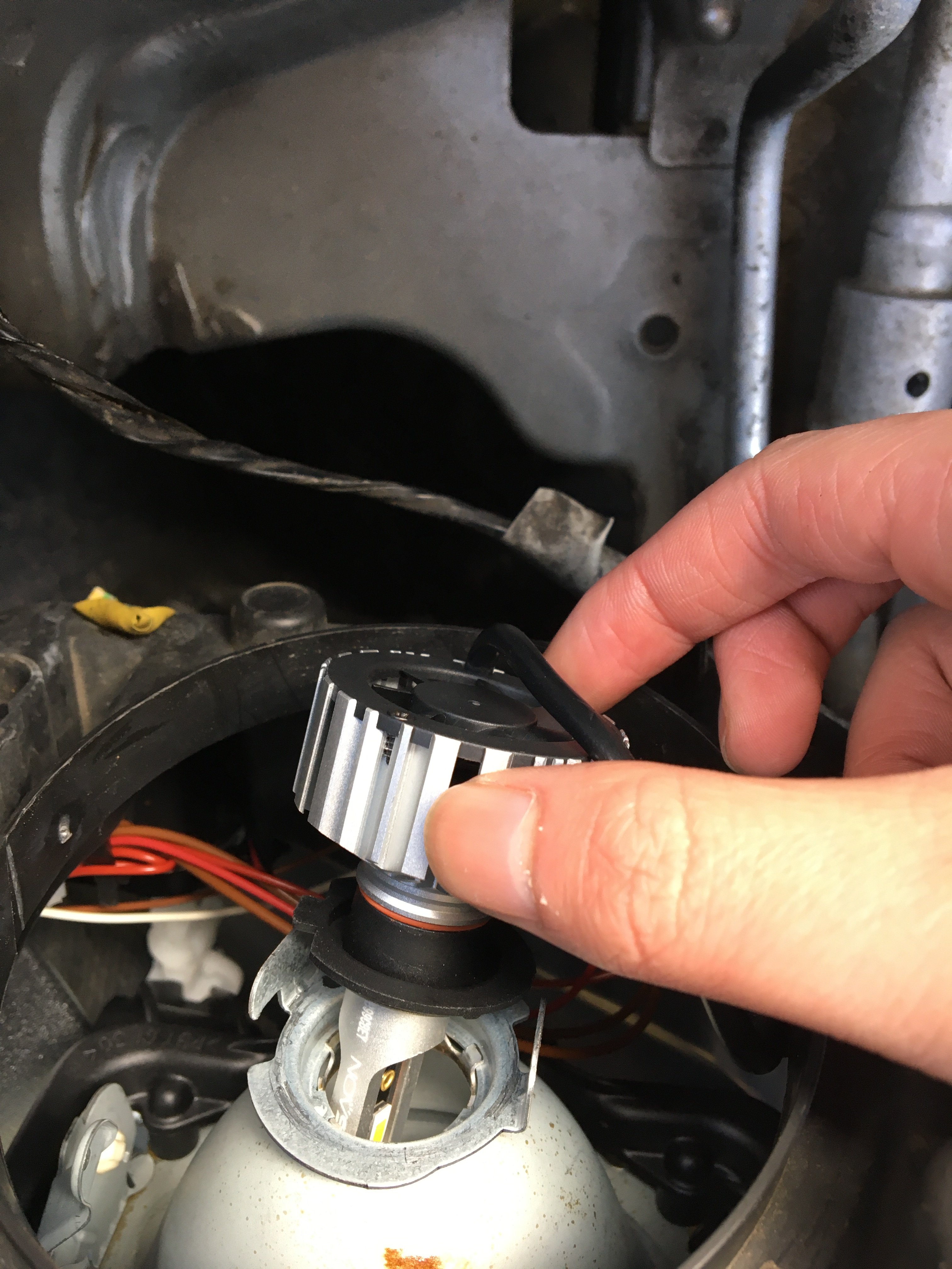

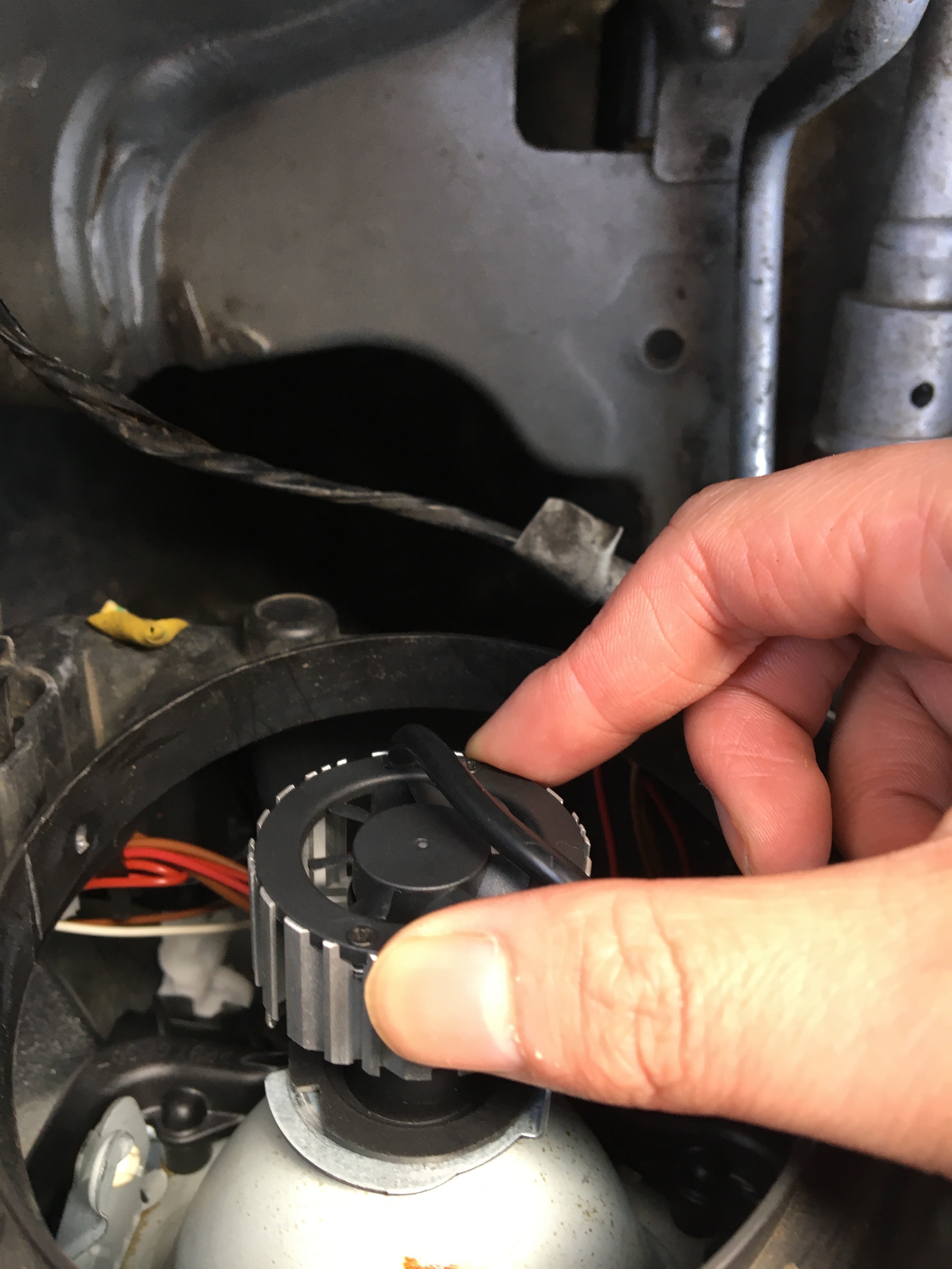

Got the LED headlights onto the car at first the black ring that is suppose to go over the headlight socket didn’t fit so I basically pushed the LED light into the socket then tucked away the leads then put the rubber cap over the lights, so the rubber cap is acting like a holder keeping the lights pushed in then took it for a bumpy drive to ensure the lights wouldn’t jiggle or move to which they didn’t and boy they do make a huge improvement to seeing at night barely  need to use the full beams.

Yea it said the same for me, technically they don’t but it 100% works look at the photos below
The black rubber cap basically just keeps the LED lights pushed into the head light socket. I’ll add some picture of me using it in the dark tonight.

PS  make sure that heatsink does not get to hot and melt the rubber cover, could be a fire risk.... Does the clip not fit to retain the bulb ?

I would’ve still kept my halogen lights at a 2-3 around towns and city’s as theirs adequate lighting already but once I go to the back roads / dual carriageways etc where there are no street lights then I’ll point the lights back up to 0 and I’ve poked tiny needle holes on the light caps to help with ventilation and yea unfortunately the black clip won’t stick to the light so the rubber cap just keeps it pushed in place.

I was also going to say, if the heatsink is touching the rubber, it might end up melting it (possible fire). You/we don't know how hot this gets. Ideally you would poke it through the outside of the cap. I know you drilled holes for some air, but you might end up with steamed headlights. It might be all ok and we are overthinking everything. Good luck 👍
I got a set of domed rubber caps just to help the fans work better and prevent this. They are like older cars, domed caps made of slightly softer rubber but they stay further away from the bulb, giving a larger area to cool. I think even then, the LED's seem cooler then halogen filament bulbs anyway!
