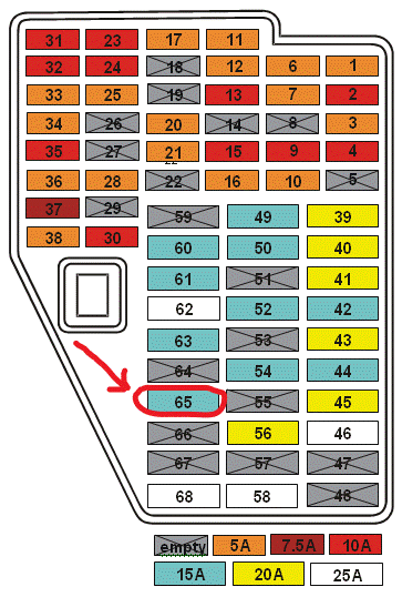

Are you sure you checked the right fuse? Number 65 (15 amp)...
Yes sure it's that one I put a new fuse in and still nothing?

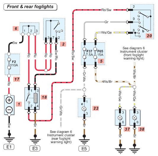

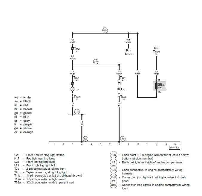

Another wiring diagram...
Thanks for the diagrams I will have  a look this weekend
