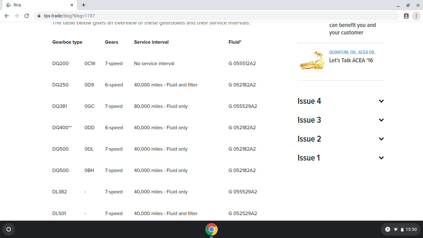

If it is a DSG with a filter then yes it should be changed at the £199 Fixed price.
As to the DQ200 DSG's.
That was not a Recall in Europe just a Service Campaign.  If with a 1.8TSI and you are swerving that then not an issue to bother about.
