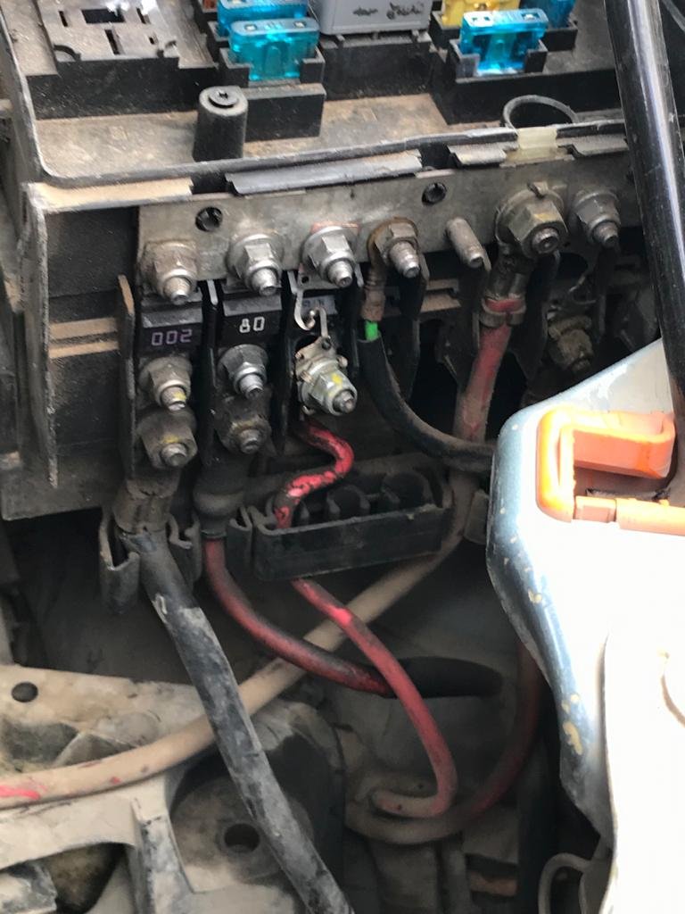

This is the blade fuse I meant, second one from the left with 80 printed on it:

The wire coming off the bottom of that 80A fuse goes directly to the module, to pin 2 of a two-way connector.  Did you clean that wire crimp on the end of the cable just below the fuse, also?
Have you tried charging the battery to see if that improves the situation?  Pin 1 of the two-way connector at J500 is an earth (brown wire), probably to nearby bodywork. Cleaning that connection is probably a good idea too.
No I didn't clean the crimp below the fuse.
I also didn't charge the battery as its reading is always fine, also the alternator's reading is fine.
I remember seeing a two wire connector but I didn't have the chance to disconnect, clear and reconnect. Due to lack of time I had the car sent to an electrician to check all of the wiring to isolate the problem, I'll update the post once I have anything new.
