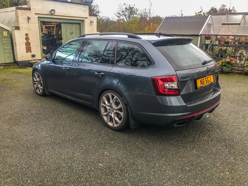

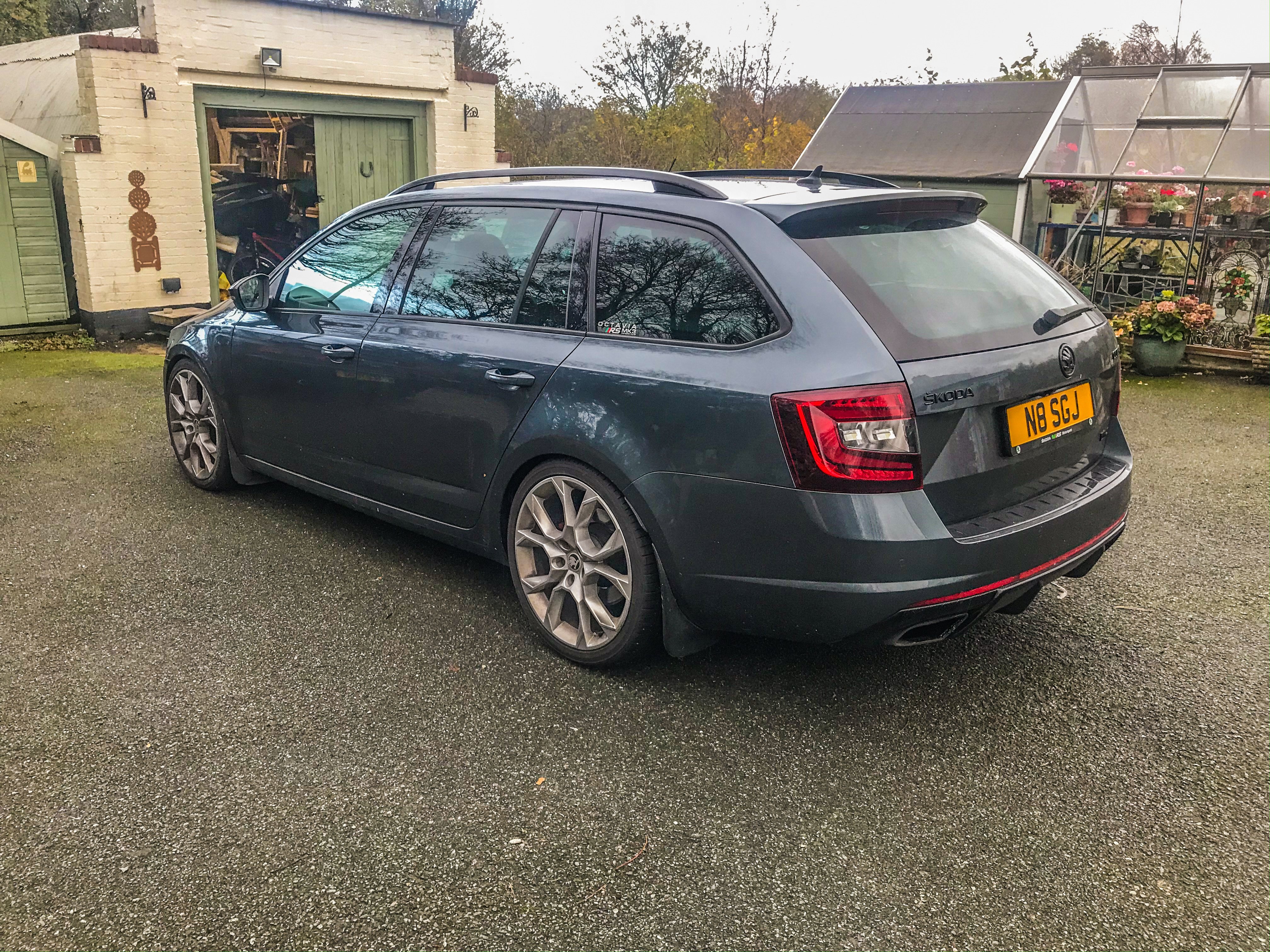

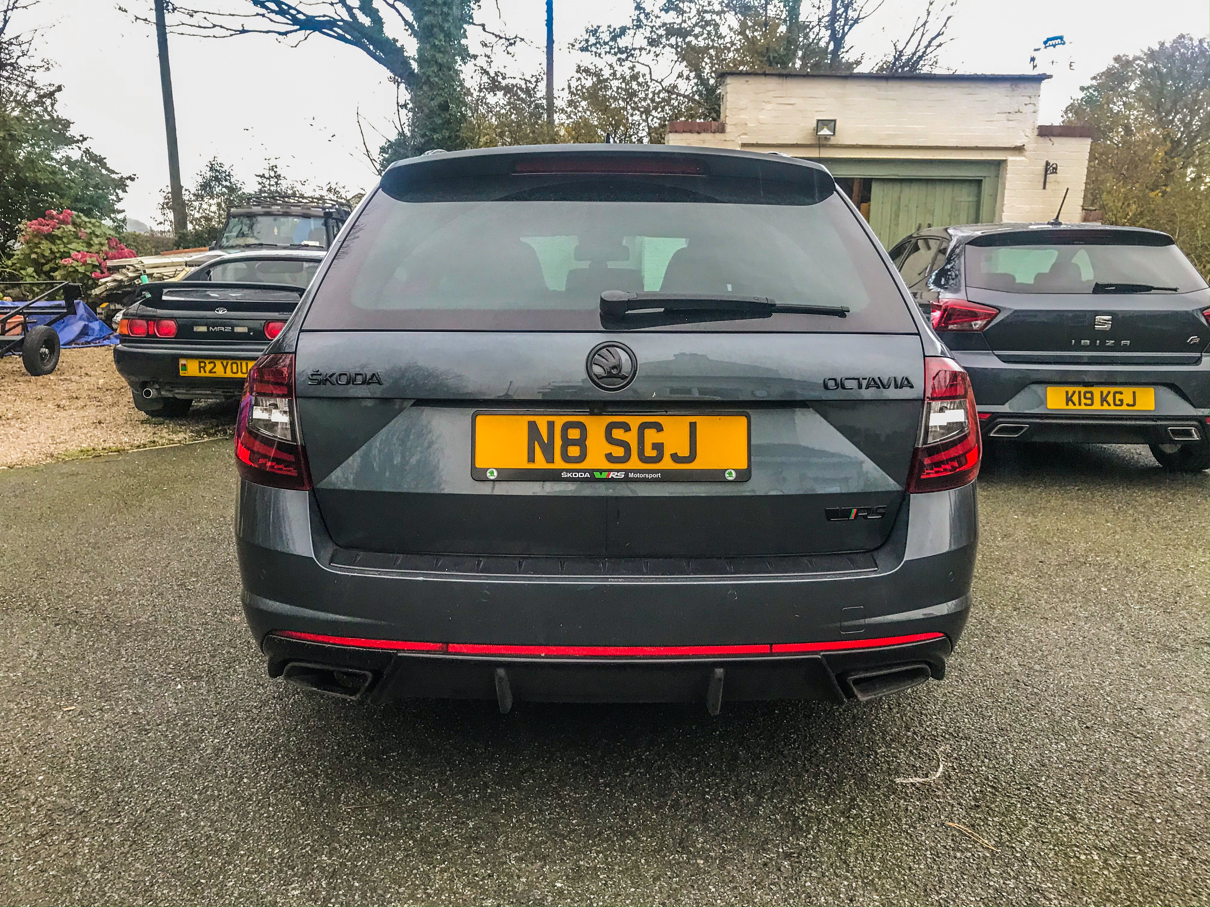

Pop a picture of them up, there are 2 types. My FL lights needed a wiring harness conversion as the plugs are totally different which is why I ask. There are 4 types of tail light fitted to the Octavia 3, the basic standard all incandescent tail lights that are fitted to the PFL, the LED PFL lights which the vRS has which uses incandescent bulbs for the indicators and reverse lights but the rest is LED and they have a double C shaped tail light pattern, the FL lowline LED rears with have a single C shaped LED tail light pattern and the FL highline LED rears which have a slight tint and look like this (my car below).
If the correct coding is performed then yes the bulb warnings will not illuminate incorrectly. Depending on which lights you have fitted I can code the channels to LED as well as any other LED pre coding you would like such as number plate lights etc.
