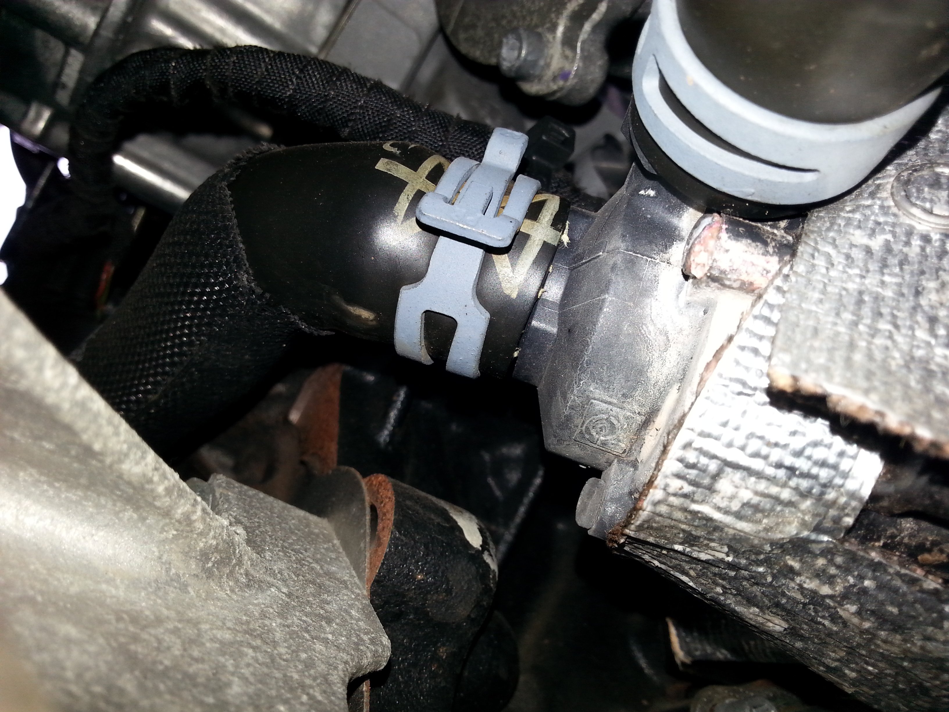

I had the same kind of problem on my 1.8 (almost same engine). The leak was coming from the auxiliary electric coolant pump which was dripping slightly. I is located behind the engine, almost under the turbo.
Yep, you have a leak, as mentioned the pump is the most likely culprit and a well documented weak point.
