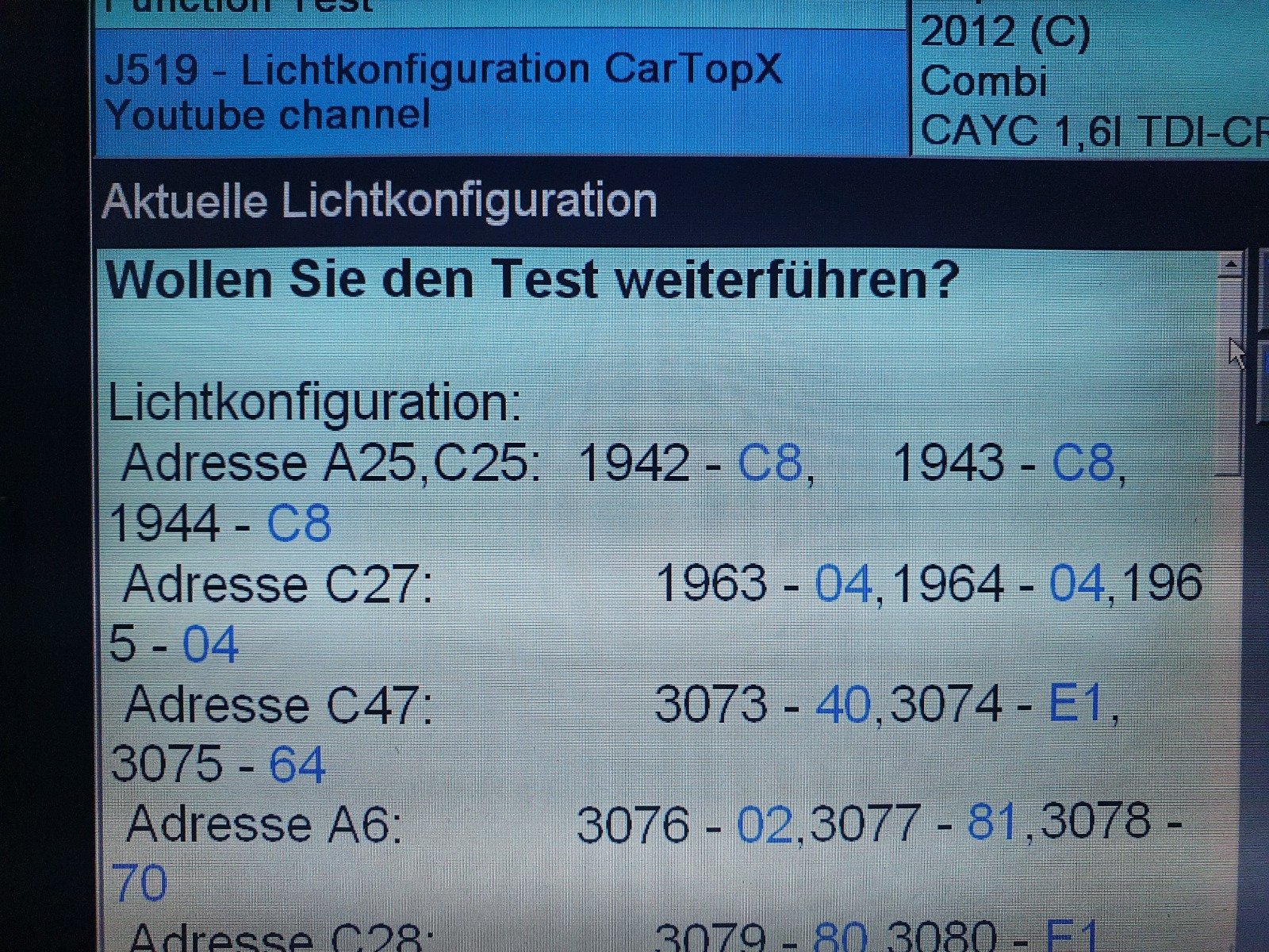

I have a small problem. Thanks to vag helper, I was able to cancel the cold diagnosis of all my bulbs that I put on the car and VAS. But the front fog has resisted.
When carrying BCM 5k0 in the fog lights directions I don't have FF-FF-FF, instead I have C8-C8-C8. Try to put F0-F0-F0 and nothing ... C0-C0-C0 and nothing ... any friends subscription ??
Thanks in advance!!!
