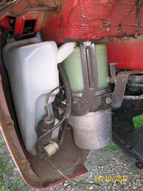

100-1124-zpsfa613492-jpg-fca6fa3127821c3
Mine failed recently, first time it failed a few taps with a wrench solved the problem but now it's proper dead, it "clicks" but that's it, figured it must be tired from almost 14 years of tropical weather and hard water.
Just ordered a Meyle 100 955 0010 unit, it's in the mail right now.

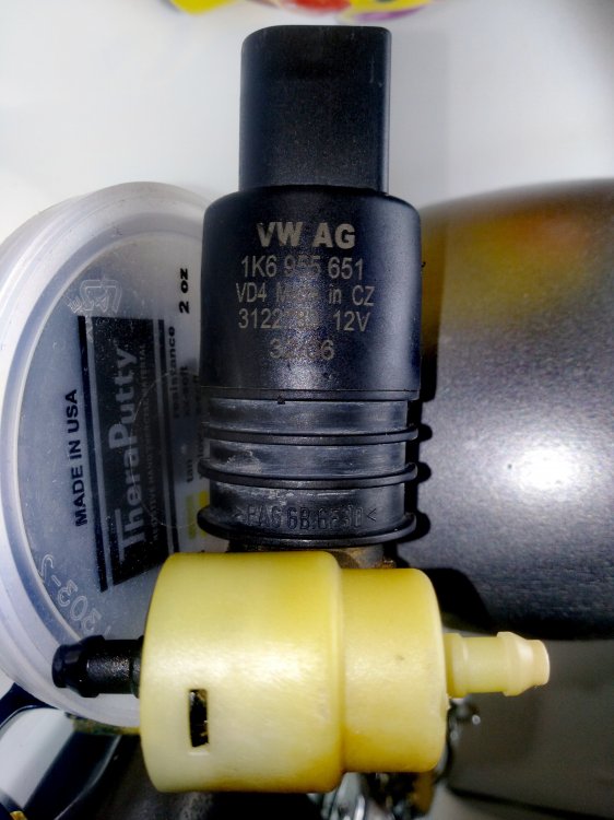

Alternative part number: 1K6 955 651 from my original pump.
Edited by juanse_2691
Posted by accident without pictures
