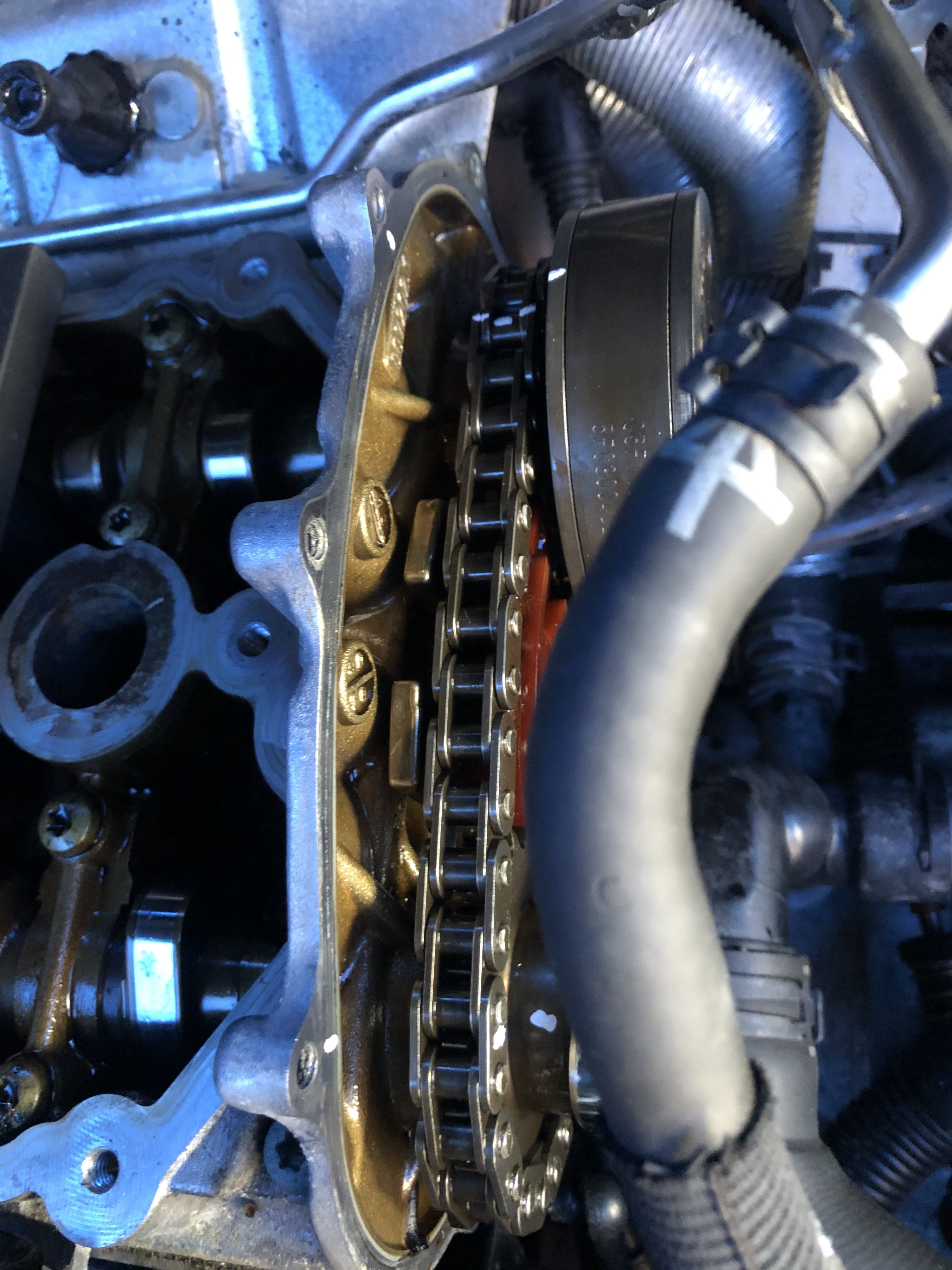

the bit on the right side of the engine in this pic?
behind the cover is this
the chains stretch and the tensioner becomes weaker, resulting in noise, it’s a fairly critical part, and can bork the engine if it fails, without hearing yours I couldn’t tell you how soon that might happen, but the fact it’s now prominent enough that you’ve noticed it, I’d say sooner rather than later is a safer option.

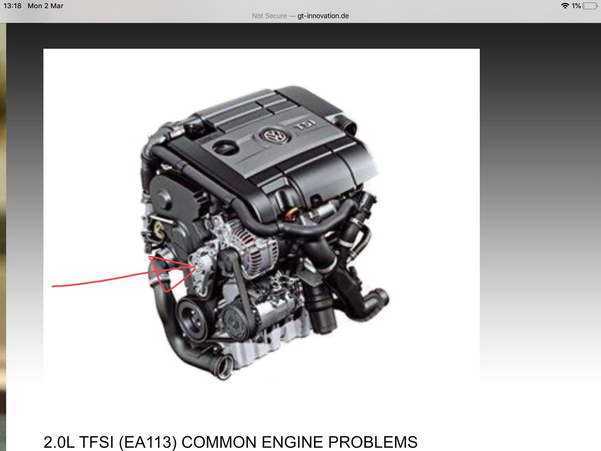

Just found this pic.  I’ve arrowed the seemingly noisy bit.  Haven’t got the car with me today so can’t have a good look to identify what it is
Sorry my bad, I only half read your first post 🤦🏻‍♂️ Mine is also a belt engine though, the belt engines also have a chain that controls just the cams 👍 When you said cylindrical thing I thought you meant the cover for the VVT cam pulley.
That thing you’ve pointed out is just the aux belt tensioner, it has a pulley with a bearing on it 👍
