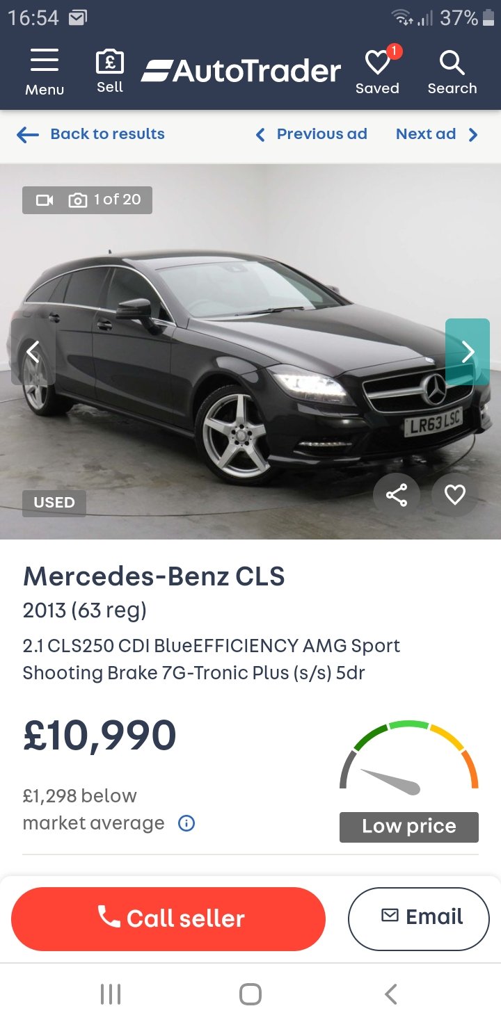

Cheap they used to be, but not anymore. £10,000 for a 2013 2.0 diesel 80,000 mile estate?
I think I'd pay the extra £1,000 for a something a bit special.
Same age, same mileage, the well proven OM651 2.1 litre diesel engine and the 7G+ torque conveter gearbox...

I spent a few nights looking at the 350s as an alternative to buying my leased 245. I couldn't bring myself to do it. They are gorgeous cars but unfortunately are more likely to go wrong and will certainly be more expensive to put right and maintain.
In terms of the Skoda, I would try and find an enthusiastic private seller with loads of history. And a manual gearbox as you have hinted.
Not sure about being more likely to go wrong, the OM642 is not without its faults but is also robust.
As for being more expensive to put right, that is a very valid point!
