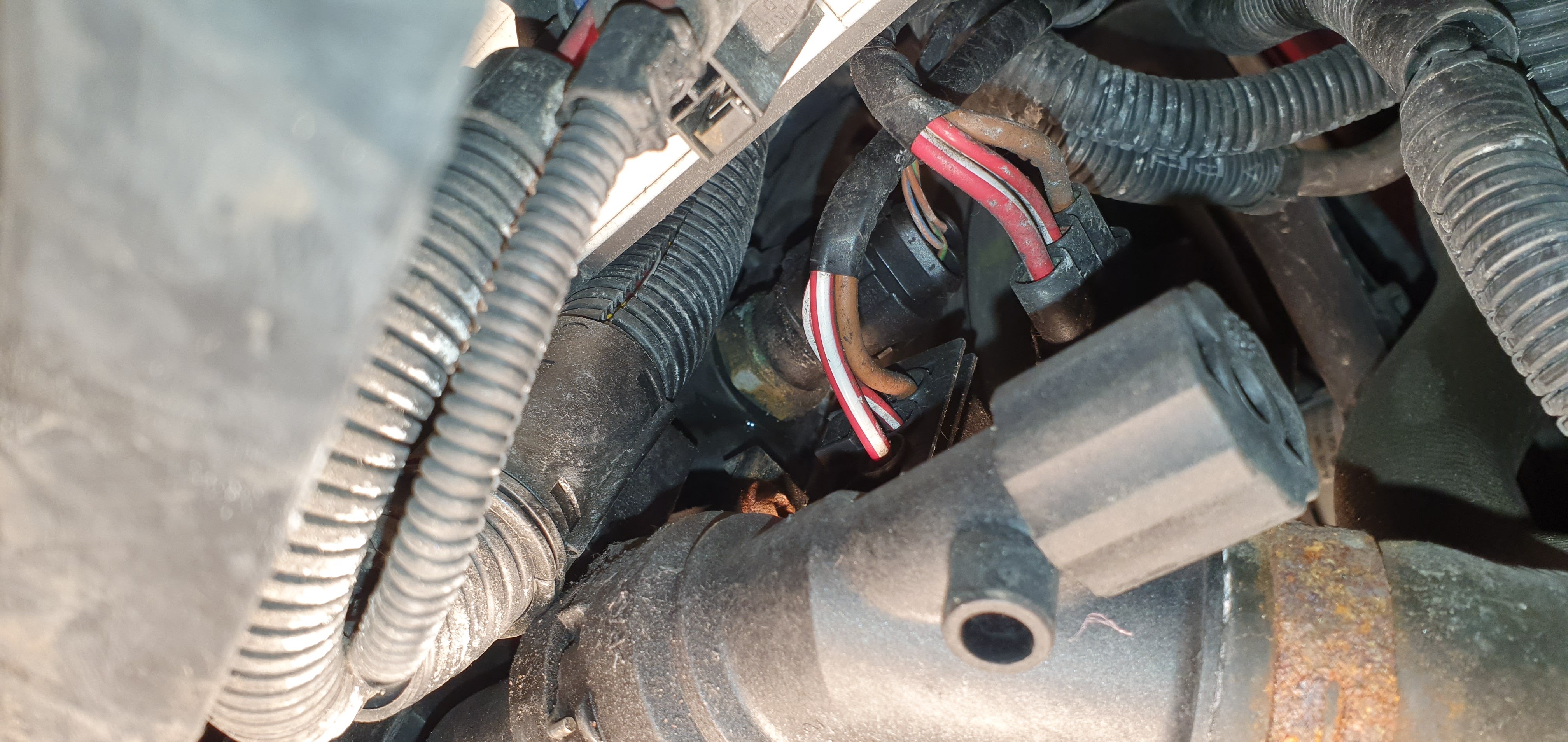

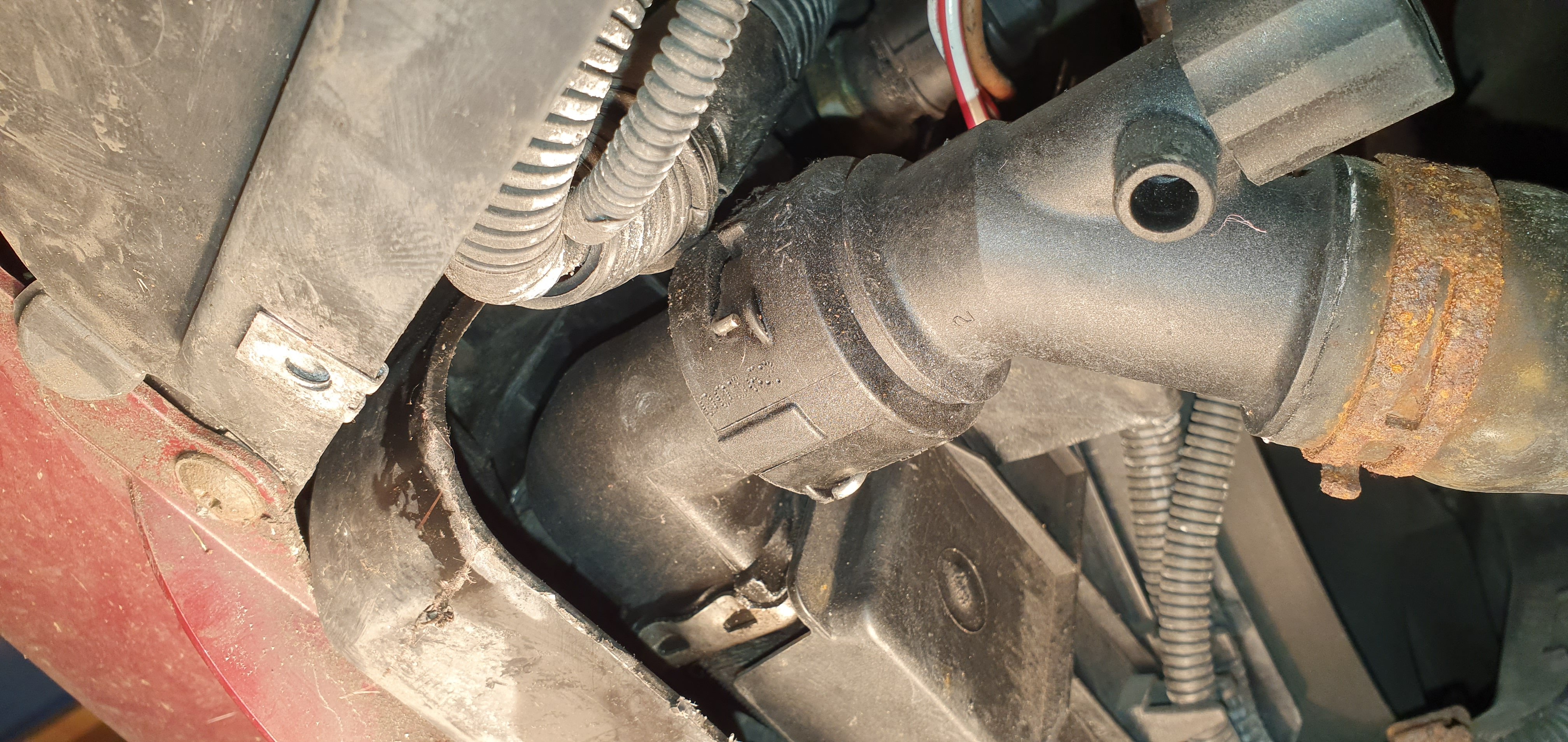

I had the car on the ramps today with the trays off underneath. And I this I may have found where it's coming from. I have attached some pics I have no idea what is leaking possibly a sensor housing in the bottom of the radiator.
The location is at the front left of the car if you were sitting in it at the bottom of the engine bay.
That's the coolant drain tap, it's supposed to look like that.
Look at the radiator corners for signs while the engine is running.

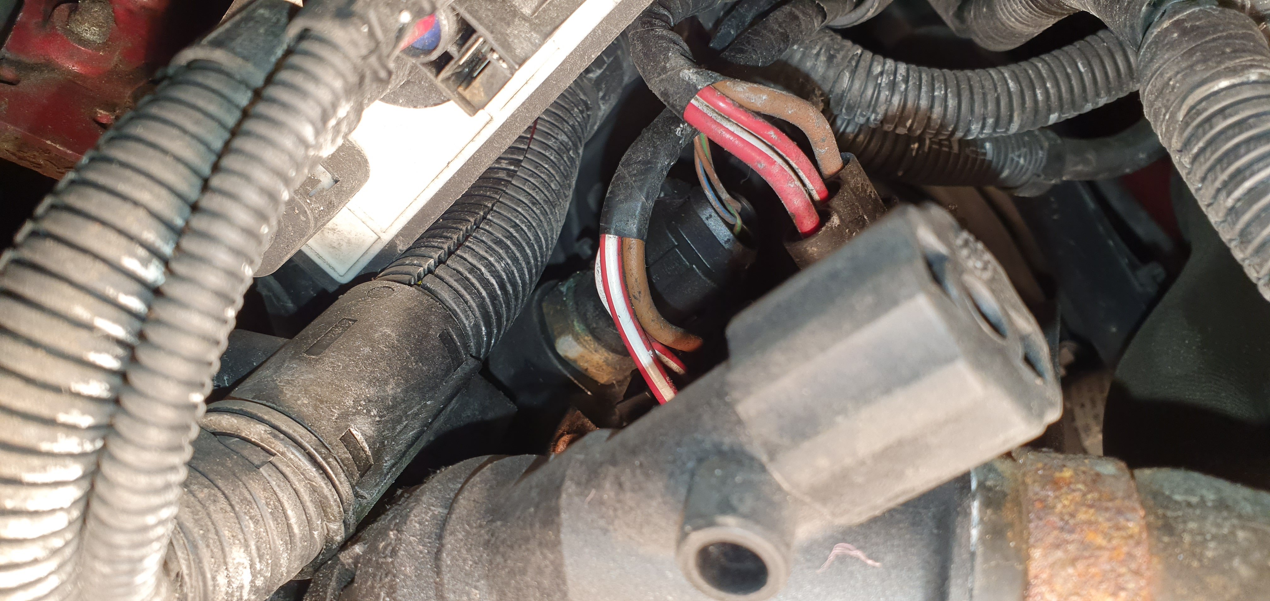

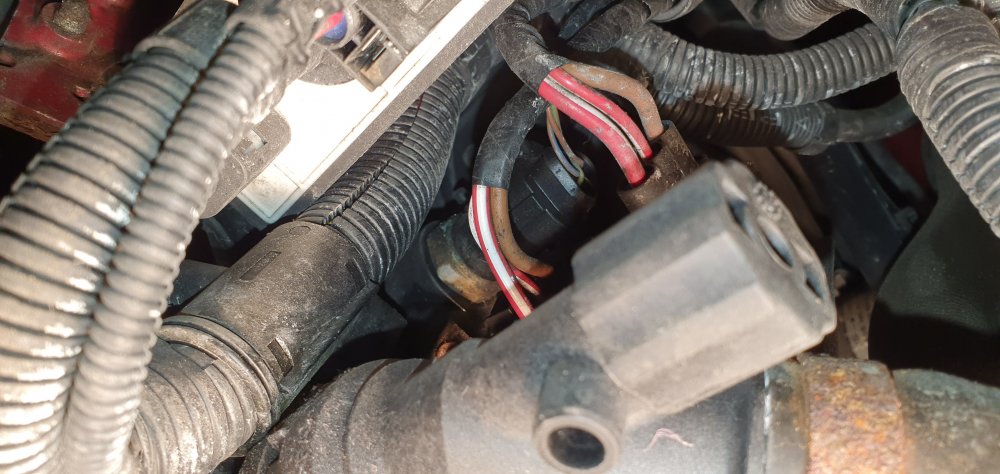

Hi this was after I had dried ot off it seems to be coming from what looks like a sensor in the radiator just above the drain tap.
That's the cooling fan sensor, try tightening it slightly, they leak if loose.
will give this a go do i just tighten with a spanner ??

Whatever you can get on it. Approx. 29mm across flats.

Just pinch the sensor up tighter, the radiator is probably leaking as well.

It doesn't seal on the screwthread (parallel threads rarely/never do) it's the brass shoulder of the thermoswitch sealing agsinst plastic.
Just tighten it to your best guess at 30Nm and watch the problem go away.

29mm deep socket will just catch it after the electrical connector is unplugged.
Or remove the main fan 'tripod' for easier access for a spanner.
