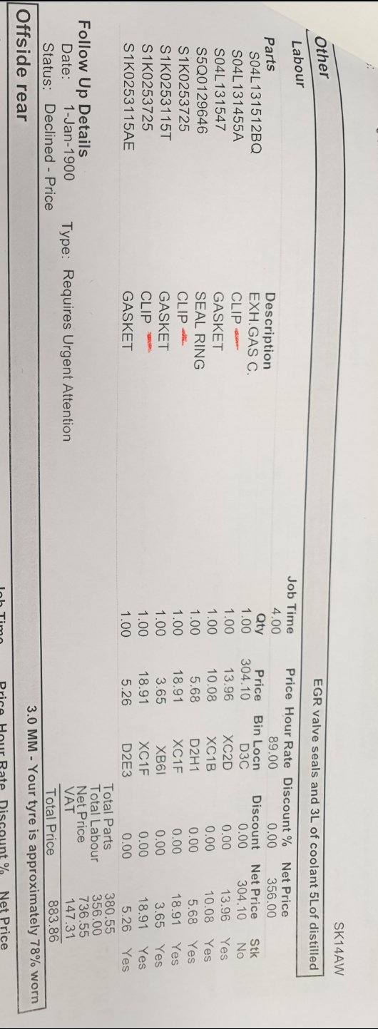

Bit of a back story - car has been leaking coolant and been in to Skoda twice to try and identify the problem. Turns out its leaking coolant internally from the EGR valve cooler. I refused the repair as i simply cannot afford £900 at the moment. Plan was to keep topping up coolant until i can get it repaired.

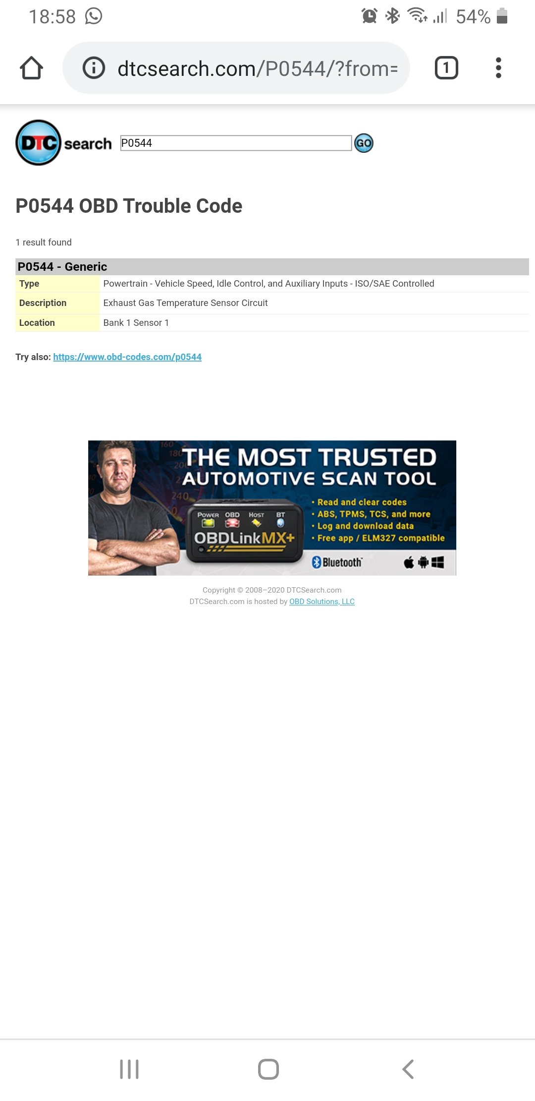

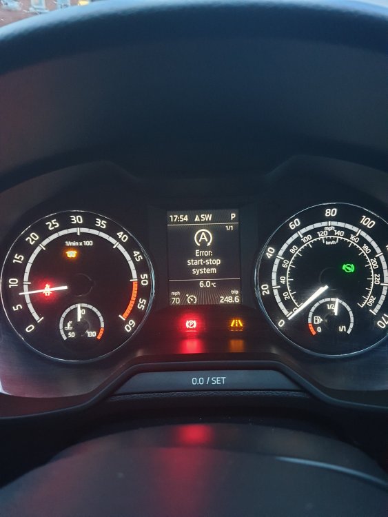

Well that happened and i managed to read a code when the EML was on. Code came back as P0544. Did a search and could only find the code P0546 which had the same description (think its the same error just different for a MK2). I cleared the codes and everything was fine for a day, Flashing glow plugs have come back with a loss of performance - not limp mode but i can notice the difference. To add another layer of confusion, i got a ERROR: STOP / START unavailable a few hours ago.

The actual egr does not cost that much. It is the location that is the issue as you have to remove the particle filter to access it. I would imagine you would get it repaired a lot less by going to an independent garage who know VAG engines.
A genuine egr cooler retails about £300, so Skoda were charging you £600 labour. They must charge over £150 an hour labour as it is about a 3 hr job max on ramps with easy access.

FYI the part is £305. The rest is gasket kit etc and labour @ 4 hours. See attached.
I have found a cooler at a breakers but would still need to buy the gasket kit around £50 and then find a garage willing to fit it so plus that labour...
No. @Dowsett I think that might be a generic error message that comes up when there is a fault. I didn’t have a fault with my glow plugs or stop/start system. A diagnosis of a faulty pressure sensor was the cause of the problem. Felt like the turbo wasn’t working. It is being replaced as I type this. Costing about £200 to have replaced.
