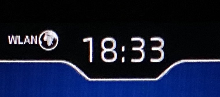

I used to have a globe, and the car icon. Now only the globe is showing, after being at the repairshop. Can some one please explain how to get the location service icon back again ?
Before repairshop
After repairshop

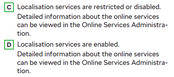

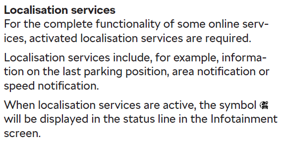

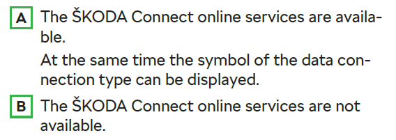

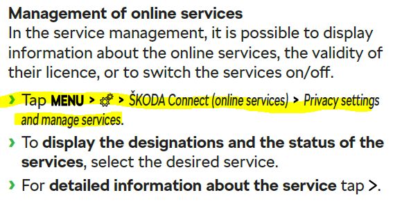

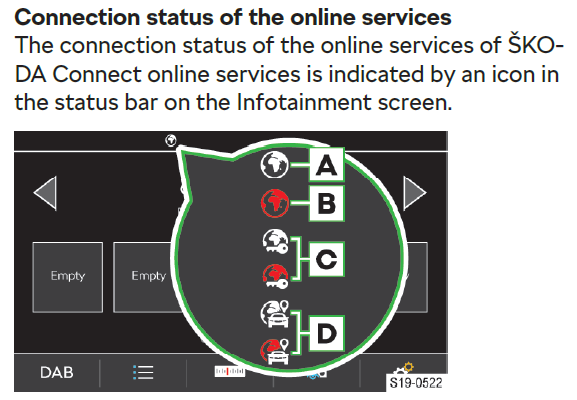

It appears that 'Localisation Services' have been turned off...
Try looking here...

I went to Skoda to ask about this. And they told me that the service was partially down. And today, the icon is back. So that was the reason for my missing icon.
