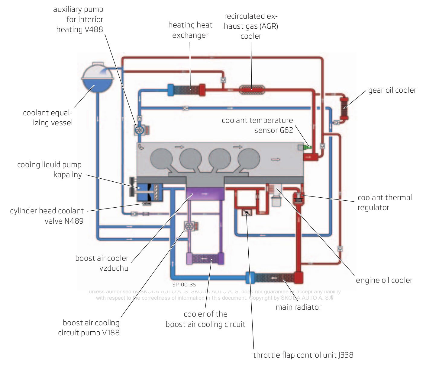

There are three water pumps on a EA288 1.6 TDI engine.
The main coolant circuit is driven by a conventional engine-driven pump.  This (or the sleeve on it) is probably what has failed.
There's a separate electrically-driven pump to cool the turbocharger.
There's a separate electrically-driven pump for cabin heating.

AFAIK, there's a solenoid-driven slide valve/sleeve in the pump which can stop the coolant being pumped through the main circuit.  This is to help with an even faster warm-up.  This seems to stick, and is seeingly the main cause of the overheating issues.
Edited by iriches
2 minutes ago, iriches said:
AFAIK, there's a solenoid-driven slide valve/sleeve in the pump which cam stop the coolant being pumped through the main circuit.  This is to help with an even faster warm-up.  This seems to stick, and is seeingly the main cause of the overheating issues.
This seems likely what my guy was talking about. So, I would guess the diagnostic process should be to check the solenoid first and if that is faulty then replace, it job done.
If solenoid tests tests out okay then sticking sleeve is the likely culprit and that can't be replaced on its own, so pump is replaced.
 From most reports on the main thread on this issue the pump is replaced but I wonder if the solenoid is ever checked? Just a thought.
