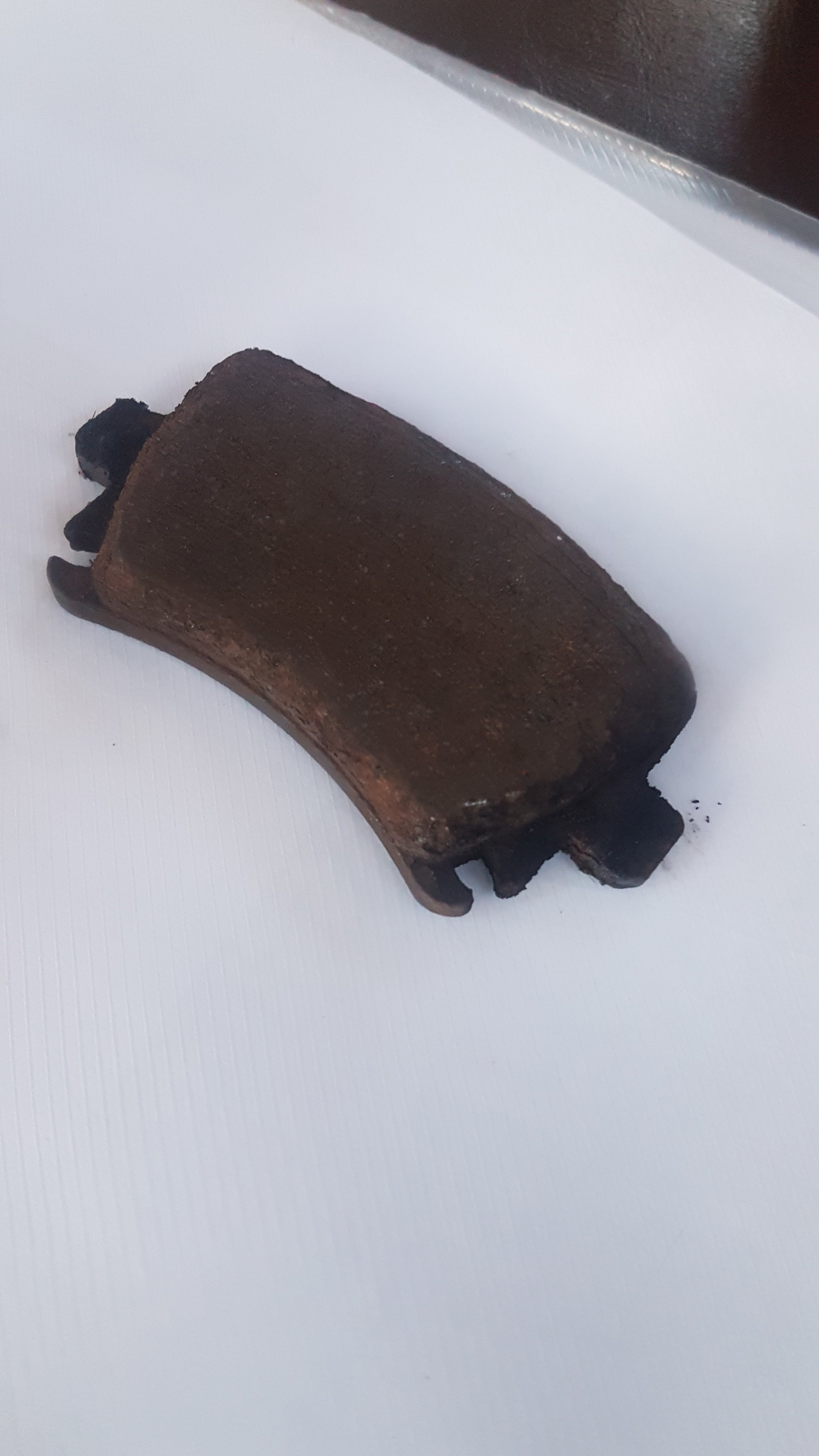

When I examined the offside rear brake pads the pad against the cylinder was much more worn than the outside pad and its edges were all rounded. I replaced the pads and ensured that their edges were lubricated with silicone grease.

Probably a seized caliper. The caliper is designed to float on a pair of pins so that it can center the pads on the disk. Those pins can get gunked up and seize causing the sort of uneven pad wear you're seeing.

I cleaned the back of the pads and the shims they slide in and lubricated with copper grease. So we will see if the squeal stops.
