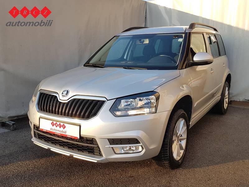

Hi. I am looking to buy yeti facelift 2015; 2:0 TDI 81 kW, but i dont know ehich engine does it have, old EA189 or newer EA288; i dont want old CFHF engine in description says euro 6 but no bluemotion mentioned.. here are pictures if ayone knows it is in another town and owner dont know .

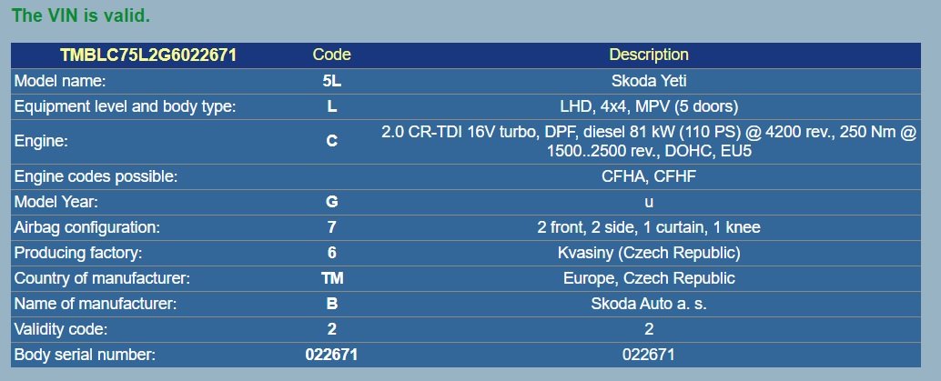

and i found vin number, how can it be seen fro VIN?
VIN is: TMBLC75L2G6022671
found something.. it is euro 5 engine. old one..

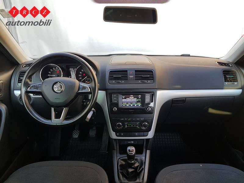

It seems to have lost one of its curtain airbags too 🤔
Sure? It is Ambition version. Maybe have one. This is free VIN checker, maybe all data is not accurate..
