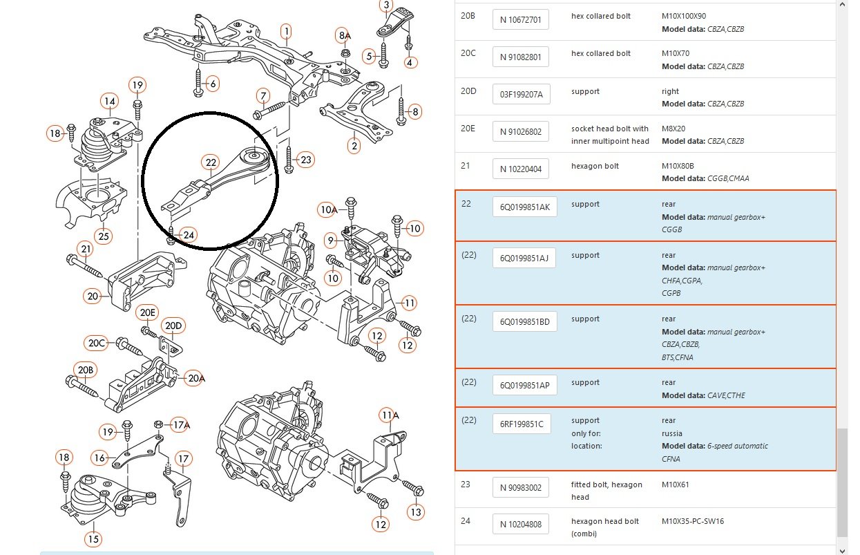

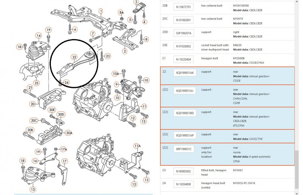

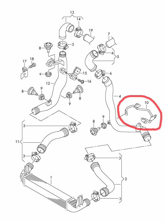

I currently have a decat and I believe & hope the retaining bar was removed when my cat was removed and hasn't fell off but ive looked into the circled part below and it could be the answer to the knocking:
Seen more cleary here:

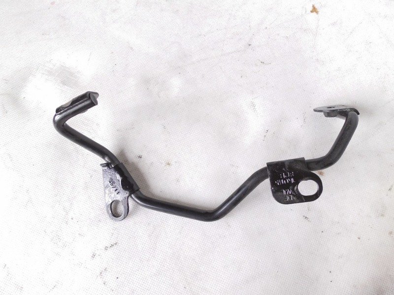

eng_pl_RETAINING-BAR-VW-AUDI-SEAT-SKODA-1K0145812B-18957_1.jpg.ada2f34ff5e299fb0a05c13b9a49b215.jpg
The above part bolts onto the intercooler pipe so I'm hoping that's my issues.
My only other issues/worry is that it could be a gearbox mount as I can literally feel the knocking thorough my pedals when in revers and it sounds and feels lits coming from under the diver side cab or behind the pedals.

Is it not more likely to be something like the rear engine mounting / support??
Would you really feel that intercooler pipe through the pedals???
I’ll hopefully get a look at the weekend as I also suspect it’s the dog mount/bush that’s gone. I was reading back on old posts that the diesal Fabia powerflex was a decent upgrade?
