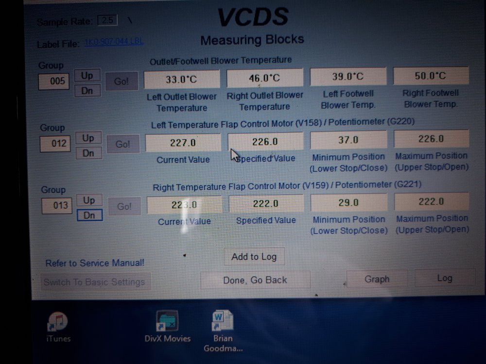

Plugged in vcds and came up with this a don't no if this will help or shed some light on the situation but any advice will be much appreciated thanks.

What is strange is that both temperature flaps for each side are indicating fully open but as you can see the temperatures are a bit apart (might be one stuck or might need re-calibrating) Did you make sure the vents on each side were fully open to make the airflow as equal as it could be?
What you haven't got on there is the actual cabin temperatures that the control system would be trying to control to.
Have you tried putting it back to single zone so its just controlling off one temperature, put it on Auto, and see what it does then?
a have tried calibration a few times to no avail.
the cabin temperatures a could try and get tomorrow ?.

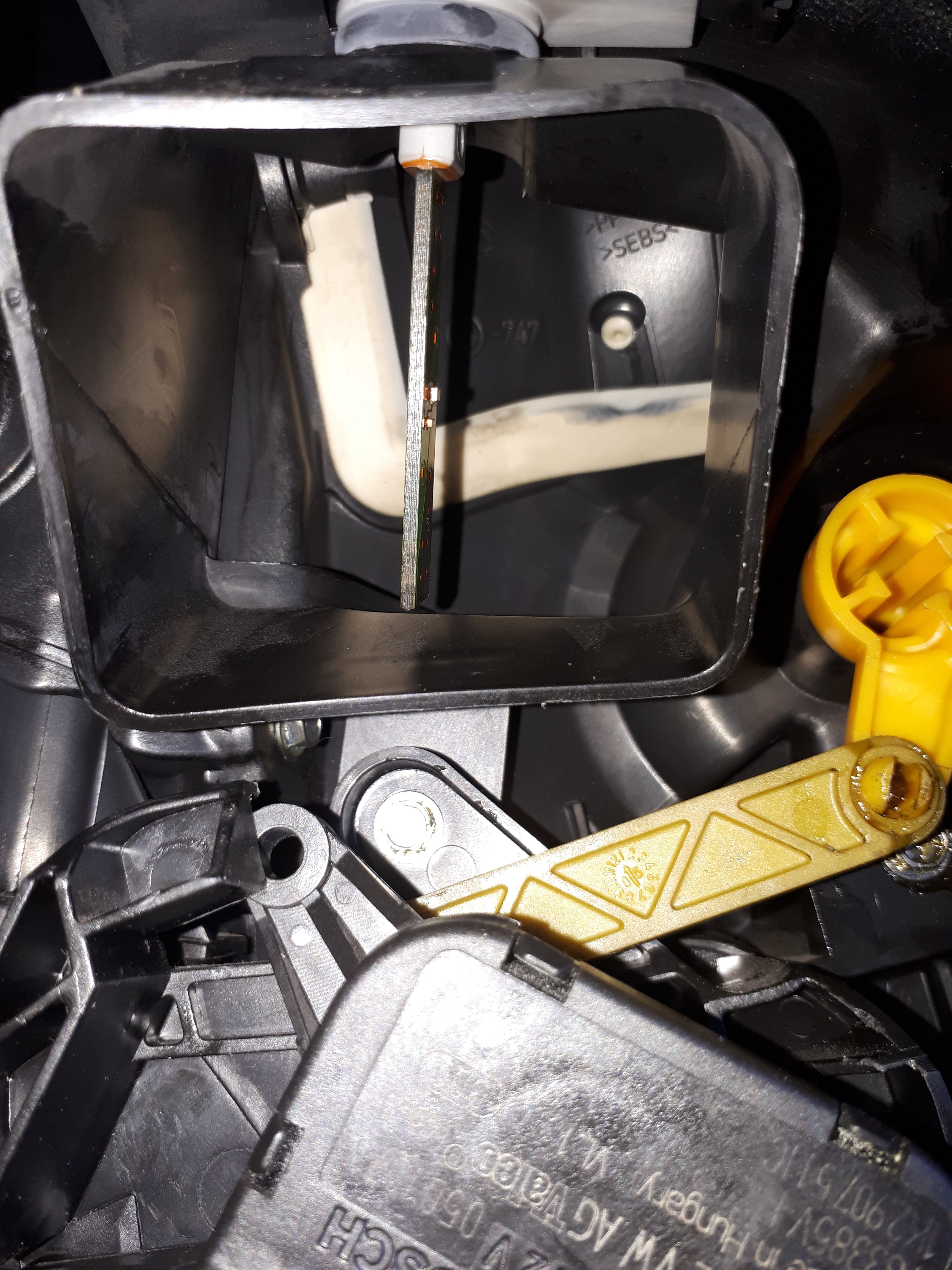

If lets say the passenger side heat exchanger flap isn't opening fully obviously that would cause this situation am only asking because when a looked up into the footwell tube were the sensor the circuit board hangs down the flap was hitting the circuit board and only going up half way as in not fully opening but a don't no if this is right or wrong .

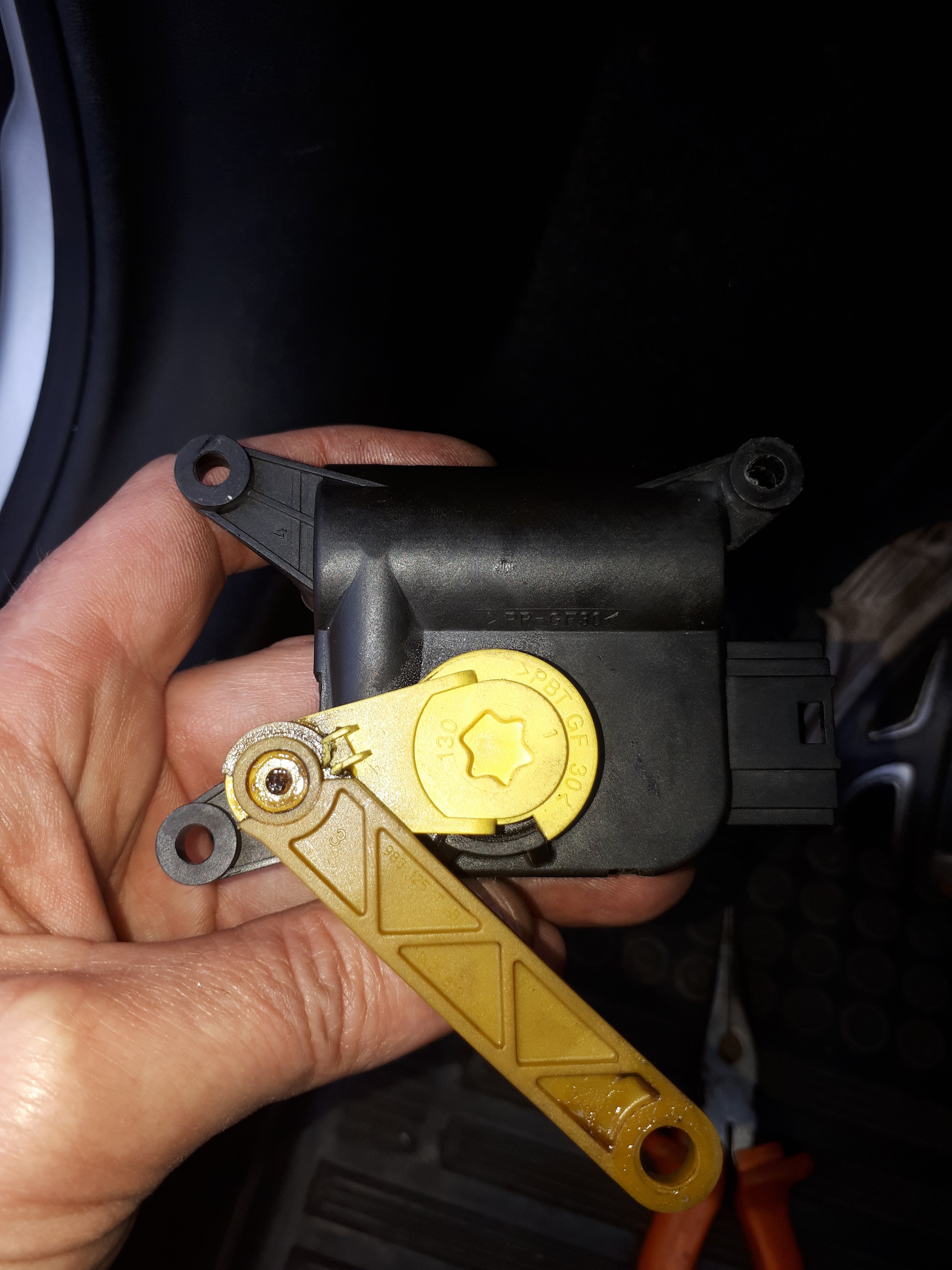

all this has stemmed from removing the heater matrix as i had to remove the little motor off to get it out .
Sounds like you have not got it back together quite right, is the flap free to move fully shut to fully open
is that with or with out the motor connected to be honest a have not touched the flap with me fingers as of yet
This is the motor am talking about 20200403_170419.thumb.jpg.c3e9bb971fede8ca92dc283ad3d6a2d6.jpg

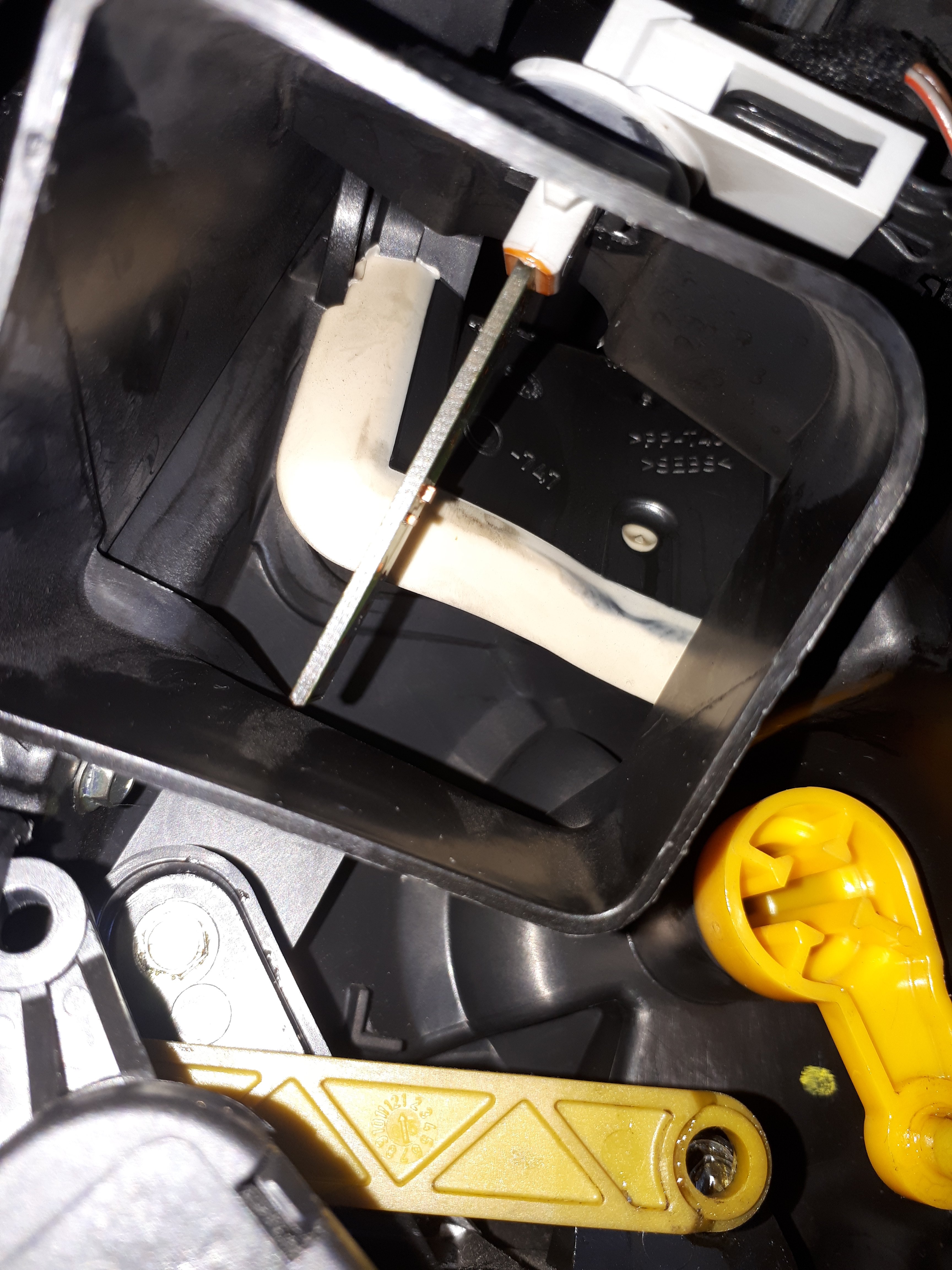

So been out and took some more photos just to ask if things look right.
The first photo is flap closed and the second one is open
