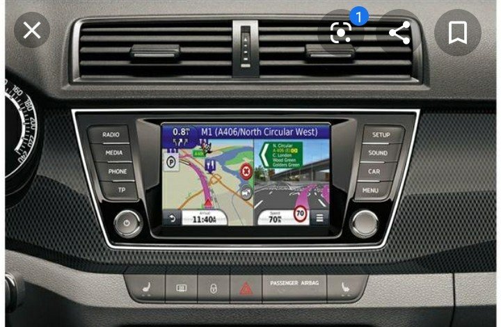

Hi Laurent, from your 2nd picture you have the same entertainment system as mine - except you say that you do not have navigation - although that looks like a Navigation screen showing in the picture.
 - Each button press is single press only.
On the right (Droit) side of your screen press "CAR"
- On the "GreenScore" screen that then displays press the gear symbol at the bottom-right corner.
- This displays the Vehicle Settings screen. (ESC, Tyres, Driver Assistance, Parking Assistance Etc.
- Scroll down to option 7 - "Opening & Closing" Press button, which will display an option for "Window Operation" - "Convenience Opening" - options for "All windows"; "Driver window" or "OFF"

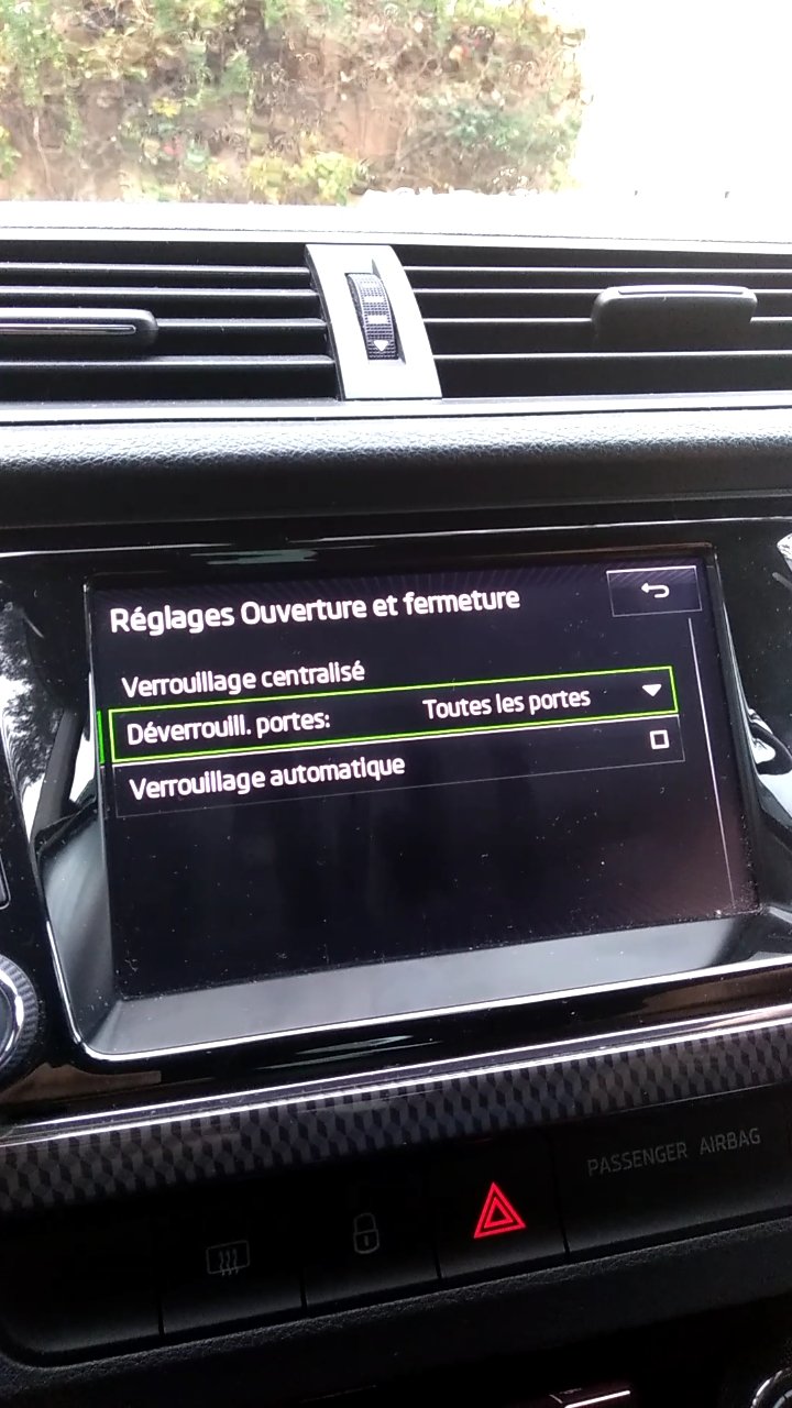

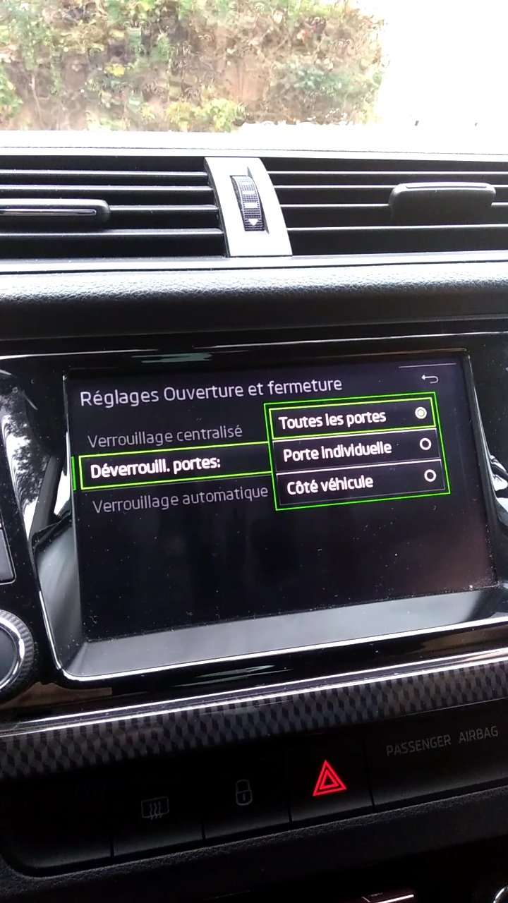

bonjour, voici les photo des paramètres que j'ai trouver
Oui Laurent, correct selection as per 1st picture. The selection says "portes" (Doors) is there another menu further down that says "WINDOWS" in French?

hello, there is no menu with "window" the only menu I found is on the central opening
