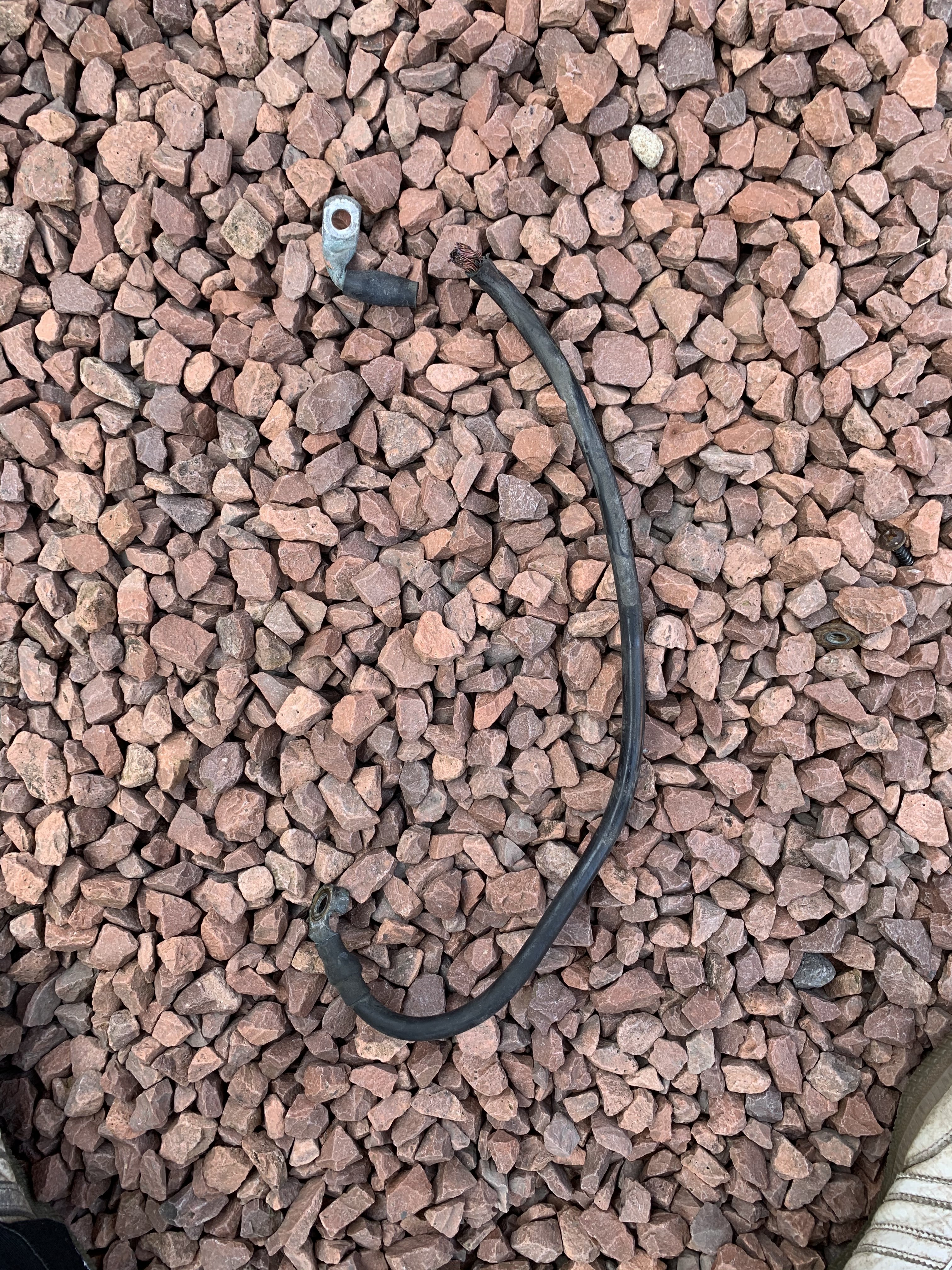

finally found my starting issue earth strap from top of the starter has snapped clean at the end🙄. I could split the crimp and red do the end but there are a couple nicks else where in the cable I’m not quite happy with.
just wondering if someone could point me in the right direction of a replacement or even what type I need to look for? Will any earth strap do or does it need to be a certain capacity. Thanks in advance.😃

There may be a part number printed on it, if you clean it up?
Minimum 25mm squared conductor area I think, possibly 35mm.  That may also be written on it.
Thanks Wino, I’ll give it a clean and see if I can find any.
Thanks Nige I’ll have a look!
found this Vw auk 6Q0971537N 4902DE but a search doesn’t provide me with anything.
