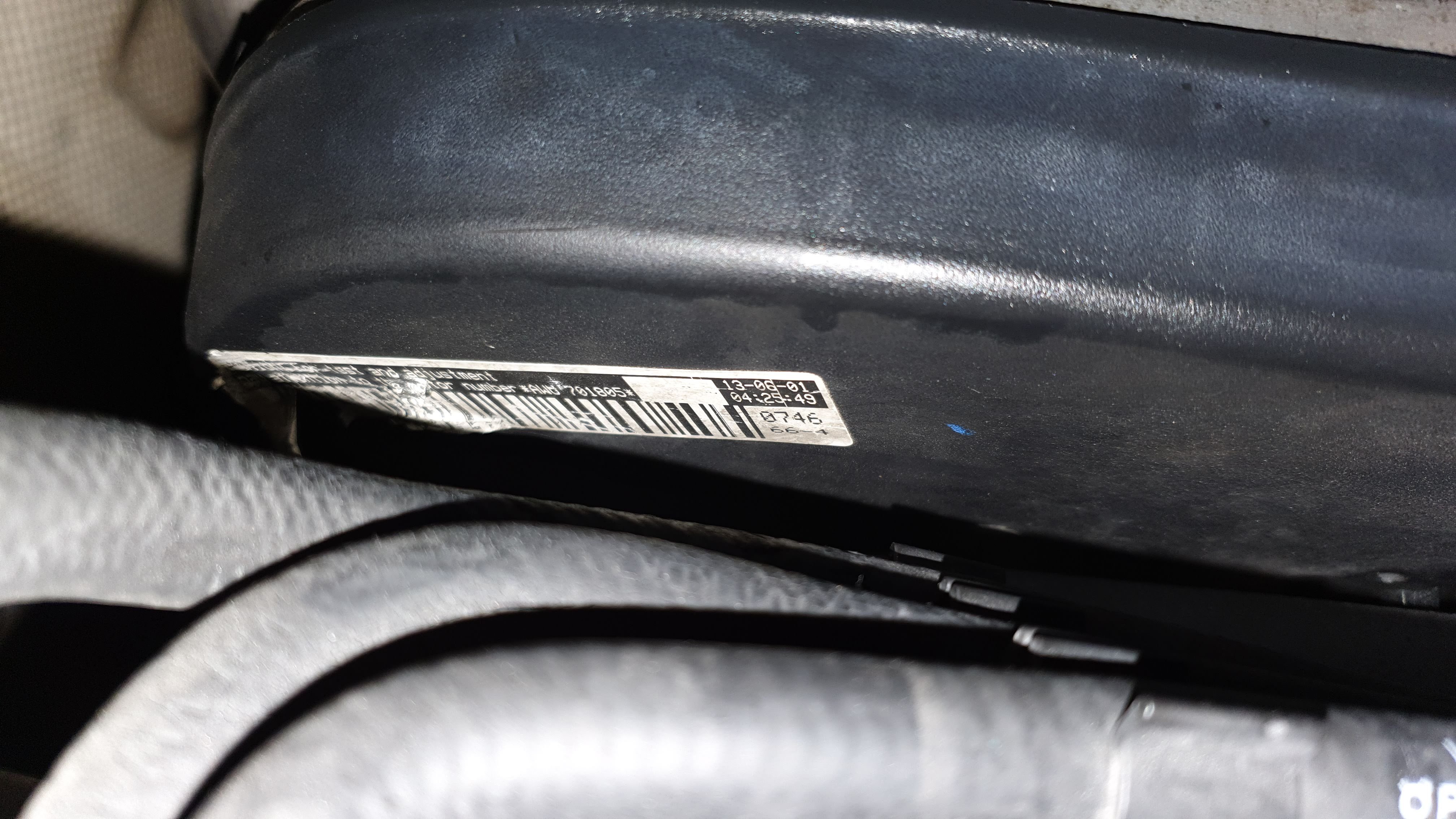

I need a Help, I can't understand what the code for my engine, anyone knows the code on this pic ?

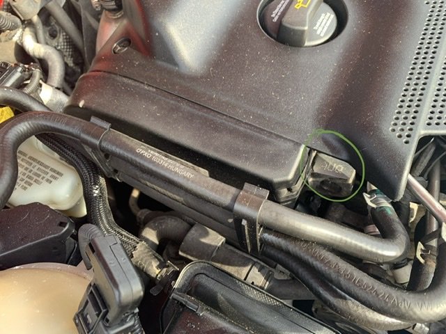

  • Administrators
@mfo
You’ll see the engine code to the side of your cam cover.
As highlighted in green. If you have a 1.8T MK1 Octavia it’ll be AUQ.
P.S. You don’t need to keep quoting text. We’ll see the messages and it saves a lot of scrolling. 😝

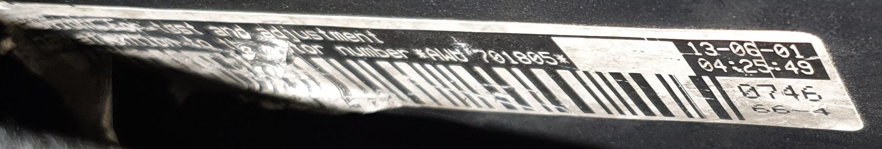

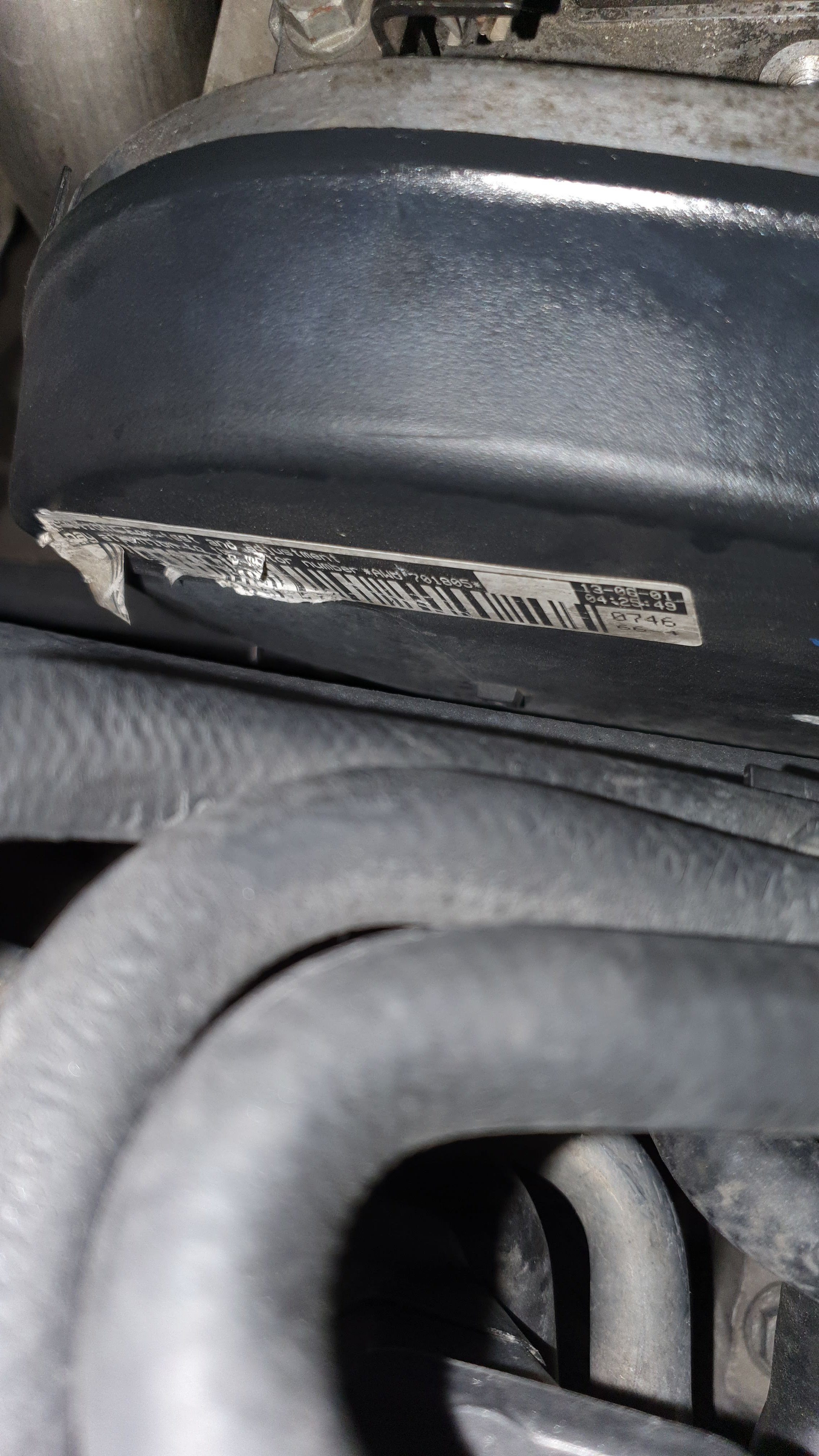

I can't see in my car, the only place is the timing belt cover.
That's the engine code AUQ fitted to tbe 1.8 t vrs occys.  180 bhp engine.
Realy, I didn't understand the letters. Itś AUQ ?
If you google VAG engine codes, there will be tables to identify which cars were fitted with this engine.
I saw alot of tbles, but I thinking this letters was not AUG !! I know that the most Drive by wire is 180 CV's.
