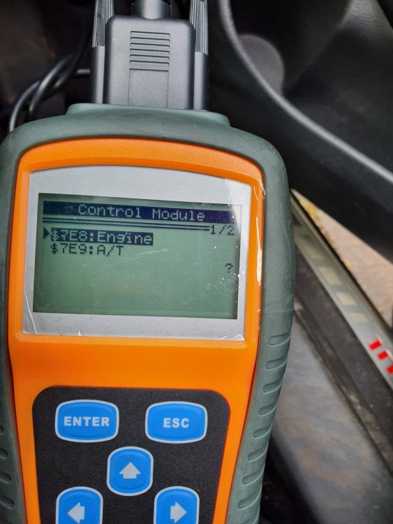

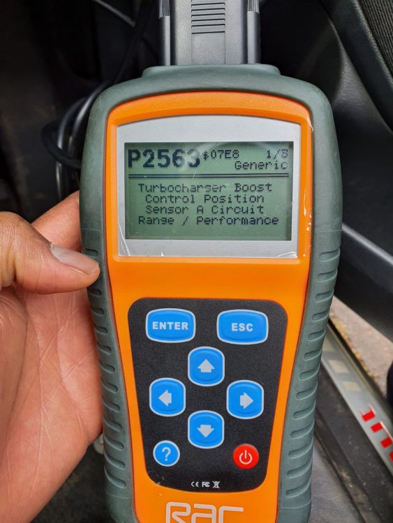

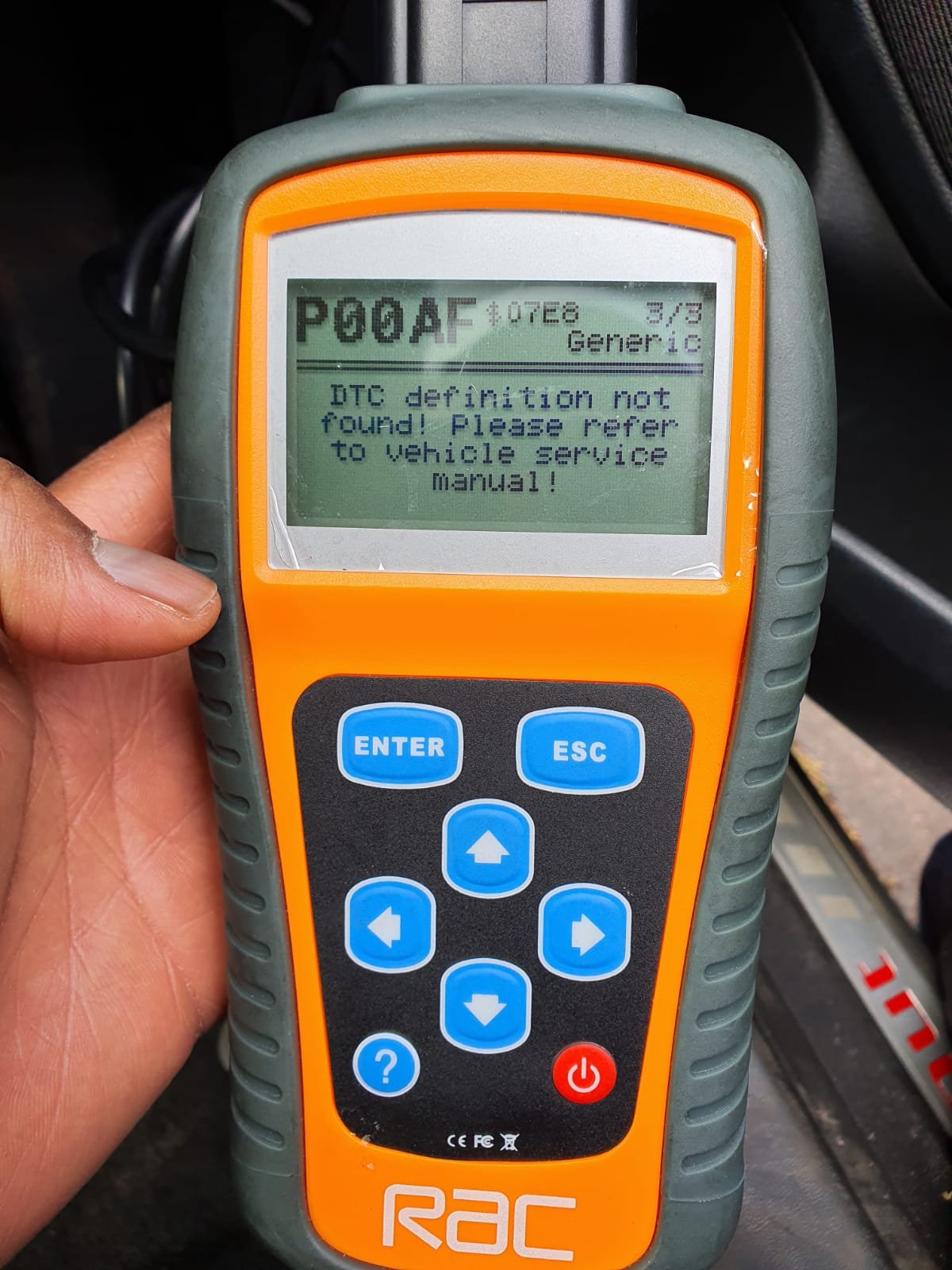

I need a bit  of. help or advice with my Skoda octavia scout 2012 model. I used a basic scanner and found these. in in a limp mode and the DSG gears slip. revs up to 3000revs and loss of power on steep slopes. attached is a picture of the scan.
