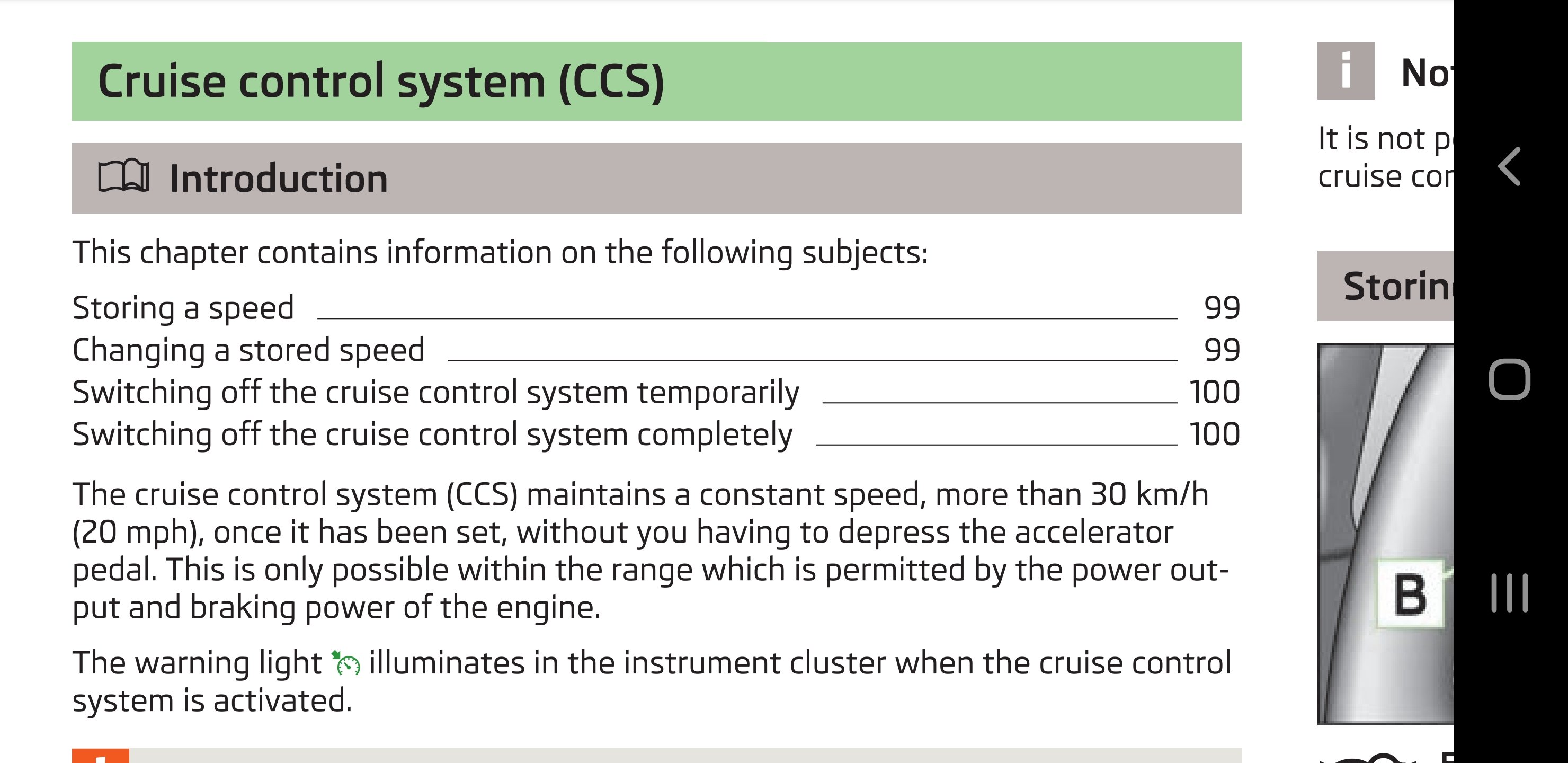

On my 2010 FL Octy Scout when activating cruise control via the rocker switch on the end of the right hand stalk the green symbol as indicated at the bottom on the attached image would display (IIRC) on the upper central  instrument  display on the dash.
It never indicated the set speed,  just whether CC had been activated or not; it lit up green when active,  and didn't show anything when off or deactivated.

No I'll not see the speed, but in my case there is no LED activated. Hope I can change it in EEPROM. Or I'll buy another Instruments Cluster that will have this functionality.
There is no LED to illuminate on my 2006 model, I doubt that there will be on your 2007, I presume it was brought in with the facelift model.
