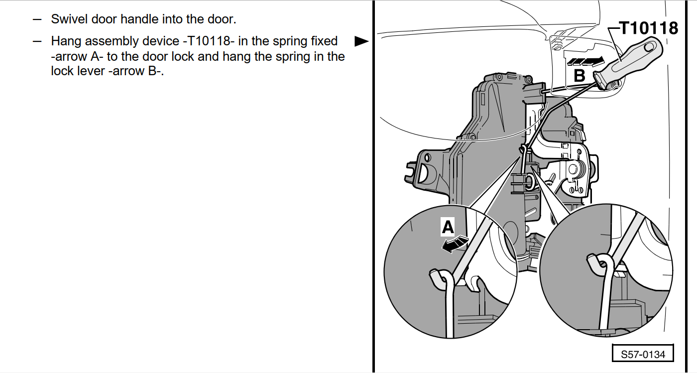

For what I read sounds like you need to locate the pre-load spring in the correct slot. Happened to me and thought it was a stretched cable, inner handle was loose and outside handle rarely worked, until I read the workshop manual about the little spring thingy. Putting it in the right place solved my problem.
The bad news is, you'll need to re-do everything because relocating the spring is easier with the door lock out. It is possible to do it with the lock installed but you need the right tool and you risk damaging your window since the spring holds quite a bit of tension and snaps easily.
Hi juanse-2691, thanks for your info, am not going to re do things at the moment as the door lock works ok, of course my door is the riveted version being a 2006 so not as easy as the bolted on ones.
