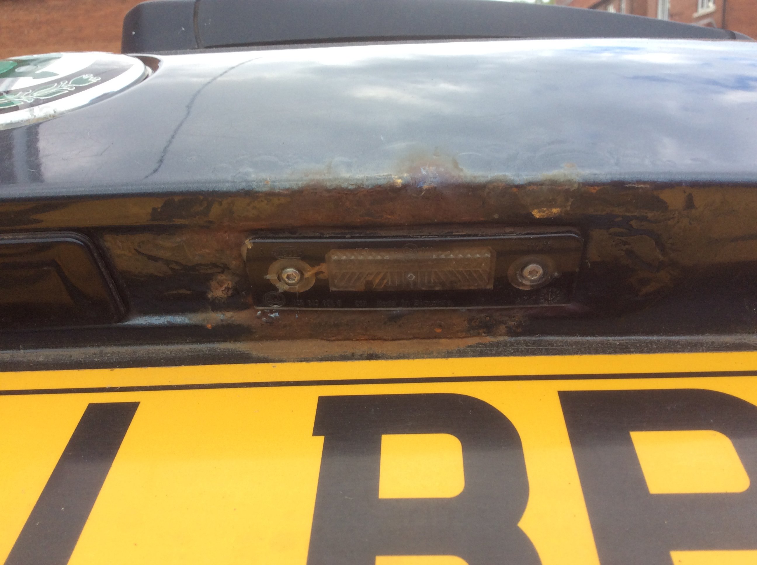

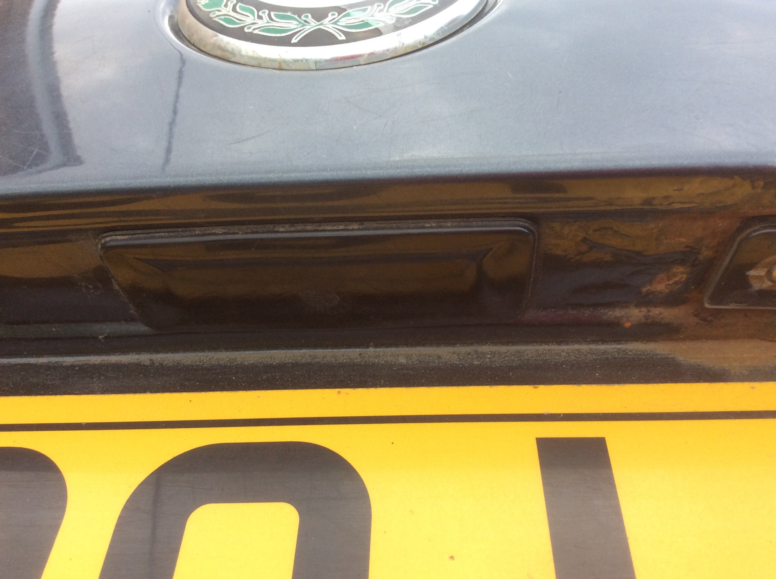

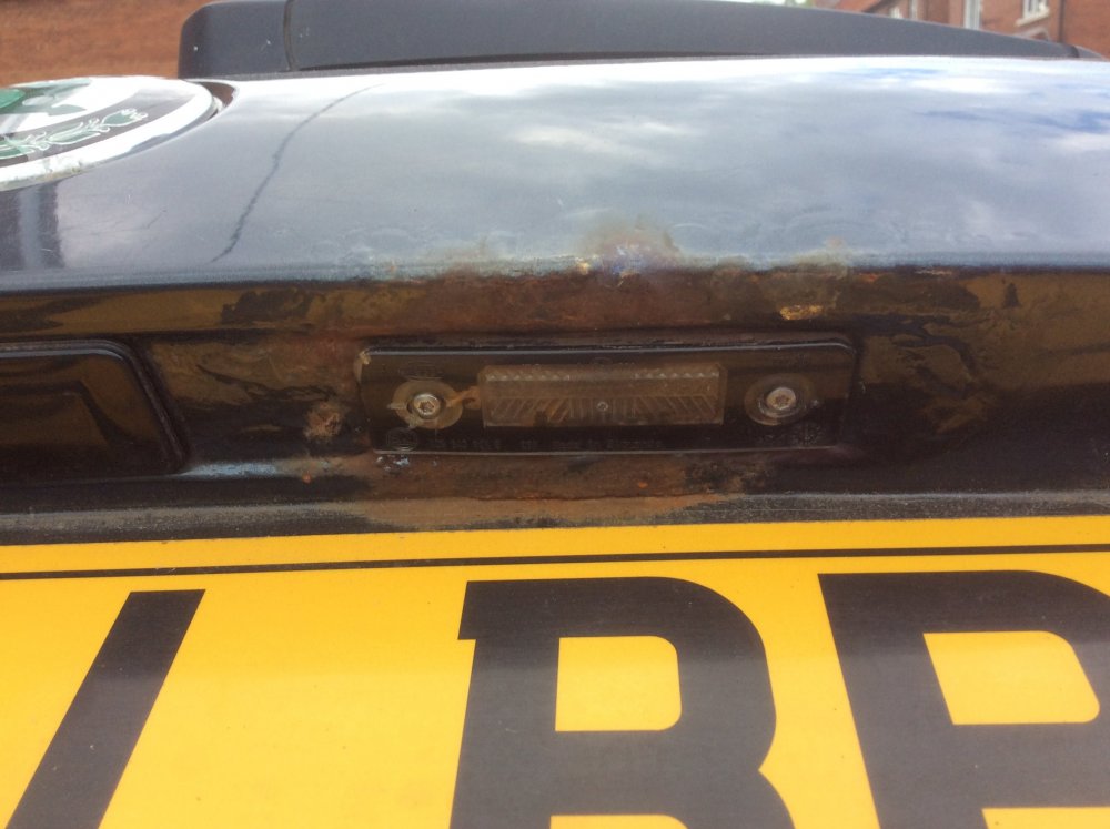

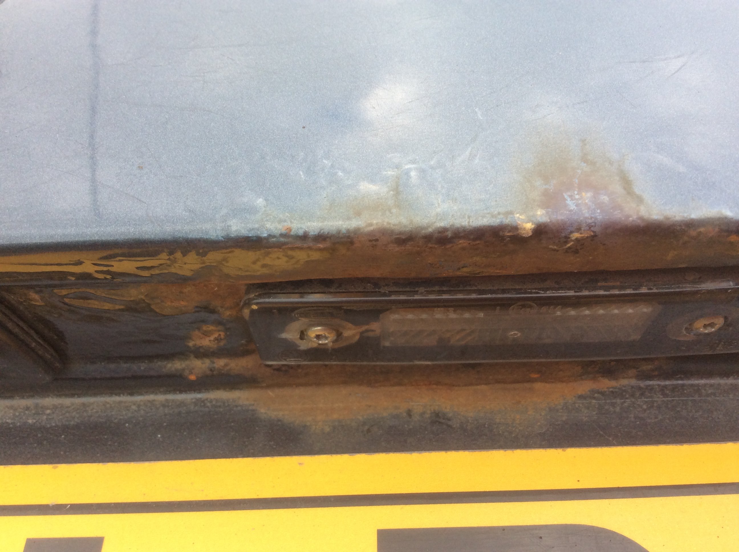

Hopefully attached photos give indication of rust around number plate lamp and surrounding area ( I swear blind that wasn’t there end of November and it’s now twice as bad since my cancelled appointment March 26th with Skoda ( fair play garage closed due to Coronavirus )
now would that be a diy fix ( my concern is the light won’t refit after removal, if it ain’t rusted into place of course )
Yes a simple and easy fix, most of the repair will not be visible.
The challenge is to do it so that it never ever returns & that is probably unrealistic, it may take some touching in every couple of years but anyone having had it done under warranty by professional repairers have had to put up with that anyway.
J.R.
your confidence is contagious and I’m seriously thinking of giving it a go ( not something I’ve done since I had teenage spots but I’m guessing the principal the same ) but I’m really concerned with the refitting of the light, the area around it seems to be getting worse day by day tbh.
I can’t see any point in waiting for an official Skoda examination who knows how long before the lockdown is relaxed enough for the dealer to reopen
Had my lights out several times while fitting reversing camera etc and really cant see that it will give you any problem, I think the screws go into plastic inserts (to prevent corrosion 🤣) so should come out no problem at all.
You could not really wish for a better hidden area for doing a rust repair.
Looks like it extends slightly above the reveal onto the visible vertical section, I think I would do a compromise repair on that bit and simply remove the flaking paint, neutralise the rust and touch it in, looks like metallic paint and if you grind back and feather in it will become a big visible repair. Same deal for the vertical part above the number plate, if that doesnt look good you could always fit one of those black number plate surrounds.
The worst bit underneath around the number plate lights you can really go to town on so I would start there and not touch the visible vertical parts till you have the confidence and experience.

I dont actually think that is a seam at all let alone a welded one, my Octavia is across the channel so I cannot check but I'mpretty certain.
In any case I would set to the rust with a wire cup brush in an angle grinder after removing the number plate lights & release handle & then you will see what you are dealing with, I'm pretty certain its only surface corrosion albeit quite deep.
Granted without shotblasting & proper surface preparation you can never guarantee that you will never see a speck of rust re-appearing but thats a whole different ball game to a seam that is rusted internally and will always weep.
I really think its a very easy repair, often the anticipation of these things is much worse than the doing, most of the time its better just to dive in and see whats what.
