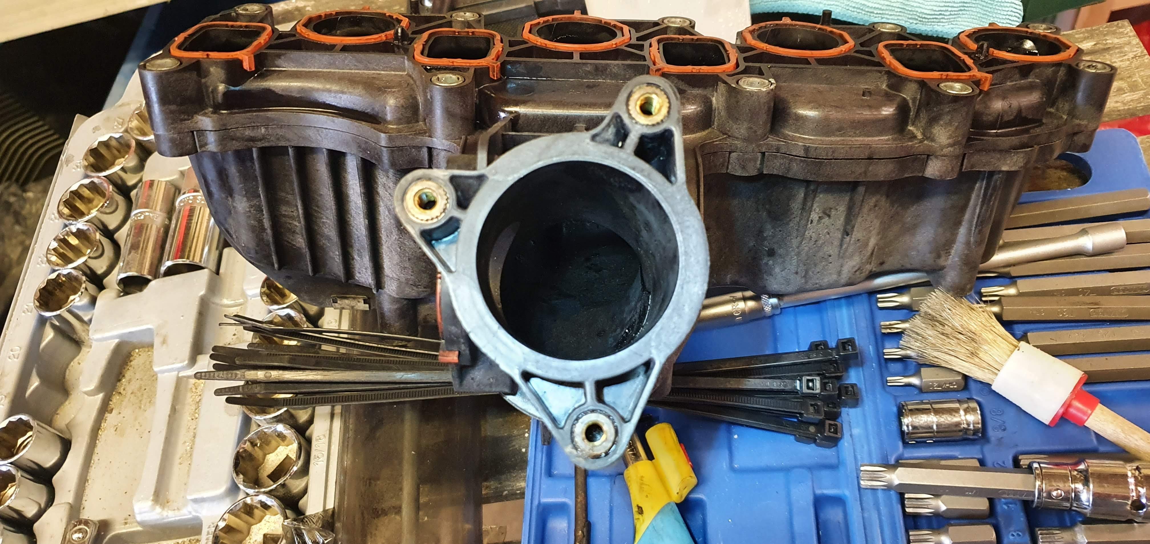

Intake Manifold at 100k

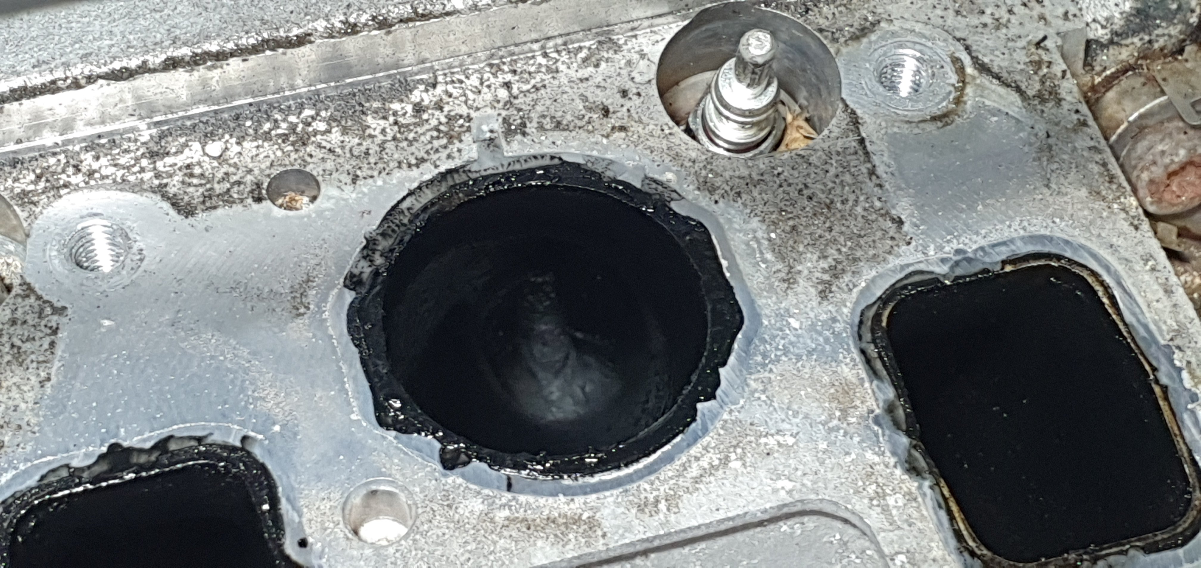

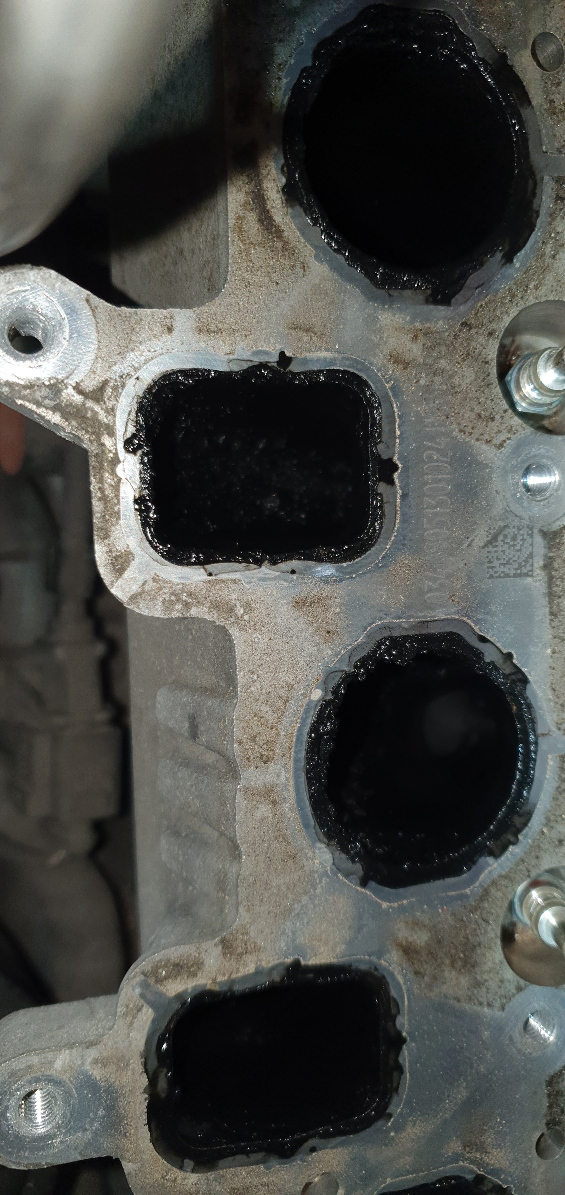

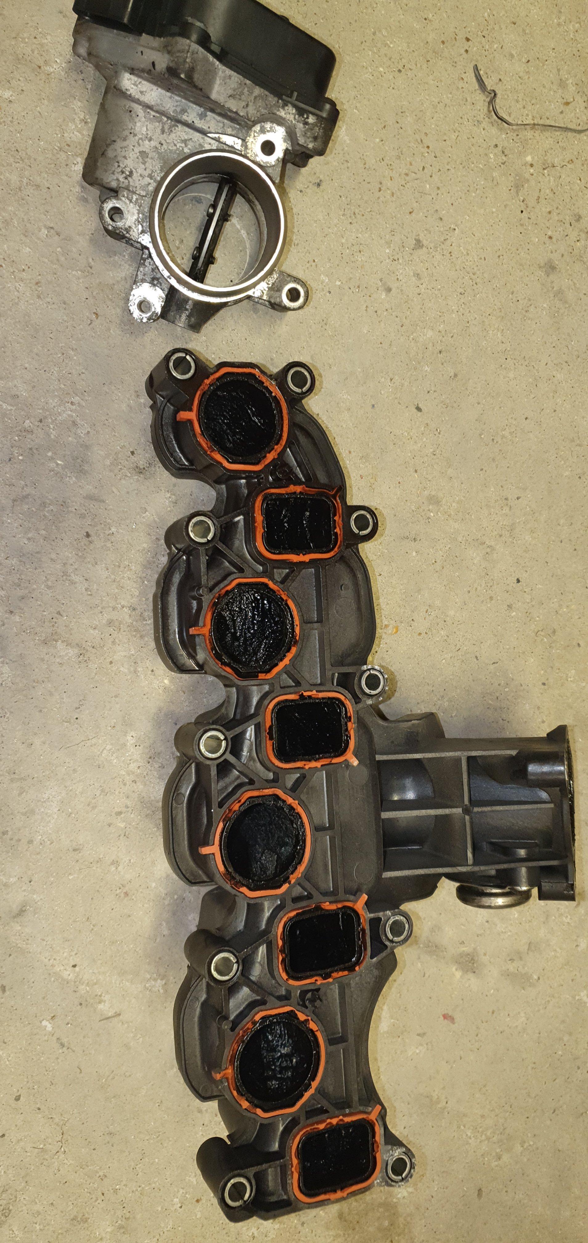

Nothing new probably, but this is what an intake looks like at 100k miles driven 90% on motorway and premium fuels only. It will be fun cleaning this as stuff. The throttle body I've cleaned it before hand.
#bored #willitstart?
all thanks to modern engine EGR systems.
@Bertie90
What premium diesel do you buy, is it Shell V-Power ?
shell v power, and bp ultimate. It doesn't matter as long as the egr is still in place.

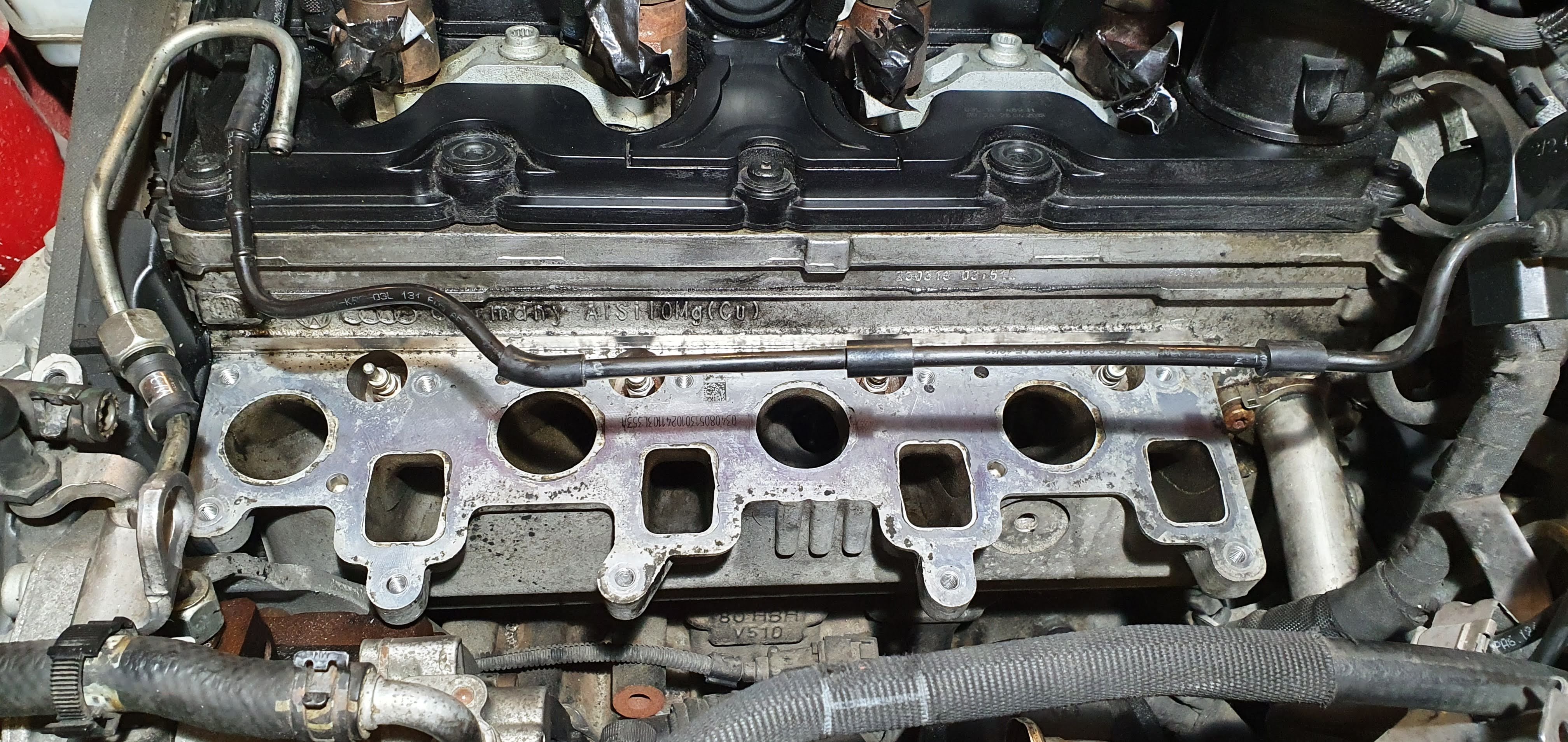

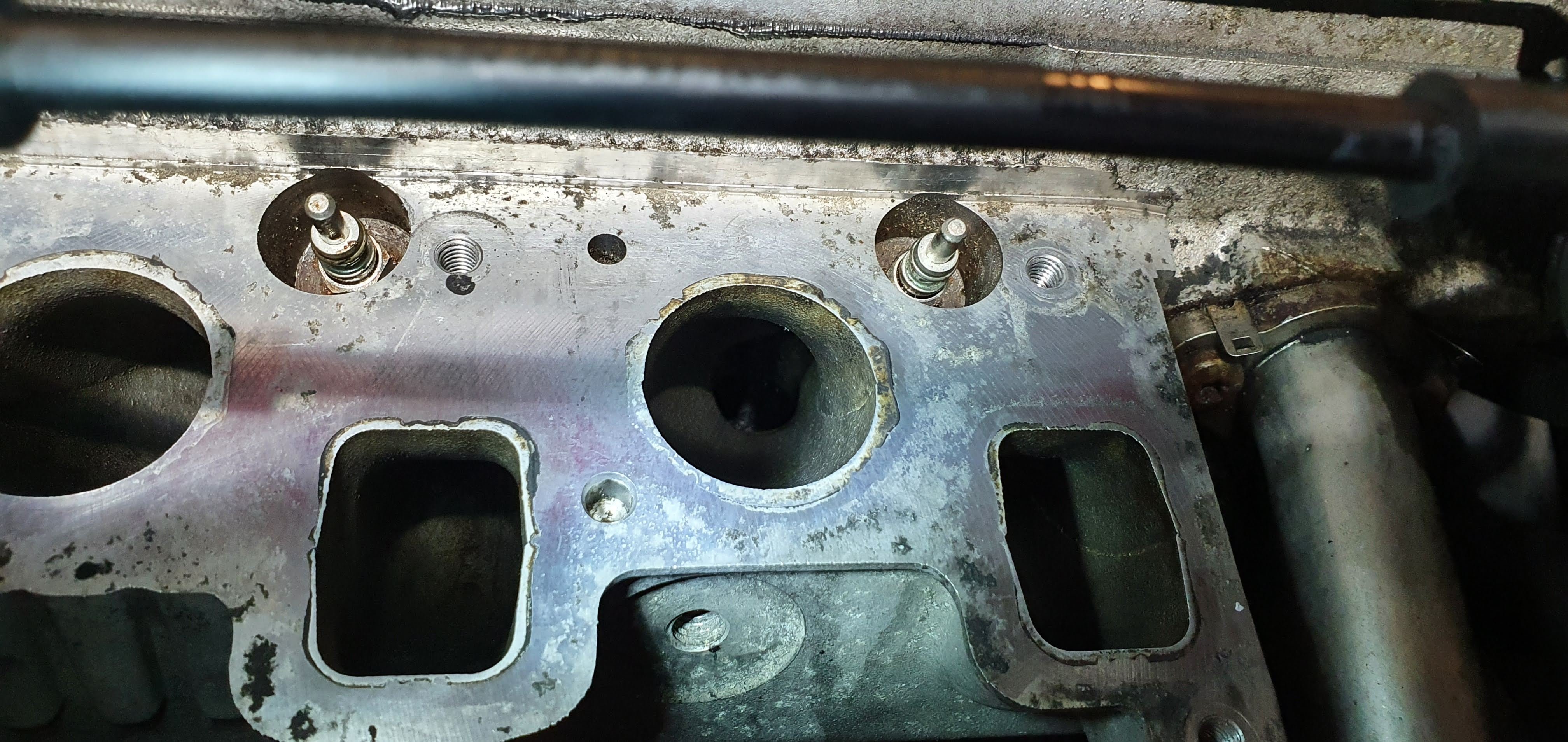

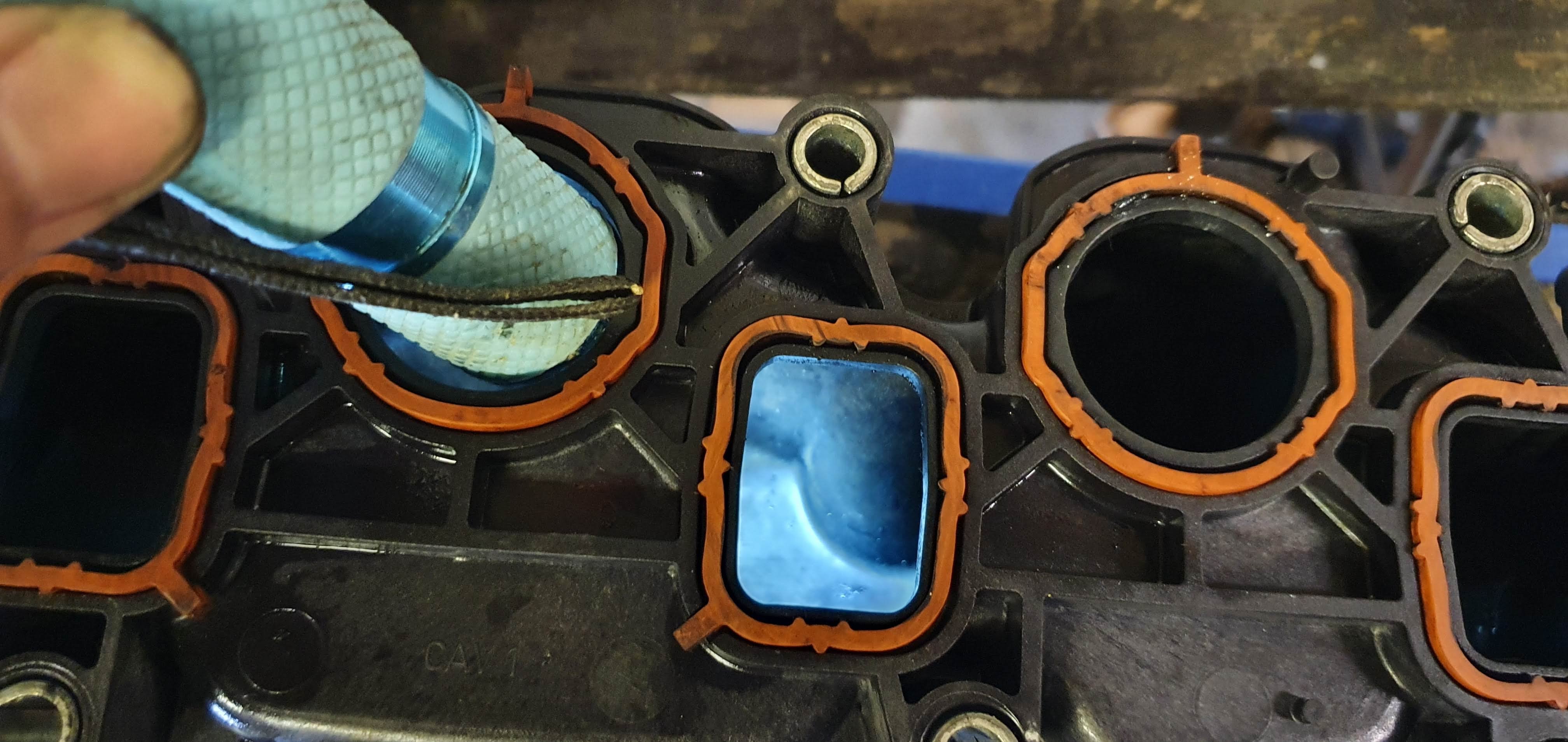

cleaned it as best as i could
Update. The car feels a bit faster and responsive. I noticed in 3rd and 4th it pulls a bit better now. Don't know about MPG yet as I haven't done any journeys or filled up for about 2 months now.
