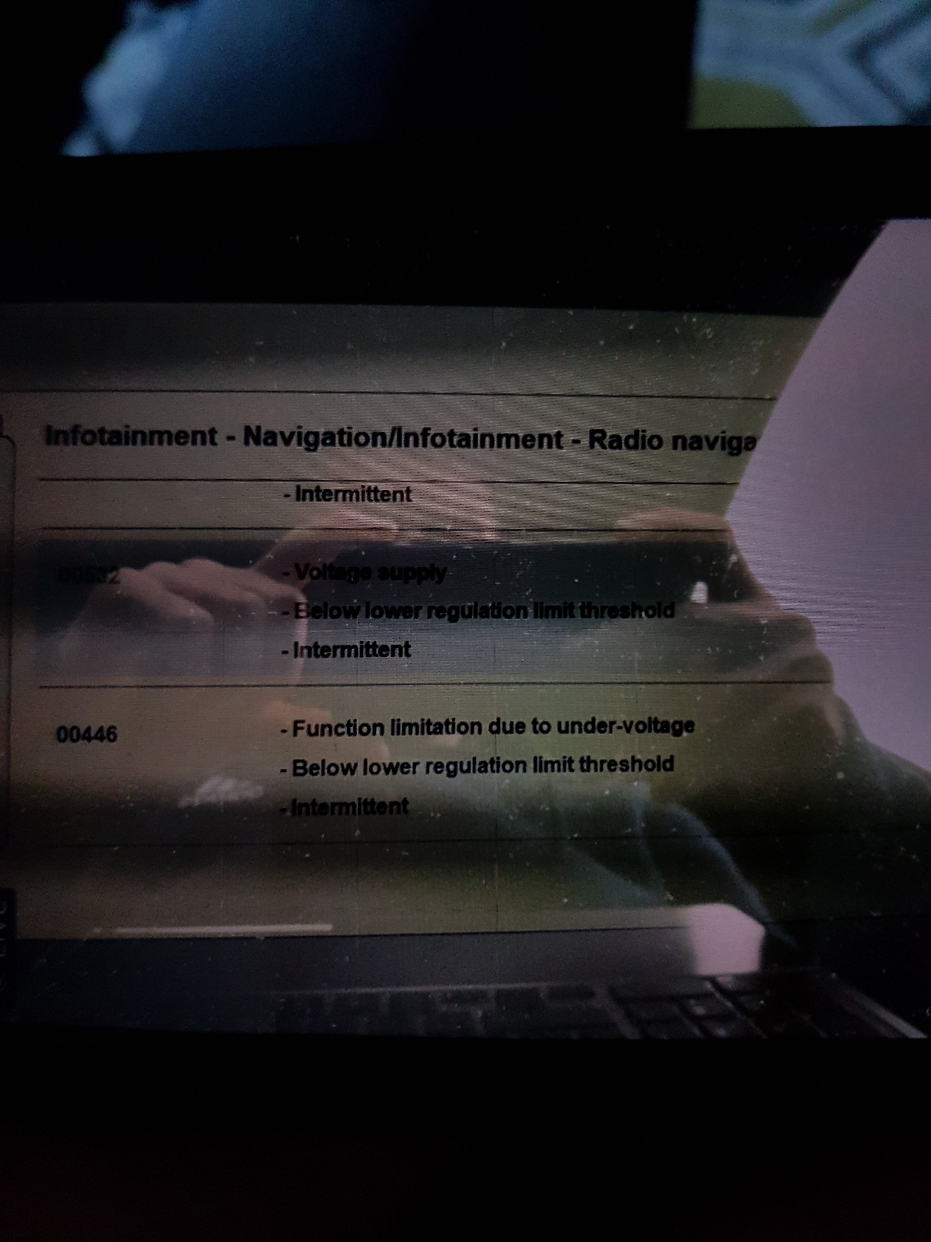

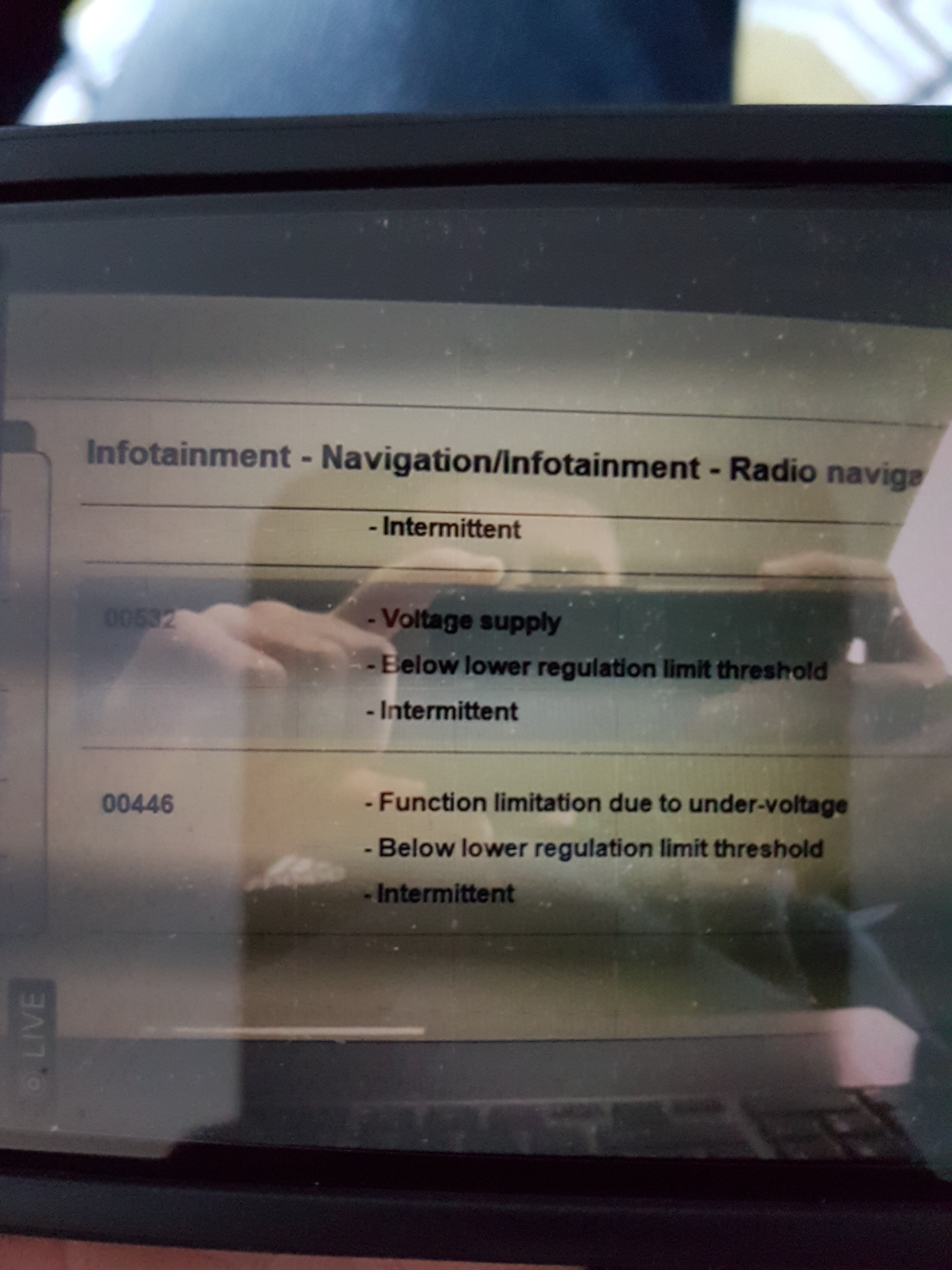

Hi All, has anybody any dealings with their colombus unit not powering up at no time in particular under no certain conditions? I have the audio from reverse sensors and have checked battery voltage before starting car and while engine is running. I scanned with Delphi software and got intermittent faults relating to undervoltage.

However, having said all that, have ypou investigated the battery low voltage issue that the numerous faults are showing on your pictures? It might just be that you have a flat battery and a new battery will solve the problem. Given that you have a load of low voltage faults, maybe address those first with a new battery and see what occurs?
