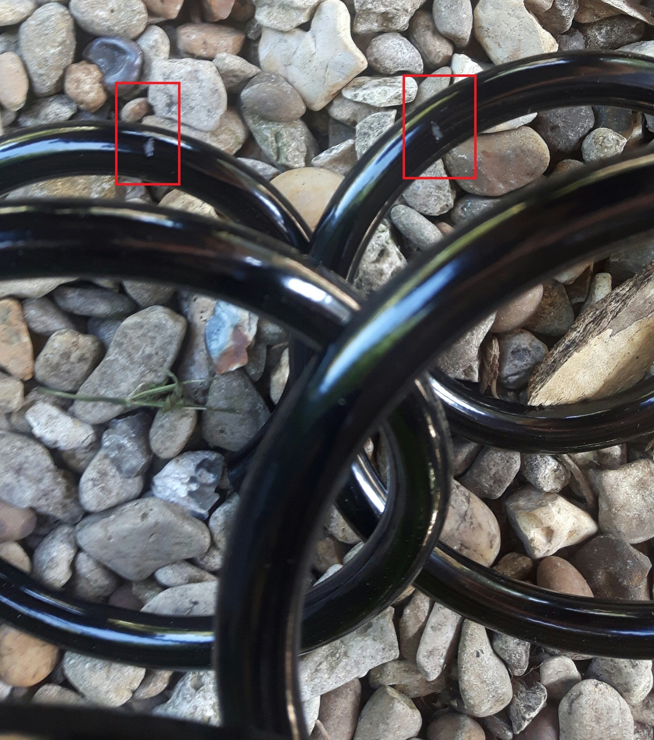

First the springs :- I'm not sure whether they are painted or powder coated, but there are marks from where they were hung up while getting coated/painted, which leaves a couple of spots on each spring that are virtually bare metal.  A couple of dabs of paint x a couple of coats and you've eliminated a built-in corrosion starting point.  Note that my photo only shows one patch per spring, but there's another on the inner side of the coil about 90° round from those.

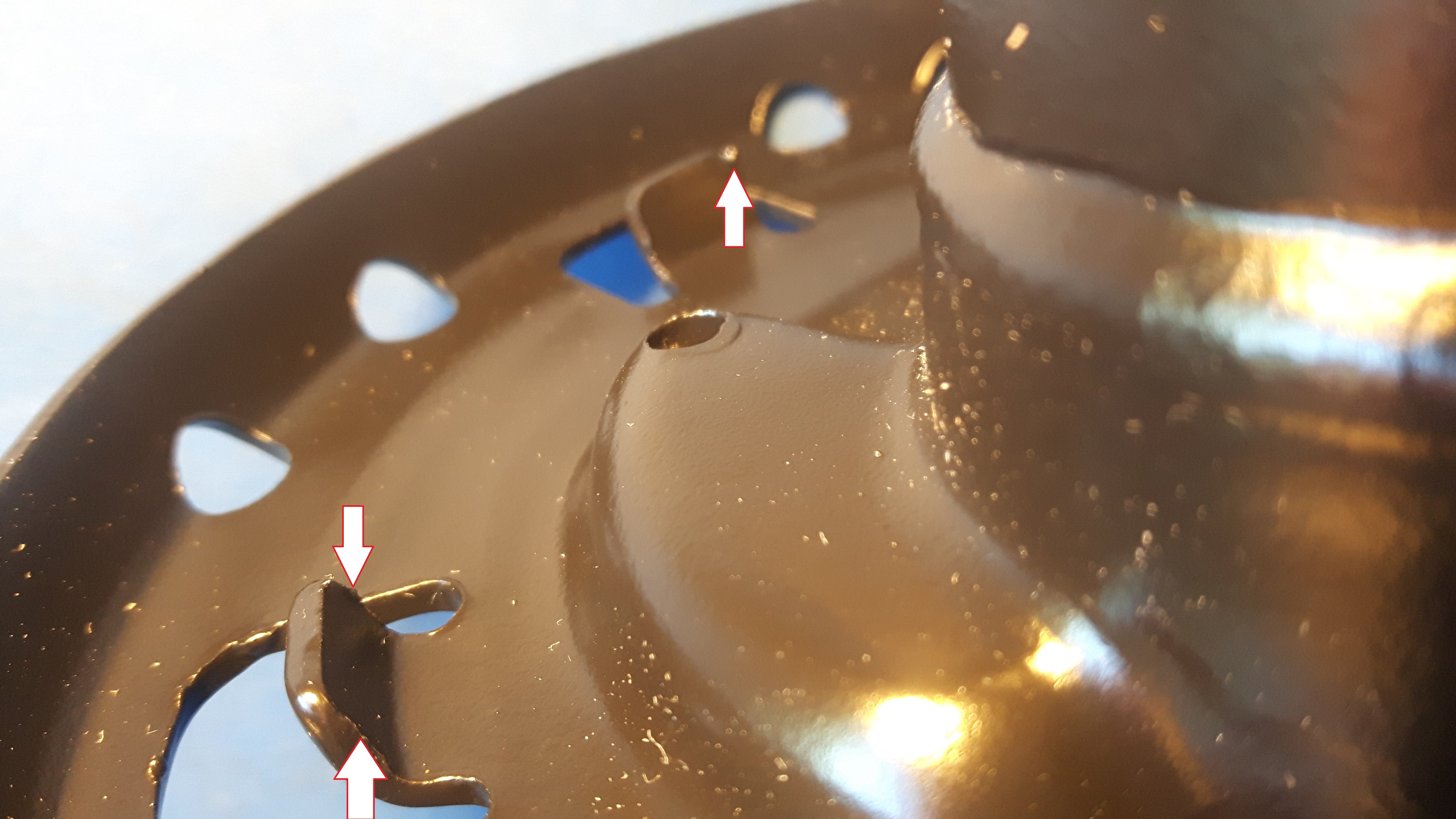

On the shocks, there are some tabs that are stamped out of the bottom seat and bent upwards to locate the bottom coil of the springs.  Both tabs on both shocks had nasty sticky-outy burrs from the stamping process that looked sufficient to bite through the paint on the spring as soon as it is installed. Fettle smooth and repaint carefully.
Apologies for the focus of the photo, which failed to show the worst burr on the far tab, with any clarity whatsoever.  That was the one that first caught my attention.
Check the areas just inboard of these tabs, where the bottom face of the lowest coil will rest too, there were also small burrs there on these. De-burr and repaint.  Don't skimp on the repainting or you'll just change the start of the corrosion from being on the spring to being at these spots where you've gone back to bare metal by deburring.
