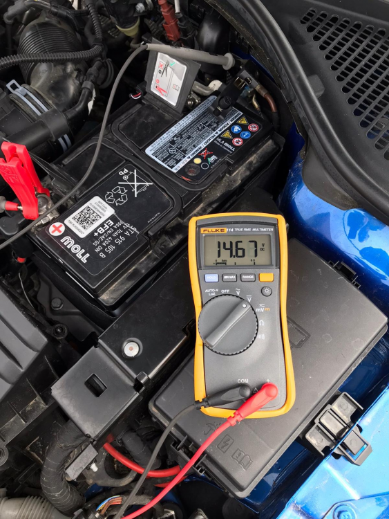

Tried jump starting etc. Left the battery on charge for while and got it running. But never got more then about 12V whilst idling.
RAC came out to inspect it and couldn't tell me what's wrong.
Left the battery on charge overnight, installed back in the car and started up ok, no errors on dash.
Drove for 90 miles (non stop). Arrived and measured again only just over 12V on the battery (whilst idle).

No, ticking over on the drive, you'll get around 13.7v.
It's when you're slowing down in gear when you'll see 14.5v ish. The energy recuperation system kicks in.

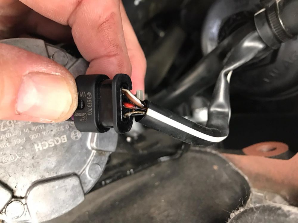

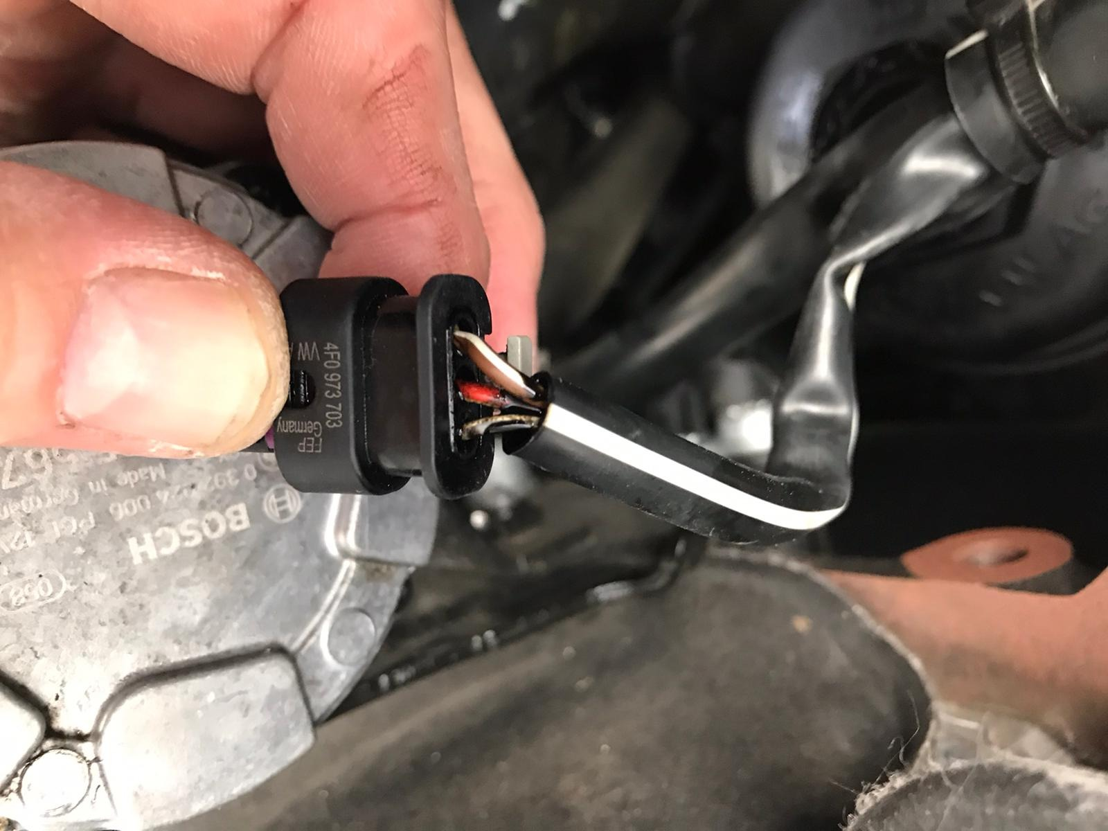

Looks like the problem is solved. Looks like oil dropped on the connector when changing the filter, prob causing a short and high resitance. Stripped and cleaned the connector and the battery is getting charged again at 14V. Dropped back down to 12V after a while, but when putting load on (heated seats, AC, lights etc) it shot back up to 14V.
Seems to be ok again.
So lesson learned, be carefull when draining the oil filter!!
