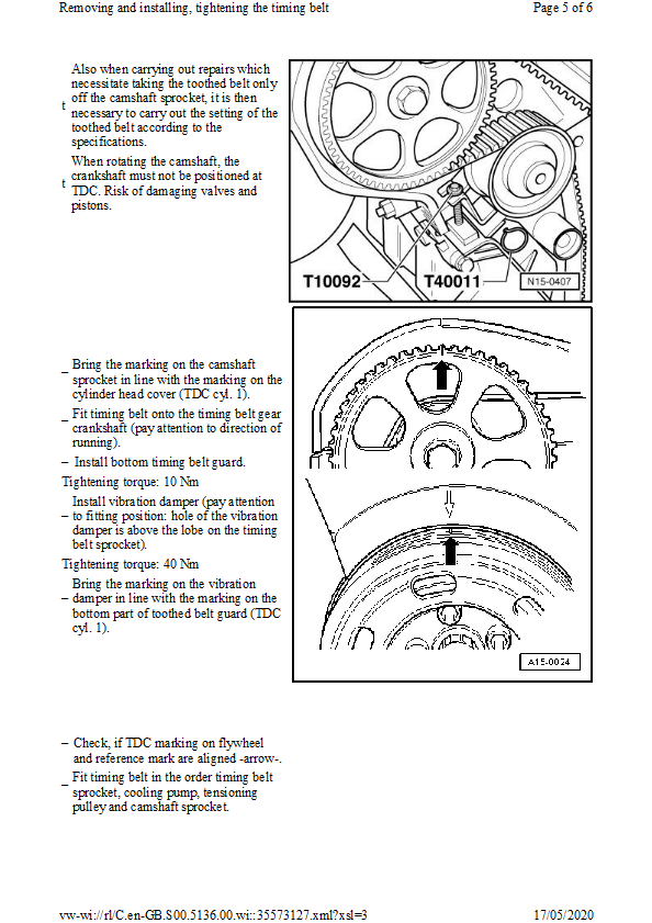

IIRC there are no locking tools for the crank or cam on the 1.8 20v engine so pay attention when you are installing the new timing belt
Thank you 👍

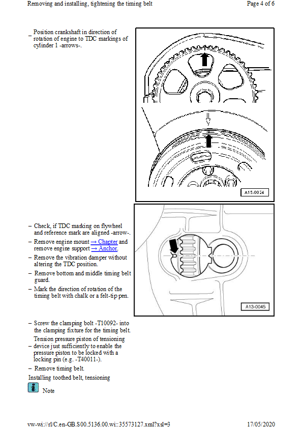

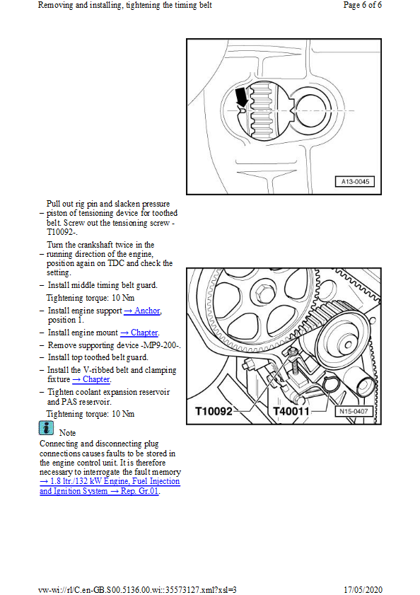

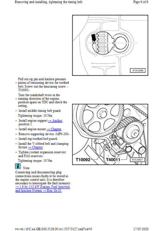

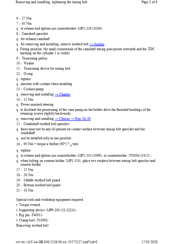

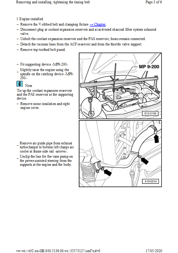

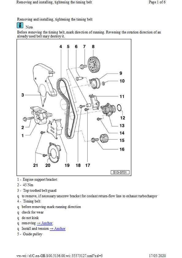

Only awkward bit is the top engine mount, the engine support part of the mount won't come out, but you can manoeuvre  the new belt carefully past it by taking the bolts out of the mount and raising and lowering the block on jack with the load spread on a piece of timber on the sump. The stuff below should fill in the gaps.
That's great, thank you 👍
