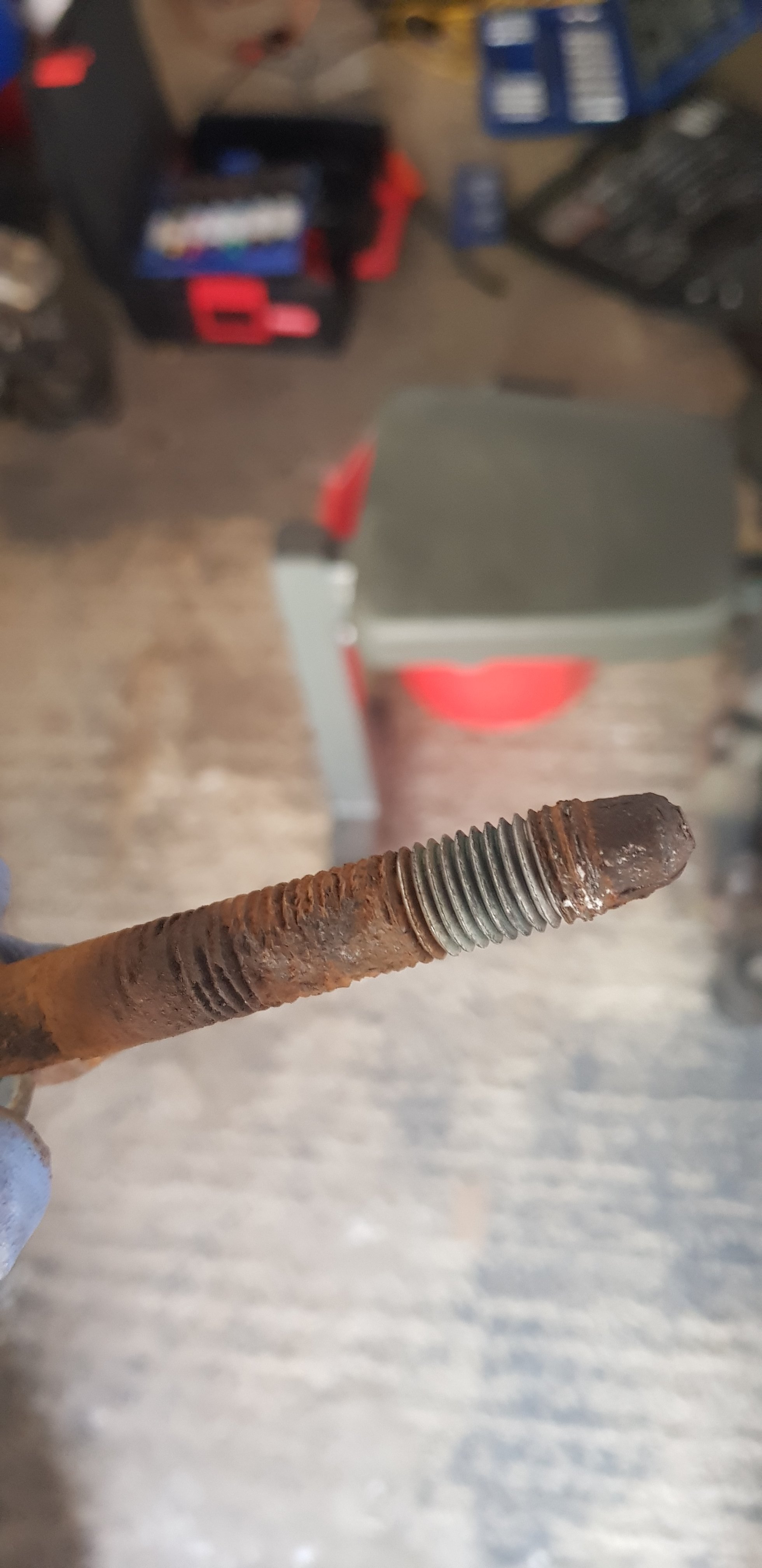

Thanks. This cad appears to have been parked in a harbour previously. Chassis is fine but suspension components are rotten. Both hub slime bolts rounded and one currently seized in the hub, both torx recess in the track rod ends have rounded too. Looks like the TRE's will have to be cut off and replaced, about to try some heat on the hub bolt.
Where can I get new hub bolts from anyone know?
33 minutes ago, TMB said:
Hub pinch bolt is part number N 90954801
Available from Skoda/VW/SEAT dealer or maybe ebay. Example...
https://www.ebay.co.uk/itm/2x-Screw-Kit-suspension-strut-wheel-bearing-housing-N90954801-For-AUDI-A1-Hat/174243463597?hash=item2891b841ad:g:~EMAAOSwETBeYQ7~
Just cut the nuts off the track rod ends and use a track rod end seperator.
Thanks very much, ordered the bolts. Ball joints are split but nuts still on and torx rounded so I'll just cut and replace. Awaiting blow torch to get remaining pinch bolt out. Love it when things go to plan!
