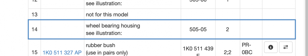

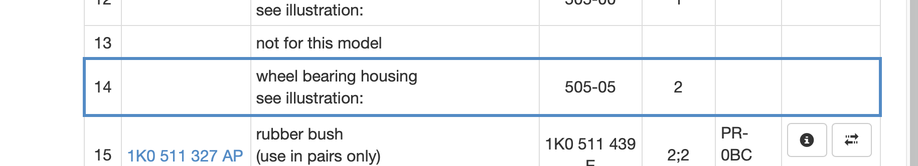

Part  numbers where it says "see illustration...." are shown on a different page. In this case here https://skoda.7zap.com/en/cz/octavia/oct/2005-419/5/505-505005/
See how the last bit of that link looks like the numbers given in the "see illustration..."?
