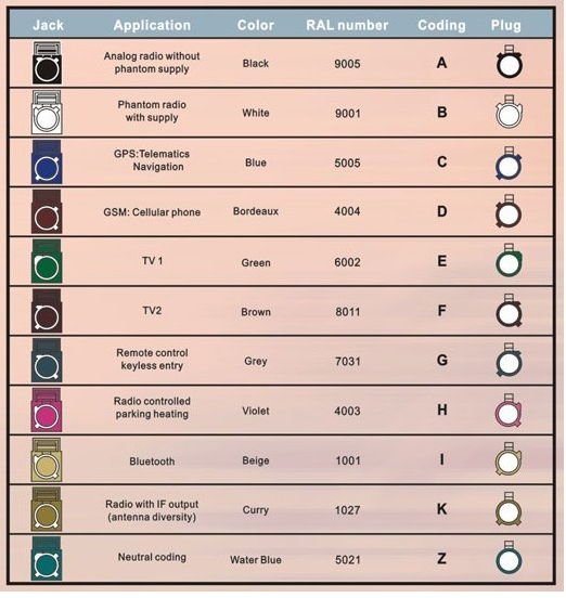

I have attached a list of Fakra connectors. Check which one you need.
The description for that splitter (Google translation works for Norwegian if anyone is interested) says I might need a "8551 Phantom infeed (to feed 12v to an amplifier I think)  https://acb.no/Details.asp?ProductID=3491
But he also said they this car probably have no amplifier since the antenna are a roof mounted one.
