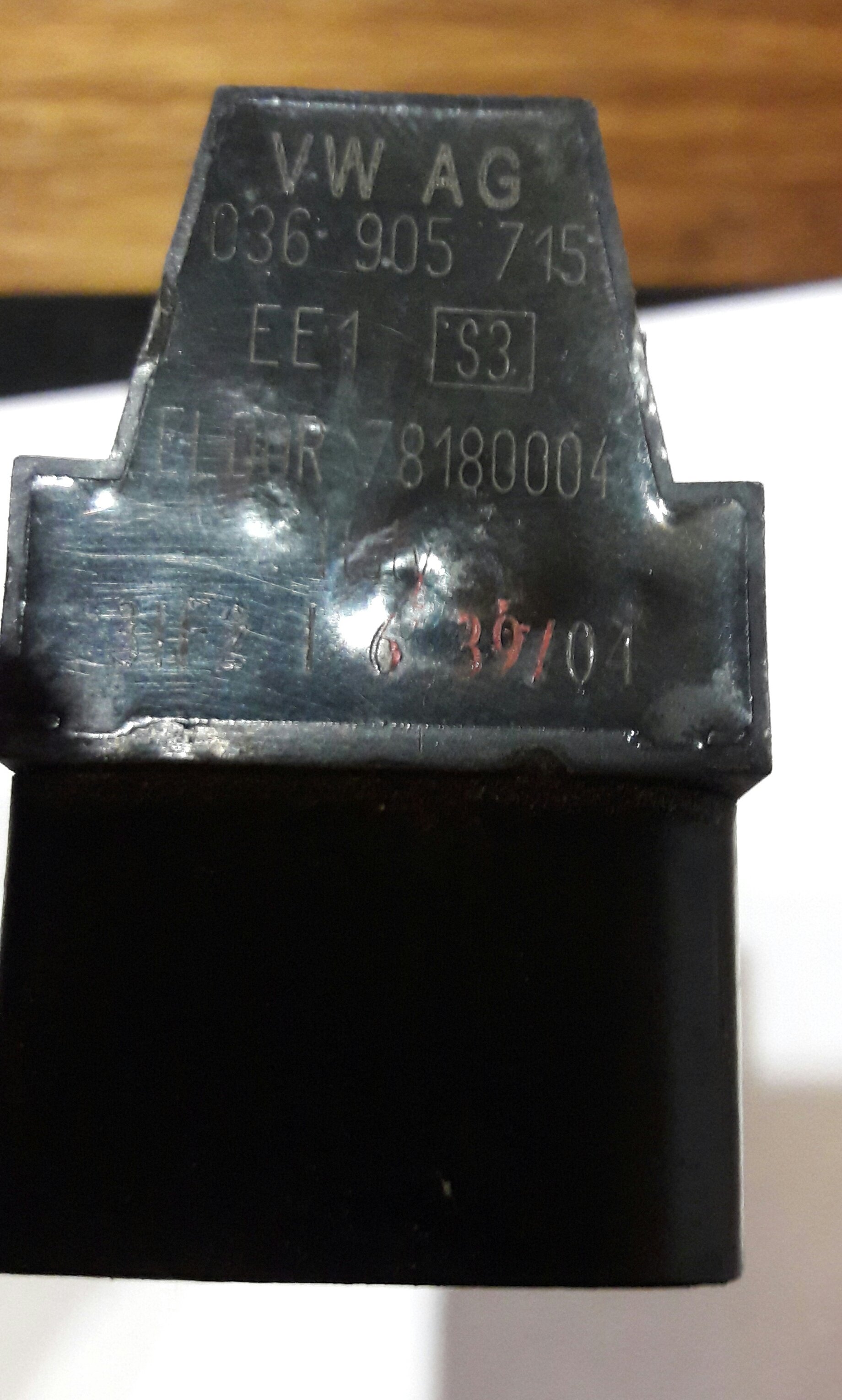

You might be able to spot the failure visually if you remove the engine cover and have a close look at the top of each coilpack.  When one failed on our Fabia, the top of it blistered visibly, but I know this doesn't always happen.  Free to have a look though.
See the volcano-like bulge just left of where 39/04 is printed?

Thanks Wino, took it in to a garage I've used before. Good couple of fellas who run it, it was misfiring on cylinder 3, so changed coil pack and its lovely. They had the coil pack lying around from when they changed the engine in their own fabia, so the never charged me, I just gave them a couple of quid for their trouble.
