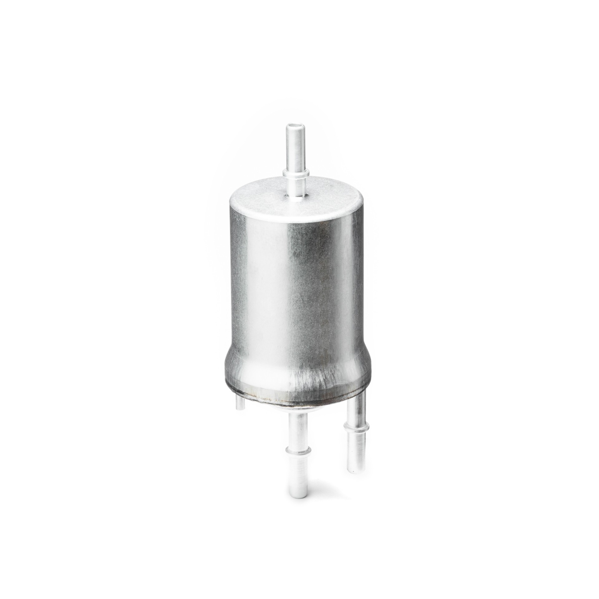

In line fuel filter - OE number from VW part on car 1K0201051M. Can anyone tell me what its function is? Is it a filter or a regulator.
Fuel filter - UFI (31.845.00) buy cheap online
Can't find any reference to it needing to be changed as part of routine service
There are 2 inlets, one is blanked off and one outlet.
Taken it off and stuck my lips around the ports (yuk)
The port that is blanked off has no resistance when blowing through it.
You can't blow through the port that is connected to the tank.
